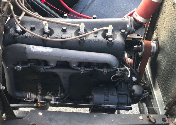

Anyone know anything about this Texas T alternator, or maybe it's a generator I don't know? It's not hooked up and I don't know if it works, I'm guessing it's 12 volts? Does running the truck without a battery cause harm to the alternator?

The best thing is to call Birdhaven. They will know. Somehow when my dad was messing with it he lost a wire that carries the charge to the battery and didn’t know that it had a diode in the wire and wouldn’t charge very well. Birdhaven helped me sort it out, this was one of the earlier alternators. Works great now.

I don't think it did any harm to the alternator. I have one on the 1926 touring for 12 years (from before I knew to work on T's). Once the wire broke and I didn't see it. We went home for over 60 miles with the broken wire. At home I just reconect the wire and the alternator is still working, this was 8 years ago.
Normaly an alternator need current to make current. With a broken wire the alternator will not make any current and will not burn it self as the three brush gererator does.

If you are running on mag the engine will run without a battery. Since the alternator does not put out at idle, running on Batt will not work without a battery. If you do not have a battery I would suggest having some kind of load on the alternator, for instance burning the lights.

No mag, this one has a True Fire ignition and I'm running it off of (don't laugh) two 6 volt lantern dry cell batteries. I have not idea why it was changed but it's the way it came when I got it.
