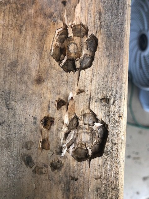

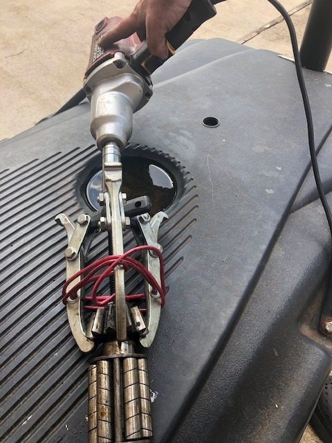

The goal was to take a 11 tooth pinion gear off one assembled drive shaft and tube and put it on another drive shaft that was disassembled. The other was a standard 10 tooth pinion. I used a 3 jaw puller and a impact to take off the standard 10 tooth un-assembled. The basketball goal base it is resting on is optional.
The second one I used the Steve Jelf and others bang it on a piece of wood method. See picture forensic. There are 3 impressions in the wood. Impression 1 is the greasy nut resting on the wood before banging. Impression 2 is the first hard bang on the piece of wood with the pinion gear staying put. Impression 3 in the middle is the second bang on the piece of wood with the pinion gear impressions showing that it has now come loose. Ta da!
