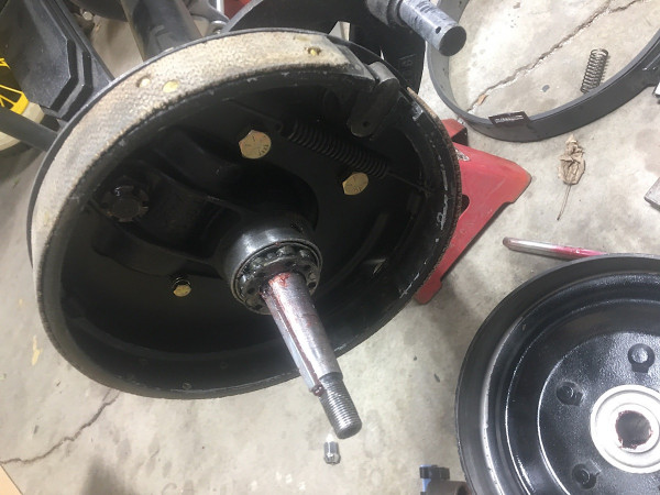

I started out worried whether he had adequately set the backlash on the rear differential correctly. Additionally, I worry by the parts that are left over in the bag. So I took off a rear drum and this is what I found.
I also took a quick measurement on the magneto gap and found gap from .010-.065. I attempted to turn the engine over but couldn’t. So obviously, i have to take several steps backward before I can move forward.

That rear bearing should not stick out like that. Something is not correct. Hopefully it has nothing to do with the differential.

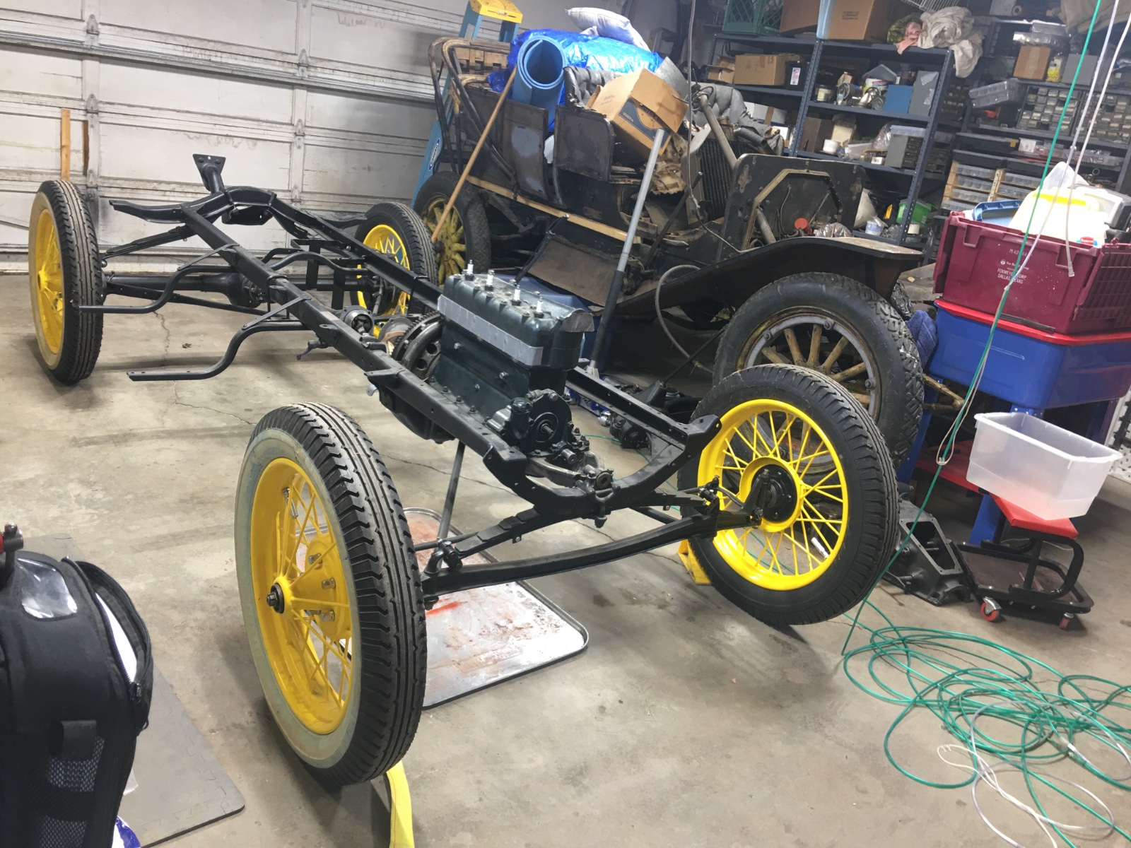

Frame looks good. Wheels look great. Do you have hubcaps? They are in short supply.
You need the service manual, engine book, and transmission book. Then you are on your way to getting this all corrected.
