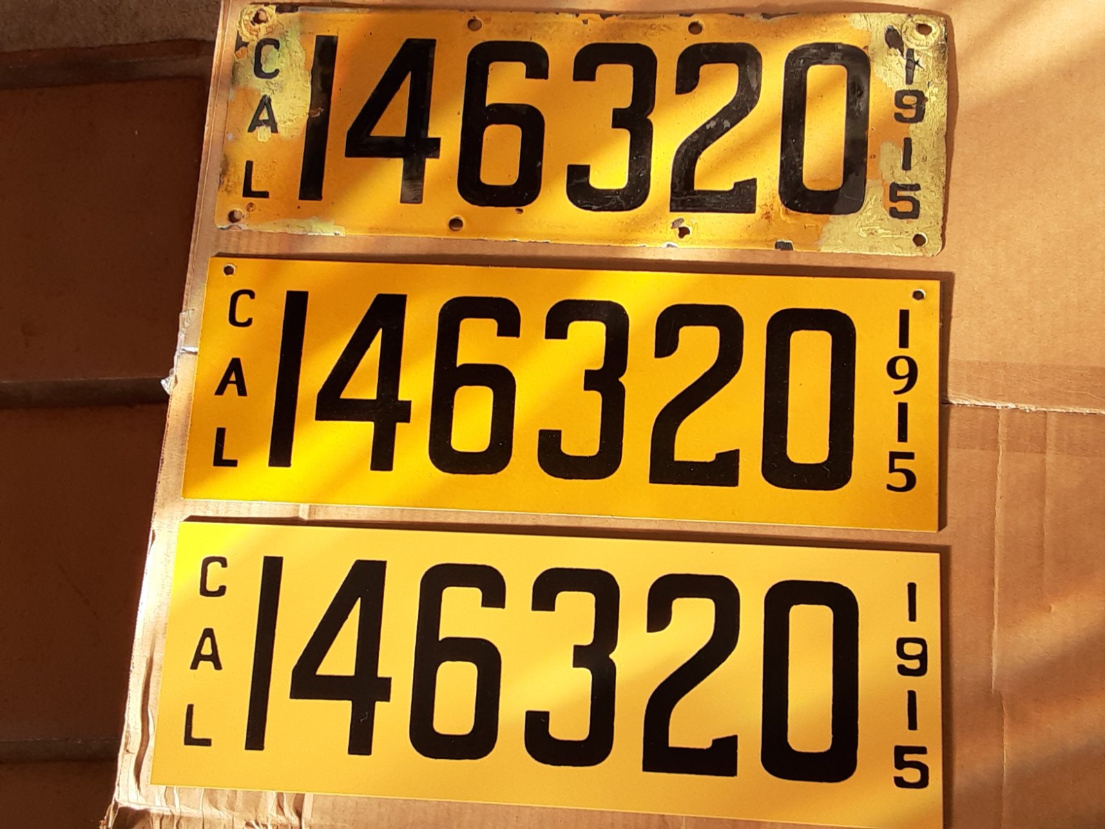

Here is the plate for my car I made about a year ago. The top is the original, the middle is printed on paper then glued on steel testing to see if it would look correct. The 5 wasn't quite correct. The last one is ink on steel. These are not street legal, but they do look nice. I also made a 1915 brass registration dash tag using the license plate number. With such good luck on the dash tag, I'm trying to make the center discs of the 1915 high F hub caps then I will attempt to solder them into repro hub caps.

Re: Reproduced my 1915 California license plates. What do you think? ...Picture.
The fonts are wrong on the center one but the bottom one looks good!
Good eye spotting the wrong fonts. I took a best guess at the fonts when I made the center plate. It took several printings on paper to get the background yellow correct. I found a 15 plate and saw the font differences and corrected them before printing them on steel. The fonts on the lower plate are exactly what was on 15 plates. Using photoshop I manipulated the fonts to get them lined up correctly then off to the sign shop to print a set of plates. Ing-Rich is the Ingram-Richardson manufacturing co. in Pennsylvania The 14 plates were thicker than the 15 plates and I've found them in excellent condition.
