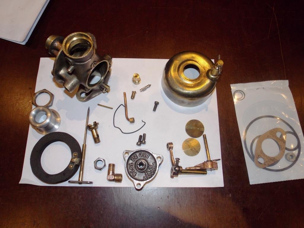

A few years ago I bought a reconditioned Holley G at a swap meet. I decided to put it on my T and run it in place of the usual NH that I normally use. The car started and ran nicely, although I didn't drive it. The next day, I went to start the car, and fuel started dripping from the nut on the bottom of the carb. I removed the bowl, and found that silicone had been used inside the bowl to seal it around the thread, and the silicone had softened and was melting away. My question is, what is used to seal the bowl around that rather large hole? Thanks, Nevin Gough, New Zealand.

silicone is not the right stuff to use when rebuilding a carburetor. What you need are the right gaskets and parts.
What looks great on the outside isn't always right on the inside.
What you need to rebuild your carburetor are in the photo.
you can do the rebuild yourself but do not use silicone.
Good luck
Andre
Belgium

Thanks Rich! Thanks Andre. I'll order a couple of gasket sets from Langs.
