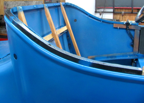

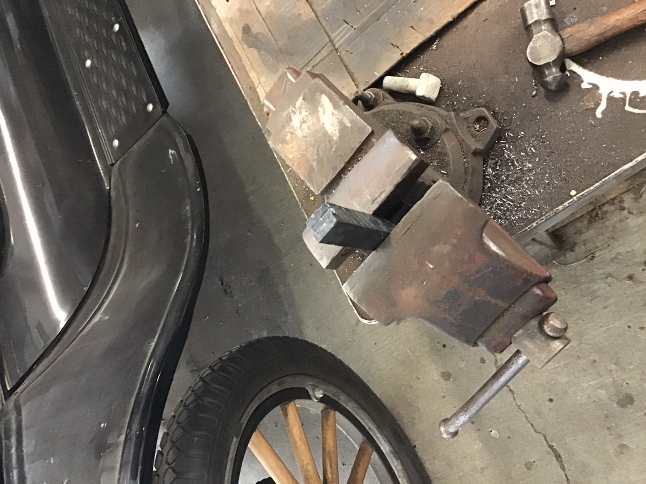

I used the Fordwood tack strips on my 21 Touring rebuild around 5 years ago. Went back to the shop in my left over wood parts box and had the cut off tack strips left overs. They were in a box in my garage that the temp. Range is from 30 to 120 degrees Fahrenheit. Texas weather. As you can see in the pic I put a piece in my vise and took several licks with a hammer. No breaking this stuff and not brittle. This is my experience with the Fordwood tack strip after 5 years.

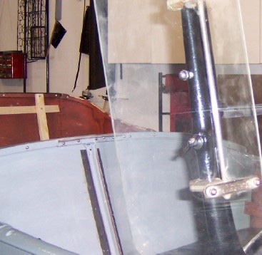

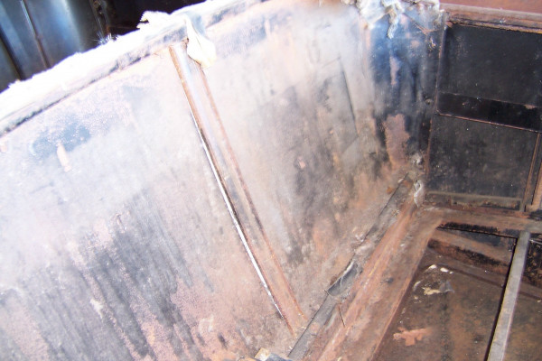

Once the plastic strips are moulded to the body panel shape, how flexible are they if taken off? On my 1915 body, there was a strip either side of the seat back panels to make the panels rigid. These timbers were more than tack strips, they were structural. The only 'stiffener' in the 15 body was the rolled in bead. If that is all there is in other bodies, then the strips need to be more than just tack strips. then they need to be stiff, like timber.
- Posts: 7139
Re: My experience with plastic tack strips
Dan's post re fitting the plastic strips to an improved car body shows the body panels are formed with a considerable step at the top of the panel. This will make for a far more rigid panel, and a plastic tack strip may suffice. That said, a recent rebuild of a 26 tourer here revealed the front seat backrest panel cracked at both ends due to flexing in that panel, and the repair was backed up with laminated plywood strips. Dan's roadster back panel may not ever have flexed as much as the same panel in a tourer.

- Posts: 7139
Dan, the cracks in the back panel were at the ends where the panel meets the body side. Ford began manufacturing in the new Geelong plant in 1926. For your reference, Australian built 26-7 models had a complete wooden sub frame and considerably more timber in the body than those built in the USA. My guess is they stuck with technology with which they were familiar, rather than bring all the extra tooling/machinery to make all steel bodies, with an eye to the introduction of a T replacement in the near future.

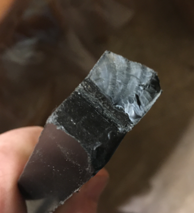

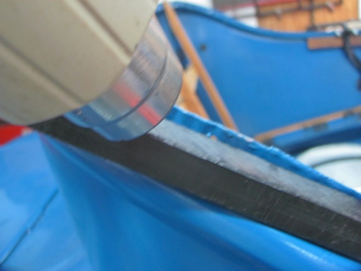

I've had the grandkids staying with me for a little over a month and I let this topic go into the bowels of the Forum. Here is the photo of a broken piece.
First, I have looked all over my shop for the rest of the broken pieces and I am concluding they are now in a landfill. What I did find is one half piece which displays a crack. The pieces cracked at the corner bend and at screw holes. This piece cracked where I had it lapped in the back of the seat. It is no longer bent to 90 degrees and has relaxed while sitting on the bench.
I am guessing some wil comment that by lapping the two pieces, I set up a stress riser. But it also cracked at the necessary screw holes as well as at the corner where it was bent with a heat gun.
As evidence of the thoroughness of my search for the pices, I asked my grandson with better eyes to help me search. He left no stone unturned.
Tom Miller

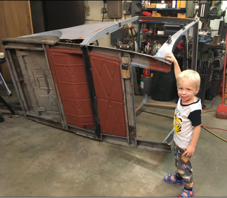

Your grandson must be from Krypton. He rolled that body with one arm.

Tom,
Looking at your photo of the "broken end" what I see doesn't look much like the cut end of the material I used. It looks more like plastic. I wonder if we're talking about the same material? I have a test piece I cut and bent to learn how to mold the material that I'm going to hang up and see what it looks like over time. I'll let you know what I find in a year or so
