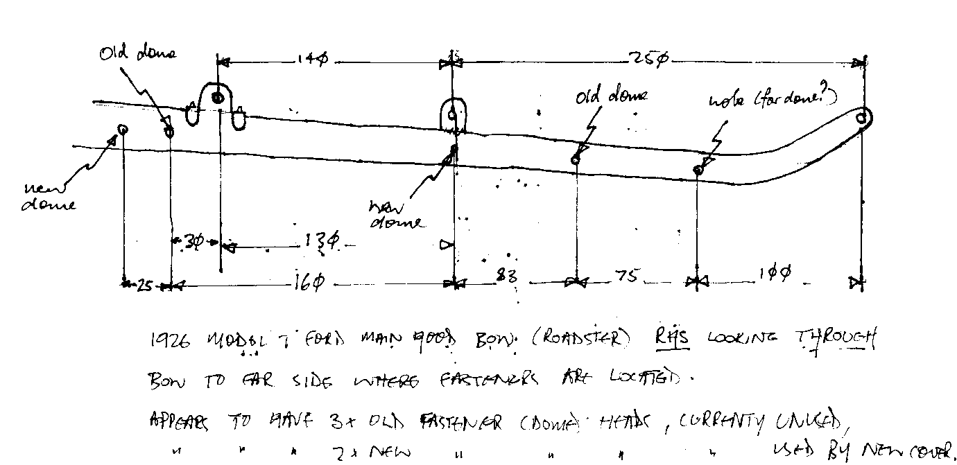

Short version: Can someone please provide me with the dimensional location of the sockets on the main bow? These are the ones that attach the sail panel and side curtains.

Re: Measurement Request - '26 Roadster Top
Tom,
See the drawing below. Is this what you were looking for?
I hope it's clear enough - unfortunately I was struggling with low light due to some faulty fluro tubes so the sketch isn't as good as it could be (and it just 'grew' rather organically).
With my car I discovered that there appeared to be 3 original dome fasteners (one of which was just a small hole where I guess a rivet/screw would have gone through), and two new ones - the latter fitting the new top that's on the car. I've differentiated these in the drawing.
To be clear; the dimensions are in mm, and the drawing is looking from the outside of the RHS bow through to the fasteners on the inside. I hope that makes sense? Please let me know if there's anything else you need, now I've got the hood partly up it's not too hard to take some more measurements.
Also, I will try and improve the light in order to have a better look tomorrow, or the weekend and will update if I find any anomalies - the old adage "measure twice, cut once" springs to mind!

Tom, in case you are not familiar with converting mm to inches...
Inches = mm/25.4
For example, the 250mm dimension in Luke's drawing would be 9 27/32 inches.

Luke,
Thank you! That’s exactly what I need. Thanks for including the reference dimensions back to the mounts.
I appreciate you making the journey to measure your car.
Mark, thanks for the 25.4 reminder. I still have my metric scales from the Ford ERIKA project and speak millimeter fairly well.
