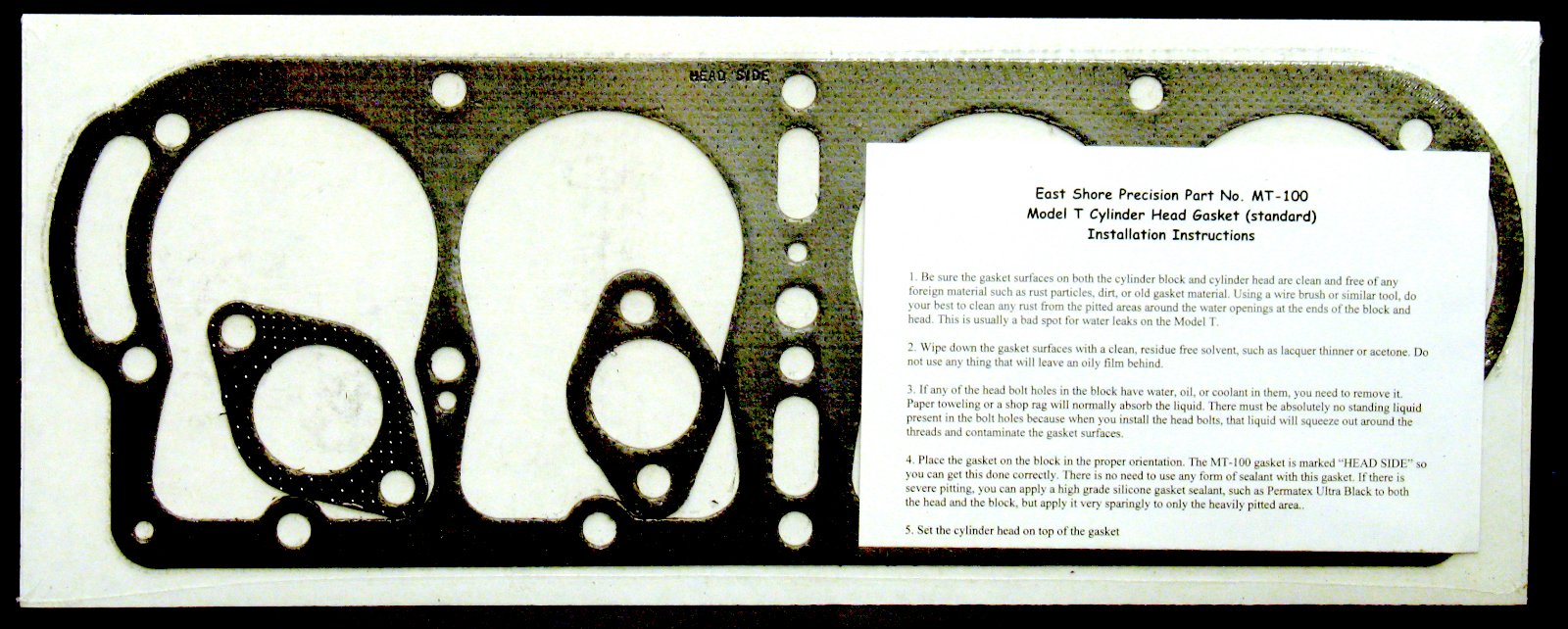

Post by Steve Jelf » Tue Aug 11, 2020 11:09 am
Adam Doleshal uses this gasket and says it's superior, so I'm going to give it a try. It also costs a little less than copper.

Post by John.Zibell » Thu Aug 13, 2020 11:33 am
Steve, where can you get these? I look at a couple vendor sites and it isn't listed. Also searched on the name and part number and came up empty.
1926 Tudor
Posts: 7392
Re: Head Gasket Failures
Post by Steve Jelf » Thu Aug 13, 2020 12:08 pm
You can get them from Adam.
