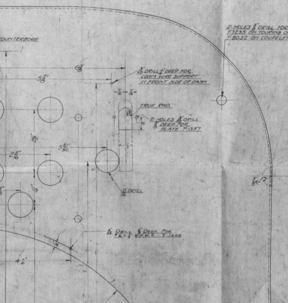

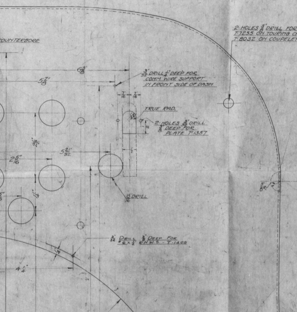

- Posts: 4046
Re: Hole spacing for coil box insulators
Only have this partial print, 1917 firewall. Shows at least the hole space distance between a pair, might help. This was posted on the forum a while back.
Topic author - Posts: 1205
- First Name: Adrian
- Last Name: Whiteman
Thanks guys, i laid a box wood back on the firewall and went from there. Worked ok but my niggly back of mind says 'it might be wrong'
