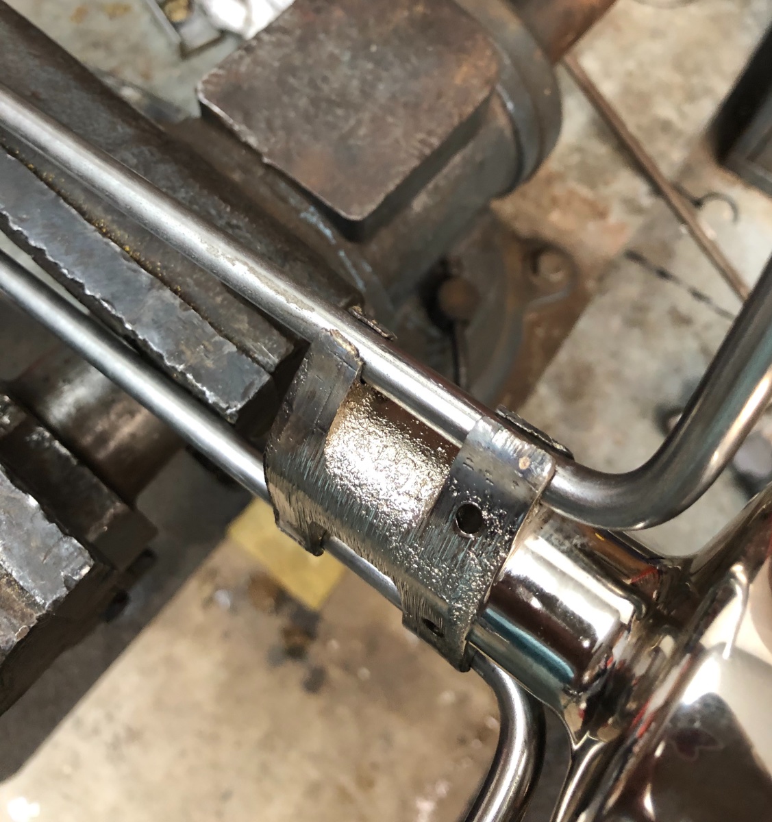

Just did that task 2 weeks ago. Thought that propane would heat enough, nope. needed to get red with the acetylene torch.
This case prior to nickel plating, had the rods removed by cutting them off and sliding thru the tabs. So the tabs were closed like factory fitted, and plated over.
To open the tabs back up, heated each one to just dull red, and gently pried them apart just enough to so the new rod would fit.
If you look close you can see the discolored nickel where the heat was applied to the tabs. Just softly hammered close with the ball pein.
In goes the fresh nickel plated case with new s.s. rods ......

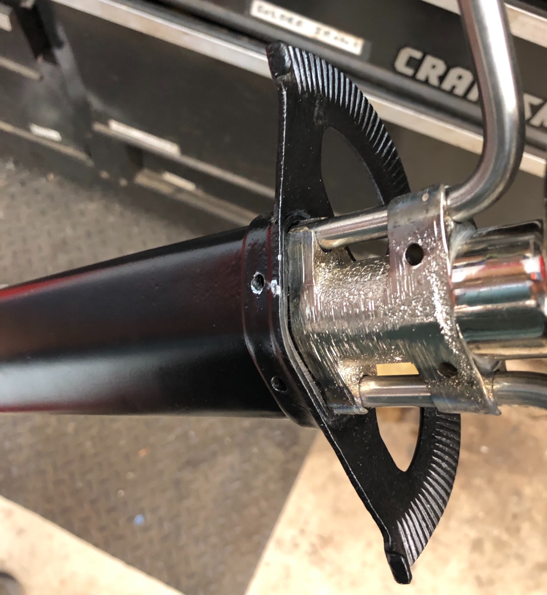

Well, without heat most times some of the ear breaks off.
Then the hold on the rod could be compromised. One can duplicate factory with some heat and prevent the tapered tips of the ears from cracking off
Note the upper ear on the left side, that ear cracked off when removing the rod without heat. The other one a bit too, so it doesn't look as good as a repair using heat first.. There was enough of the base of the ear to fit tight into the steering column, many times that is just enough. Sometimes not and the rod will wiggle on this upper end.

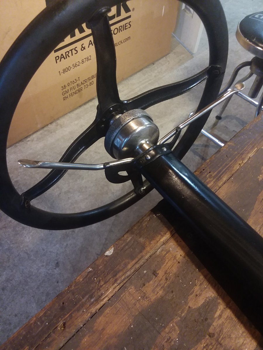

I got it back together; thanks!

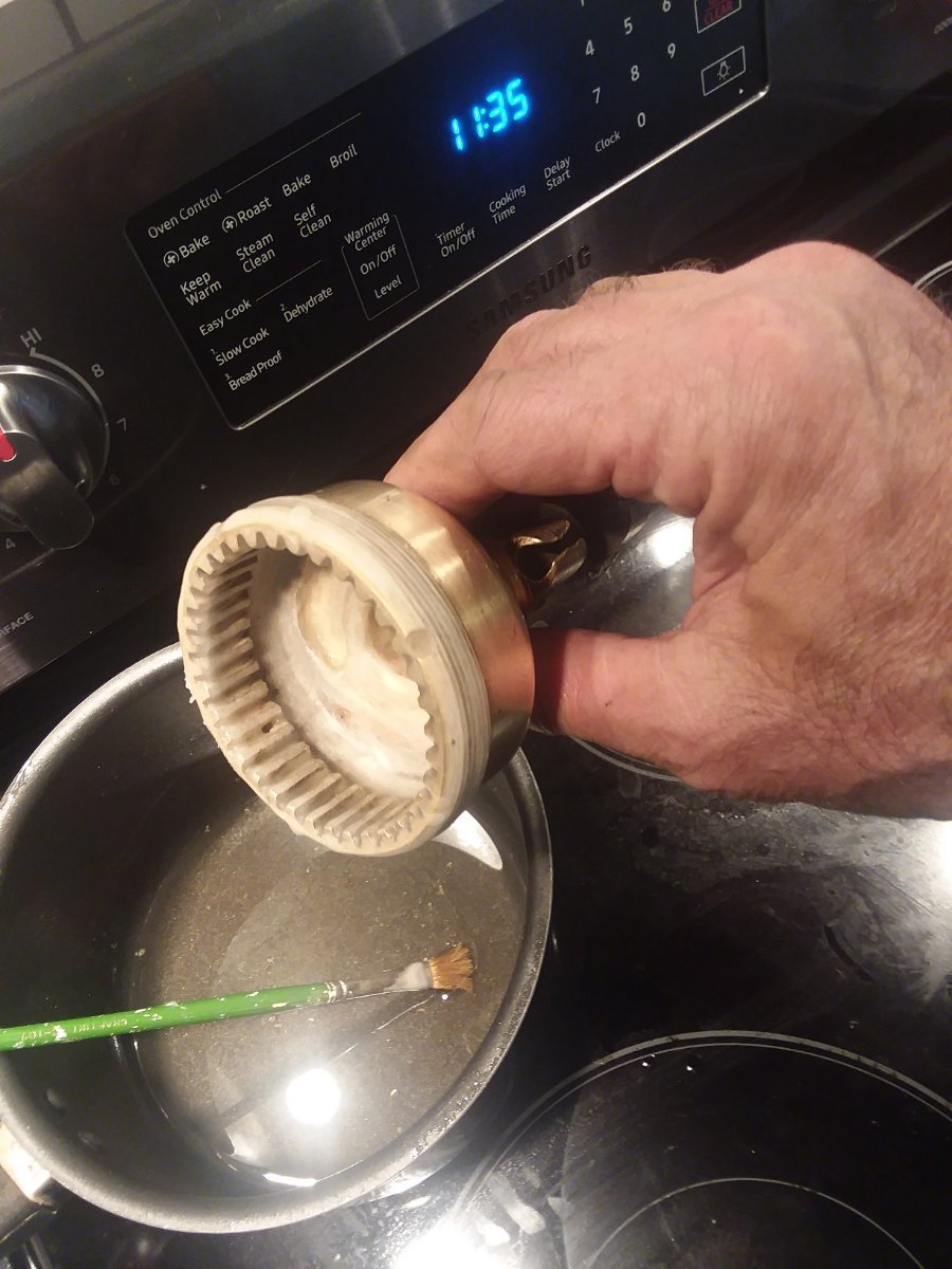

I did a little YouTube plating while it was apart. All you need is vinegar, salt, some nickel and a phone charger.
I masked the sanded (most of) the pits out, masked the threads with some paraffin, and plugged it in. I'm pleased with the results, for a twenty dollar investment.

https://m.youtube.com/watch?v=G-PtnwtOR24
Dave,
Sorry for the wait. Here's the link. I got the source nickel on ebay because it was easy.
R/ Roger.
