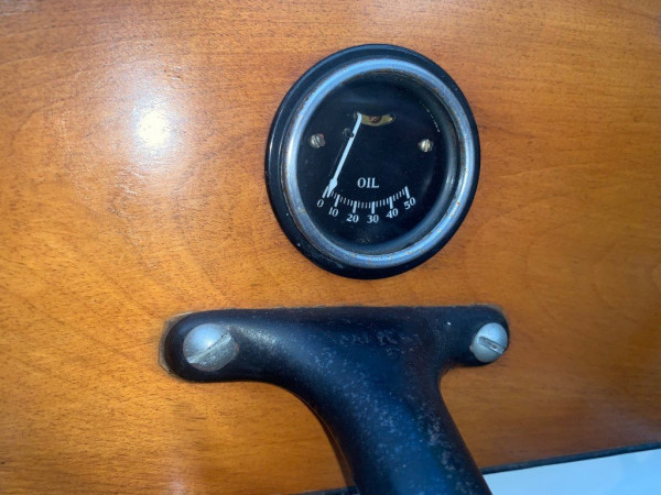

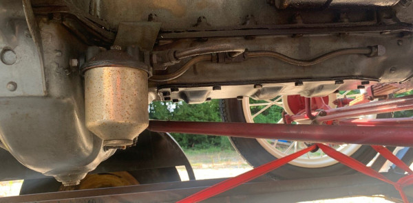

Recently acquired a Model T Speedster. It has an aftermarket oil pressure system. Don't have a clue about the Builder.
I started it and zero oil pressure to the gauge. Oil is as supposed to be, upper petcock. The pump and filter are above the Model T "sump" could it needed to be primed?
Bill

Added note I primed the oil pump from the suction side. Your picture shows the pressure side you may have to remove the hogshead and check things out.

Drained the oil. Then pulled the filter (There is a bolt on top that drops the filter housing). It was seriously clogged with crud. Cleaned the housing inside and out. Filled the housing with fresh oil, then added fresh oil Non-Detergent to the engine.
Pulled one of the oil lines that feed the engine mains. Used a hand pump and pumped in fresh oil to prime the pump. Not sure what is supposed to prime the pump, but this worked fine.
Took the oil line going to the gauge and blew through it with my air hose. Gauge worked fine.
Put everything back together, fired it up and HAVE OIL PRESSURE! It was so sweet to see the needle peg!

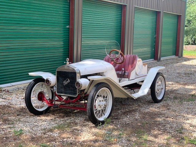

Gas leaks in both Carbs. Press fit for the short straight bronze tubes that connect the fittings. Both of these tubes were leaking. I cleaned the tubes and the holes they fit. Roughed them up and used JB Weld. Works fine!
Carburetors (Solex) running a little lean. I think I need richer jets. Gotta figure this out.
I am really feeling my way and hope I am getting it done right! It seems obvious that someone put a lot of love, effort and money to build this car. Then, I think, that some backyard mechanics had their input. I have worked on my other Model Ts and nothing like this one. There has been one riddle after another.
Nickname for the car? "The Riddler!"
