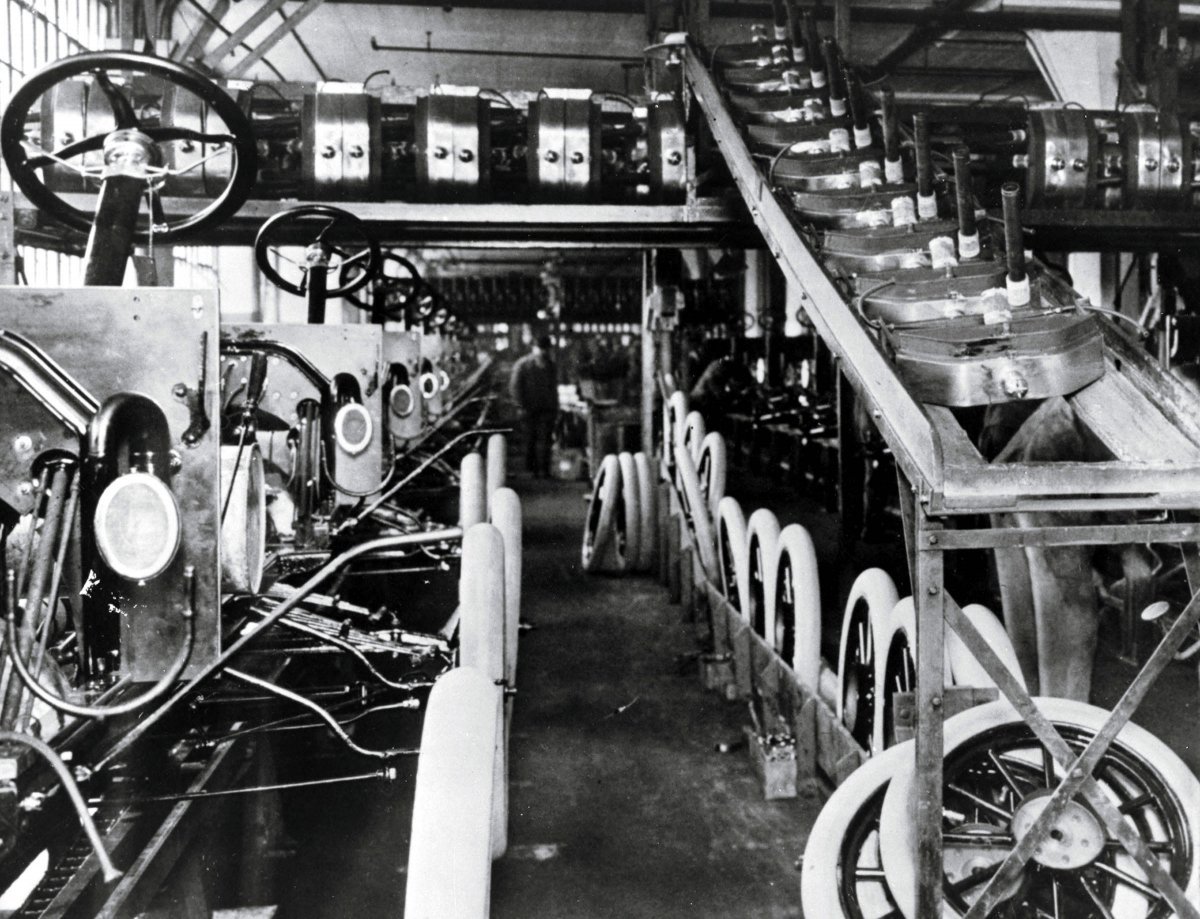

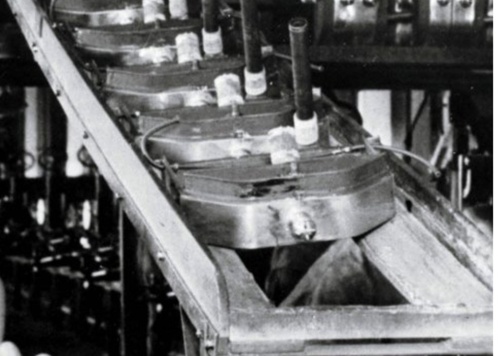

Below are radiators on the assembly line 1913/14. You can see the small clamps if you look carefully.
I can't see the short 5-6" hose to the rear gas line since it would go straight down,
but all hoses attached to the radiator are in place prior to sliding down to the assembly line.

Bottom pic is definitely a line up of '13s, based on the spade mount for the Carriage lamps. Also answers any questions/doubts as to exactly how the horn should be: Black! with brass screen, and of course the bell mounted "down". Nice pic!

Would the moving line the cars are on date them?? Bud.

I agree with you on the red for the acetylene gas hose.
If you look at the last photo I posted, the gas line hoses appear
much like the radiator hoses which are red.
Certainly not cream, or white, like the tires in that photo.
