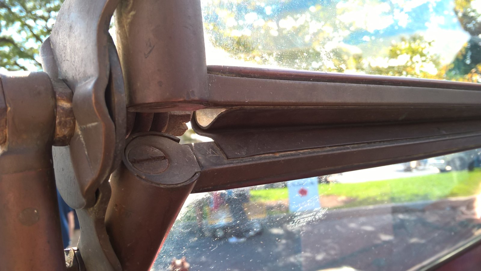

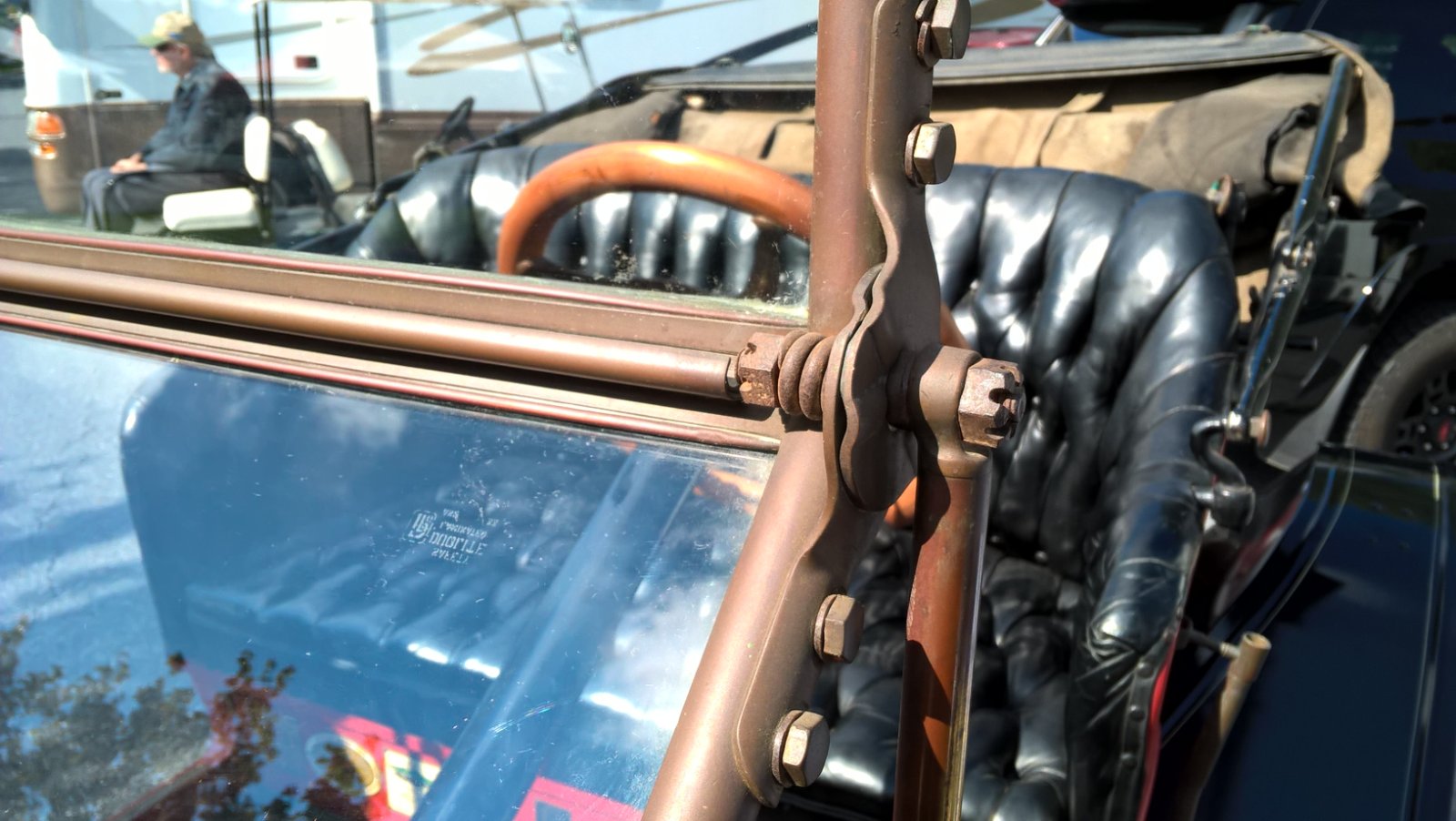

The standard Rands hinges shown here are made to work either vertical or offset with detents at each position.
The "seal" consists of two brass strips running the length of each half, top and bottom, and they nest inside of each other without touching. The one shown in this photo is actually upside-down (just flip the windshield over).
To my knowledge the seal is not currently reproduced. If you are making an entirely new windshield assembly, don't waste your money spending extra for the Torpedo windshield "kit" that is out there. It came with a bogus one-piece seal that I was told "was made to deflect rain but not air" (tell me how that one works), two support rods that were nothing more than straight lengths of brass tubing, and two unfinished rough-cast eyelets for the rods that were so far undersize that there's not enough material to finish properly. Maybe the right parts are out there now, but be sure and do your homework first.

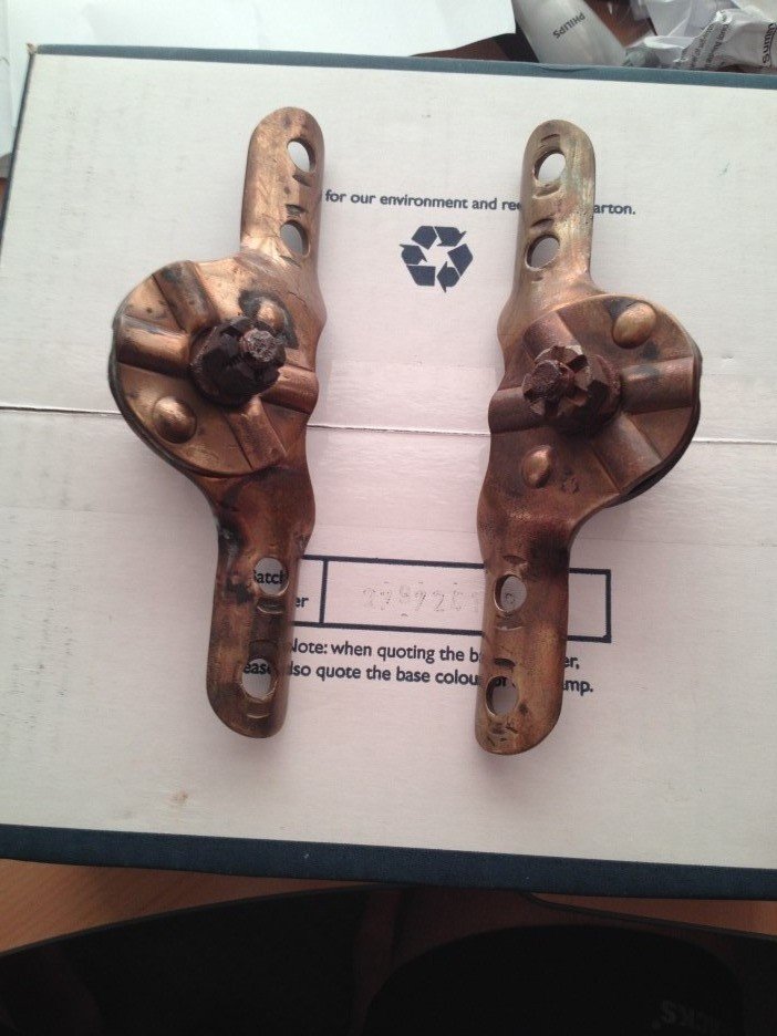

Walt: thank you for the pictures and the info. I have determined that the hinges on my windshield are repros as they do not allow the top half of the w./s to fold down without spreading the frame outward. As to the seal asy, I am going to try and reproduce what I see in your pictures.

Glad to help where I can. Yes, the reproduction hinges are junk. Good original hinges can be a little tough to find but they are out there.
