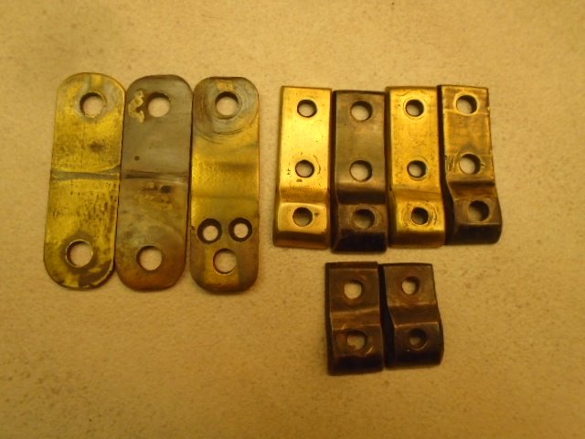

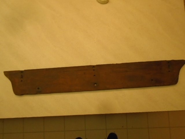

I have these brackets in my stash and I don't know exactly what they fit (some early teens). These brackets are cast brass and they came out of an old collapsing barn with a brass windshield frame and the wood attached. From earlier comments they are most likely repros.

Post by KWTownsend » Sun Feb 17, 2019 11:14 pm
That windshield spacer board looks like the type used in 1909.
