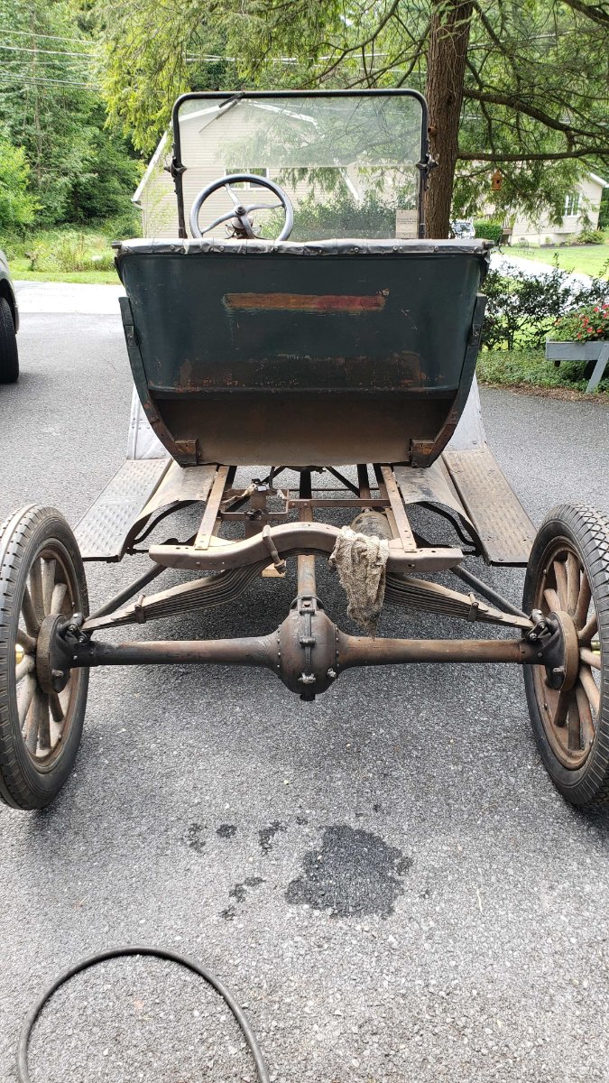

I'll be starting on a wooden bed for my 1915 cut-down touring soon. Instead of making it all up, was hoping to start with plans for an accessory bed if available. Does anyone have a good source to share? Thank you in advance! Photos shown are of other members from here that I've been saving in an 'inspiration' album. Shared here to show what I am going for.

THANK YOU! You are a true gentleman and friend of the hobby. I will be sending you an email! I agree with and understand your considerations regarding the bed and frame rails. I've attached some photos of mine.

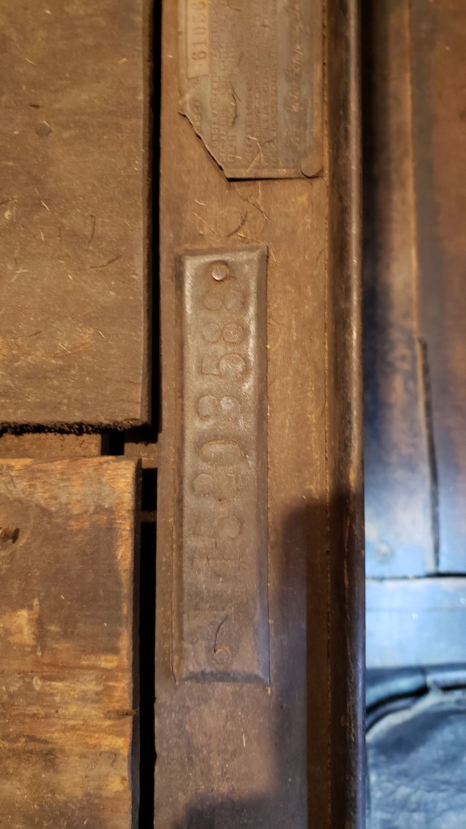

Also, yes the body has a B on the front seat heal kick area and is a Beaudette body from January 1915 per my understanding of the brass Beaudette number plate underneath the front seat cushion. I think you may have assisted me in figuring that out last summer. I think that would make this possibly one of the earlier 1915 touring bodies IF it had remained intact. I know for a fact it was titled as a roadster prior to 1965... and so assume it's been cut-off a long time. I am the 6th 'owner ' per the title and the known history from 1965 to present. Prior to it being titled last, a 1922 engine was placed in it. All other chasis and sheet metal parts 'appear' to be of the correct era for an early 1915 touring. But who knows, it was stored in pieces since 1965.

Also thank you for posting the additional photos of your cut-off. And yes the "1 15" at the beginning of the Beaudett (also spelled Beaudette and called Pontiac on many of the USA Ford documents) body number indicates your touring body was constructed in Jan 1915. That could have been early or late Jan. That along with the early style rear axle would both indicate an early 1915. I assume the smooth brake, reverse & low speed pedals came with the 1922 engine? And can you tell if the battery bracket was originally came with the frame or if it was added later. (I added ours to our 1918 touring around 1966 or so. It is bolted in and it is easy to tell it was not original to the frame. Now days I would not do that -- as we only used the storage battery to make starting it easier. It doesn't have place for a starter. Now days there are lots of small rechargeable batteries that were not available back then that could do the same job of firing the coils on a cold day.)

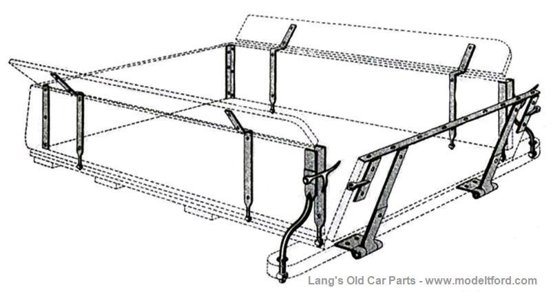

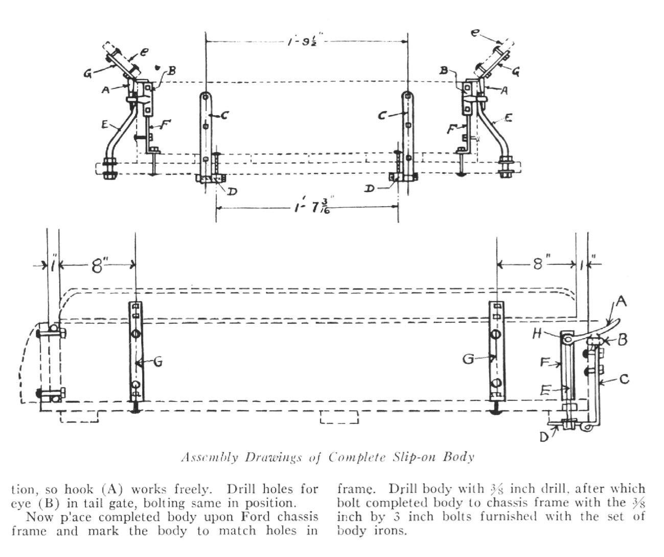

Found a couple of diagrams via the internet. First was described as 1915 roadster

The 'Slip on Body' book is on back order at some vendors. Wondering if anyone has a resource for these plans, or a spare available they would like to sell.
Starting to mock up a body anyways. It'll take shape one way or the other!

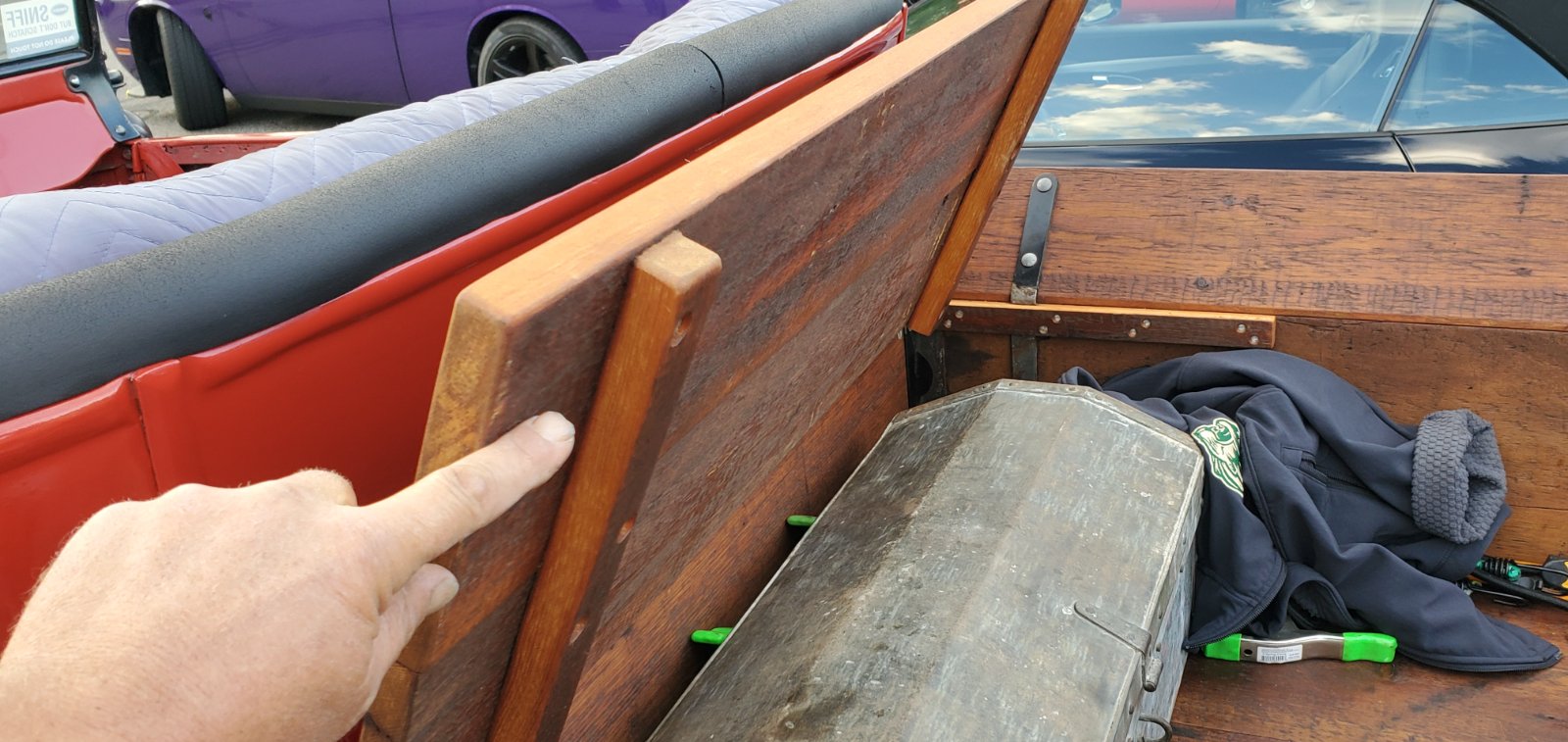

Here are some pictures of one I built several years back i know the hex nuts are incorrect 1 day i will change out with square nuts.

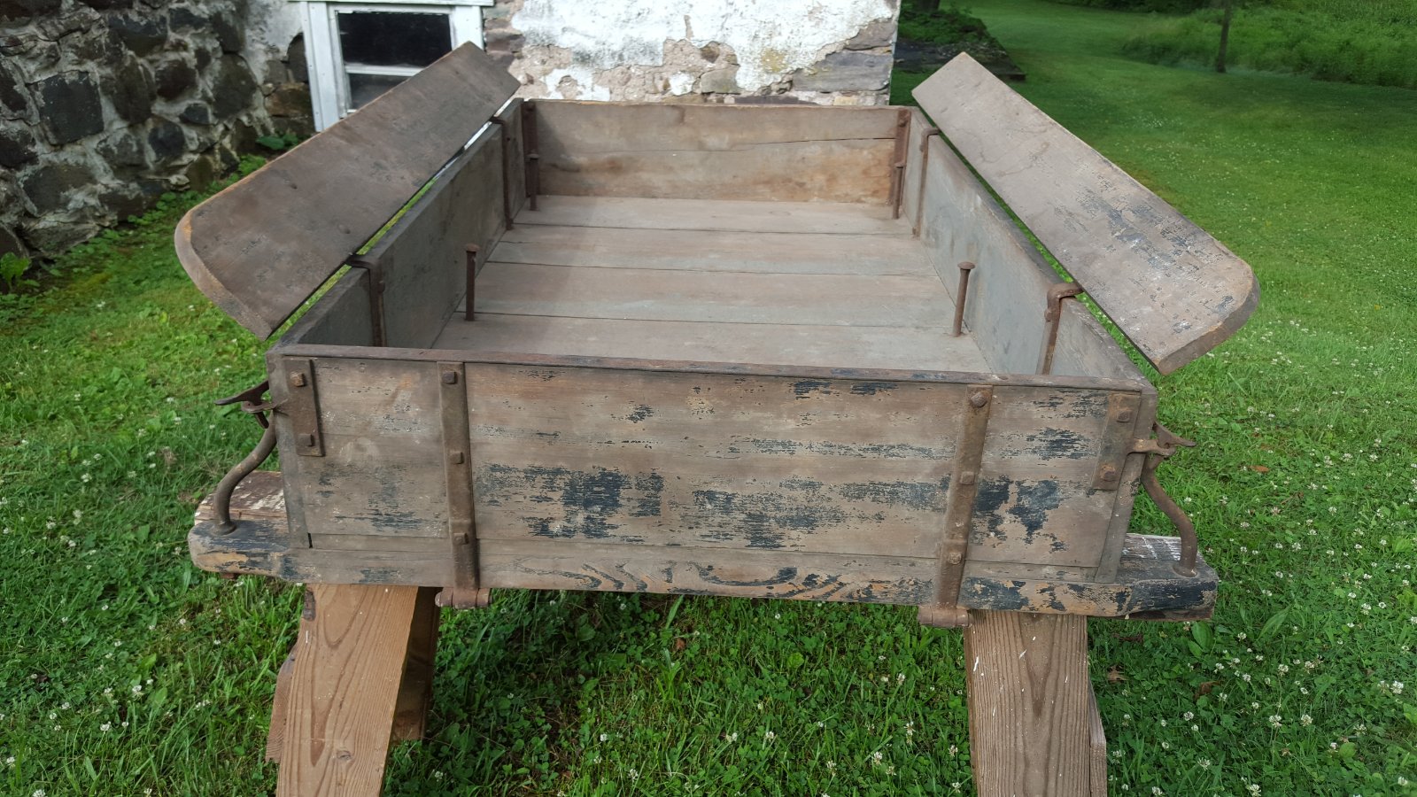

Here are a few more pictures of my homemade bed.

Sorry mine's on a roadster not a cut off Touring. But could be made to work on a cut off touring also.

L.I Tom, great photos! Liking what you did. Modifying gate hinges is a great idea!
