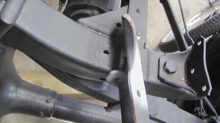

I have searched but did not find anything that looked like this carrier. A 30" rim fits it nicely. I want to use it on my '17 roadster. Can't quite see how it mounts. Appears it should bolt to the frame but matching frame holes are not there. Was this an accessory that required drilling holes in the frame to use?

17 did not have demountable rims so no spare tire carrier. The frame will not have holes to mount this. Your carrier is not the normal style.

It does not look like any Ford spare carrier I have ever seen, so I would say yes on the aftermarket. Ford didn't have that sliding piece to hold the rim in place, just a clamp. Looks like the one side that mounts to the cross member is missing a piece, I think that that missing piece is important to the overall strength of the holder.

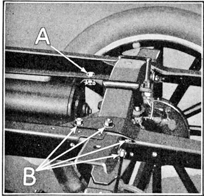

Your aftermarket accessory rim carrier is made for T's 1919 and later that had the frame and rear crossmember drilled for the Ford style carrier.
To use it, holes need to be drilled. The photos may help.
Seems too, that maybe that accessory was modified? There are welds on the ends of each hanger. May have been on a different make of auto.
Carriers were made for the pre-'19 frames, that mounted to the underside of the rear spring u-bolts.
