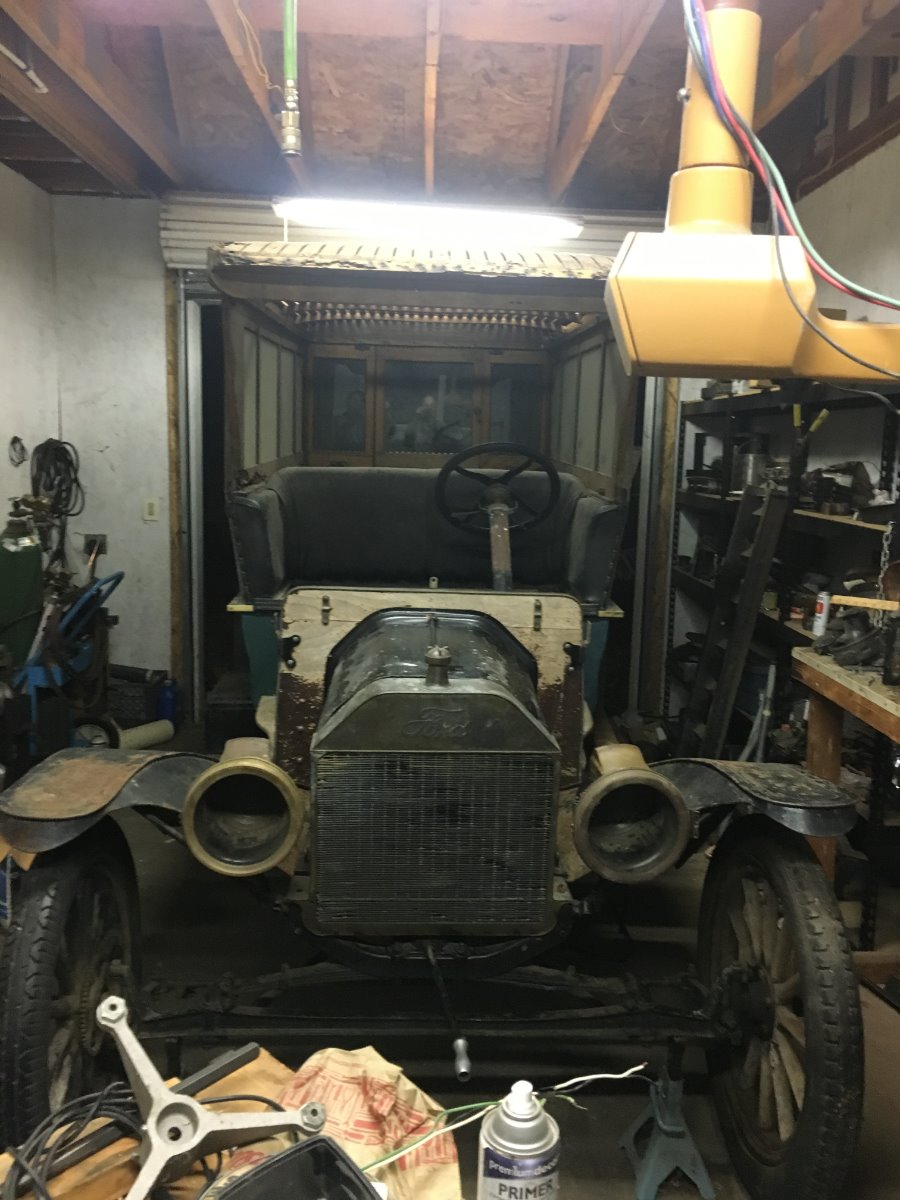

We are replacing the wishbone with a set of front radius rods with Laurel lowering blocks with the spring mounting system. The front axle is perfectly aligned with the front of the frame and now we need to know the correct angle or measurement so can move the axle forward in order to get the proper caster and install the rear of the front radius rods to the frame. The rods are adjustable but are a pain to do so, so we want to get it as close as possible without having to play "trial and error"a We don't want to guess this one because the record holding "King of the Hill" Chris Egsgaard Hill Climb engine is being used in this build and we think we have about 85 horsepower or so, so it's not just a Model T any more and must be safe to drive at speed. We have a Layne Warford and a rear end with safety modern bearings in the drive train and safety hubs with Rocky Mountain brakes. Every thing is strong and done correctly and we seriously need either the correct angle and where to measure it, or the the measurement of the space between the angle at the top of the axle when using a framing square to measure the space. Thank you for any assistance on this matter. I have not been well and can finally get back to progressing with this build.
We are attempting to build a copy of Terry Horlick's "Toady" who graciously sent us a copy of a set of his own one off plans for the build. As suggested by Terry, we are using a TT frame in order to balance the rear end passenger load better at speed. Because of the fact that the Laurel blocks lower the front end, we have Zee'd the rear of the frame to conform with the desired body stance. We are looking forward to helpful information on this matter.

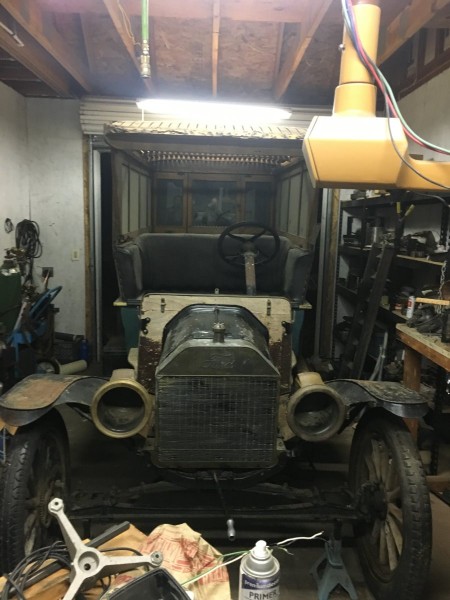

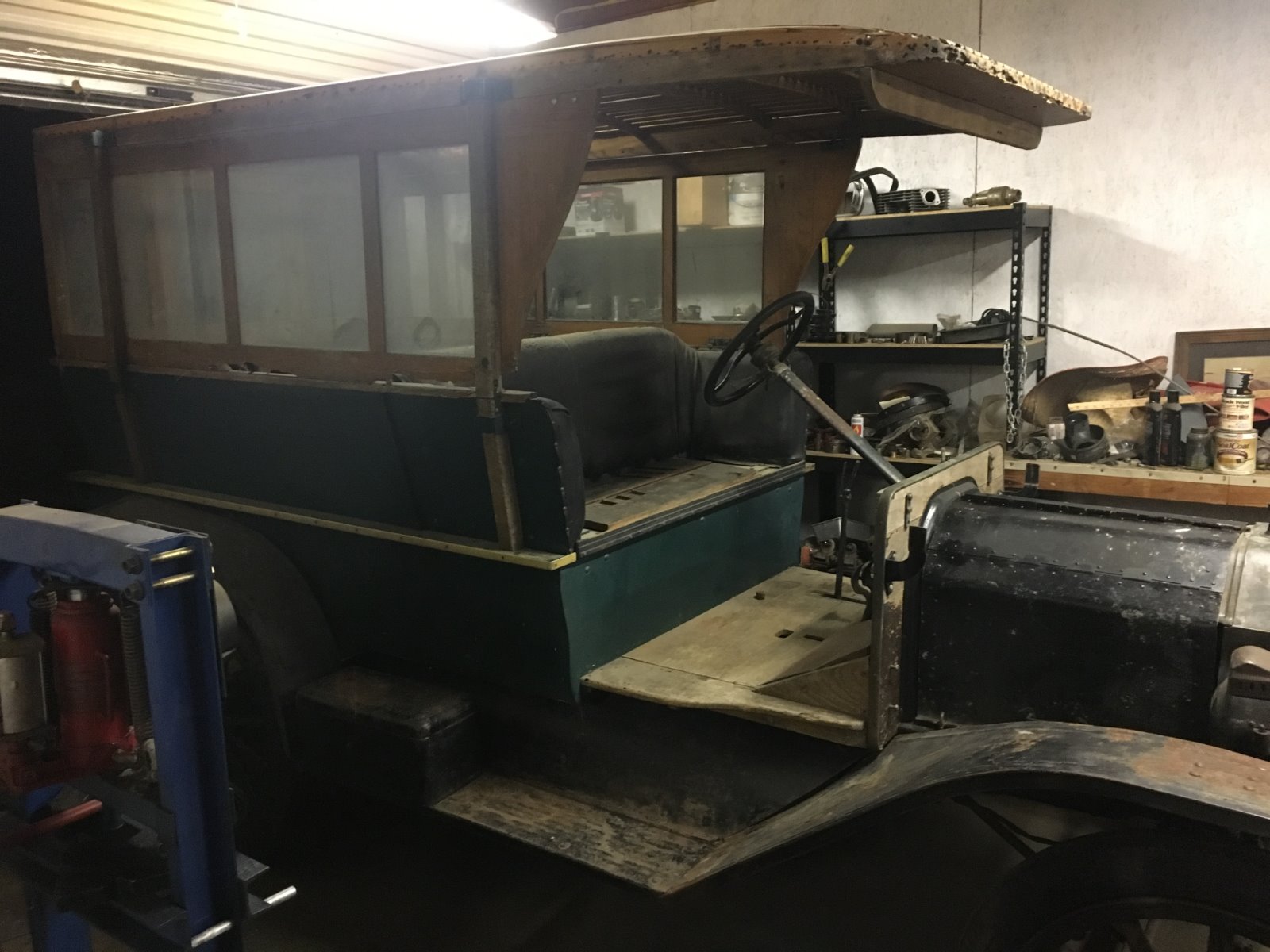

That's a photo of "Toady". I sure wish I still had that car. After I sold it Terrie told me that was the only car I had that she liked!
You may be interested in the car I have sitting in the garage awaiting restoration. I wanted one which can carry Terrie's friends or lots of kids. I hope she will like it too!
Terry[/color][/size]
