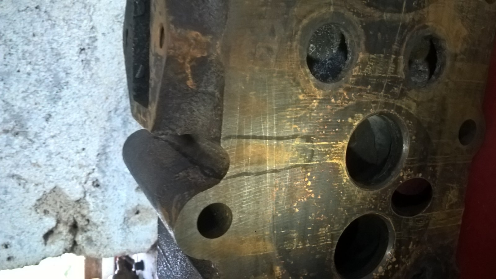

Can't help you on performance but first thing to check with those single port Chev heads is the top of the exhaust port for cracks, they can be bad and not worth trying to repair.

Not worth using the single port- they are prone to cracking! I have a spare '28 head if you're interested

There is a saying about those single port heads -- there are thems that are cracked, and thems that will be.
