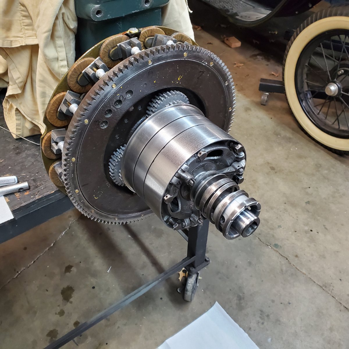

low speed drum on trans rebuild
I am going through my trans, rebuilding what I can afford, on the way. The low speed drum isn't cracked but is worn a bit in the middle. Should I attempt to have it leveled out? Not sure how, economically... Mechanics that then brake drums are few and far between... But those are in the inside of the drum surface, not the outside. I am putting on wood bands. I attached a photo... If left, will the wood wear in, eventually ?
My reverse drum rocks just slightly on the low speed drum bushing surface... But the bushing and the smooth portion of the low speed shaft next to the drum, only seem to measure .002" -.003" difference, which sounds about perfect from what I've read.

Your drum looks just fine. That's not very much wear at all. Not worth removing any material from it.

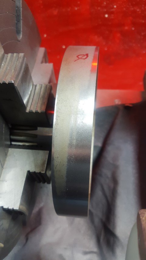

I personally wouldn't be worried that the drum is worn more in the middle because the band will wear in to the drum. I'd be more concerned if the surface of the drum still runs concentric to the shaft. If not the band will jerk and jar the car when you take off which can be unpleasant at the least and eventually damage other parts of the car. I would put the drum in the lathe and skim off just enough material to get the surface to run concentric to the gear again and you should be fine.
