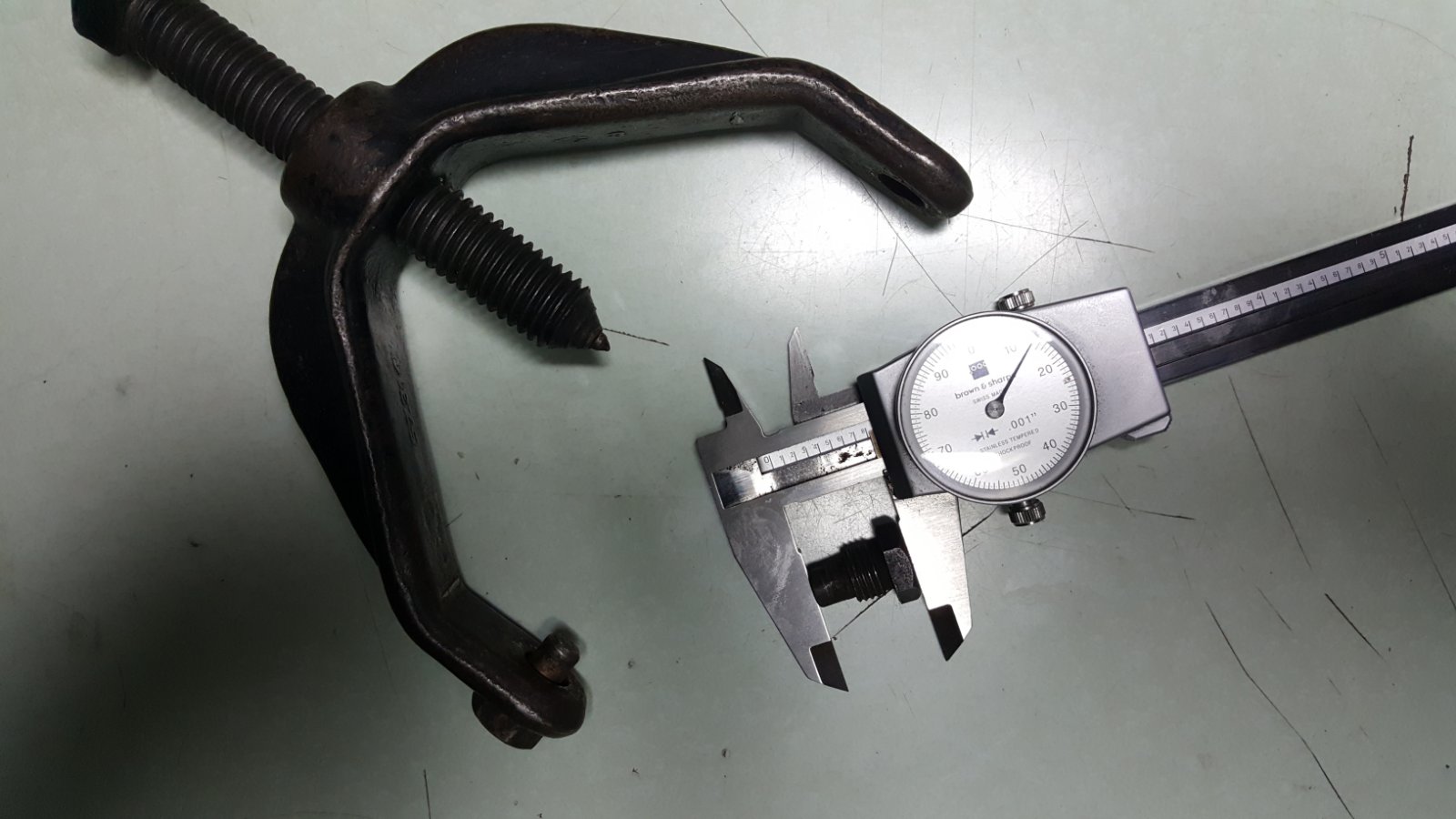

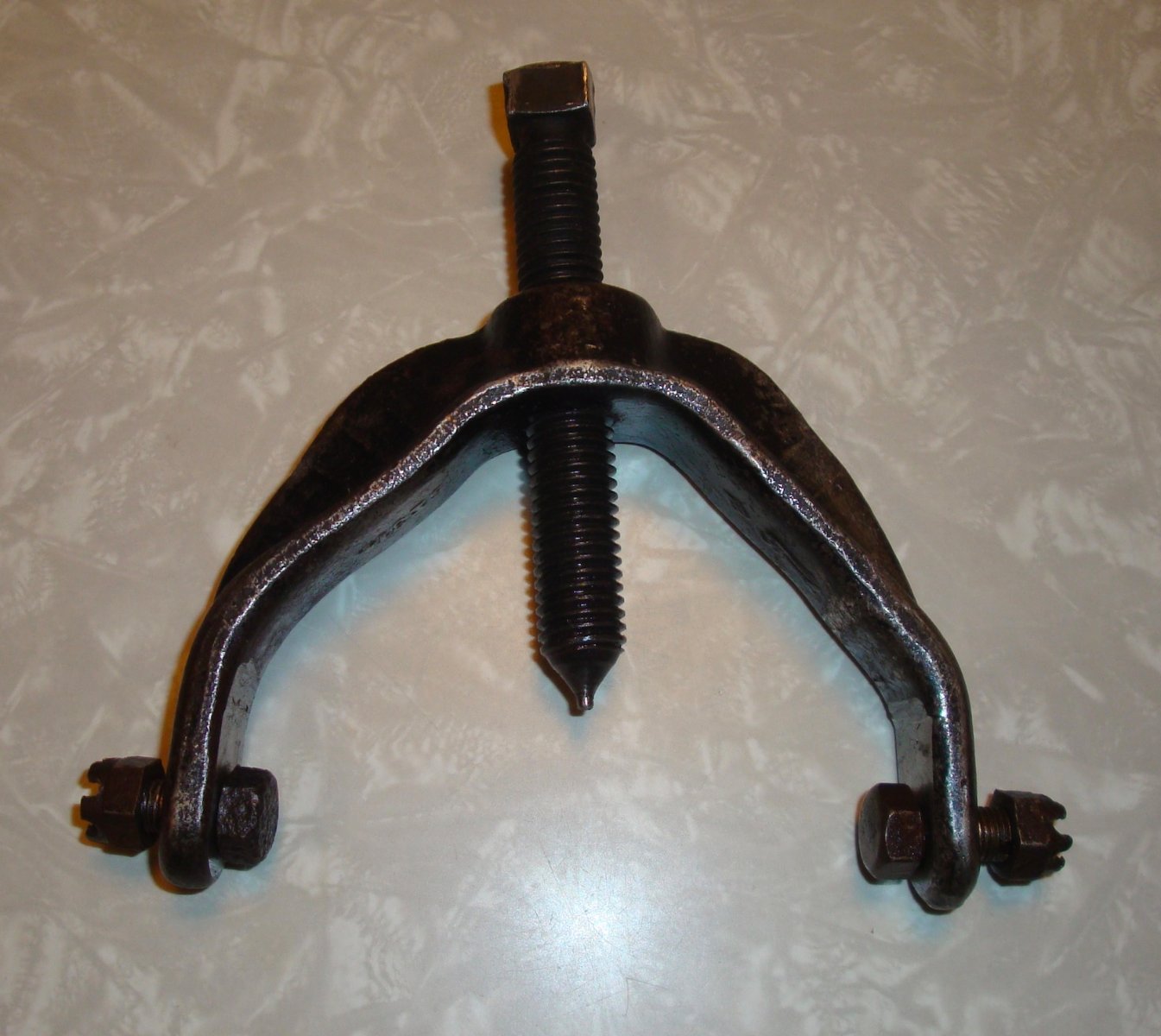

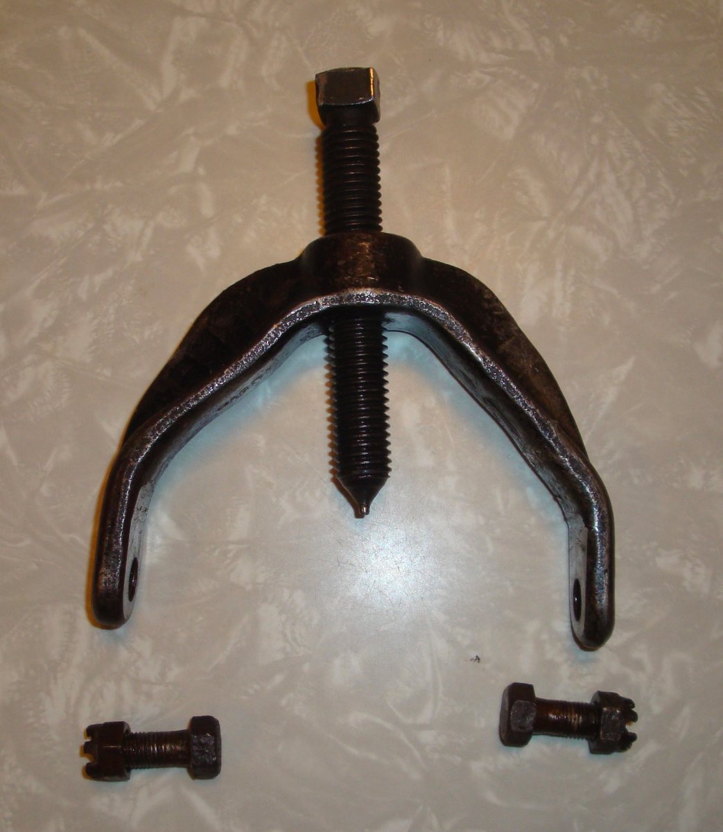

I recently acquired this 5Z314 clutch drum puller at an estate sale of an elderly Model T enthusiast.
Can anyone tell me or post photos of the correct bolts for the puller?
It came with two 3/8" bolts and corresponding castle nuts as shown in the photos.
However, these bolts are too small for the threaded holes in the puller.
The threaded holes in the puller are 13/32" in diameter which seems like an odd size. (A 13/32" drill bit fits in the holes but a 27/64" drill bit does not.)
Based on the few photos of clutch drum pullers I found in the internet, the original/correct bolts are probably only partially threaded so the portion of the bolts protruding from the puller are actually smooth prongs that are inserted in the corresponding holes in the clutch drum.

They are 7/16"-20 x 13/16" oal. I'm happy to take additional measurements if you'd like to duplicate them accurately.

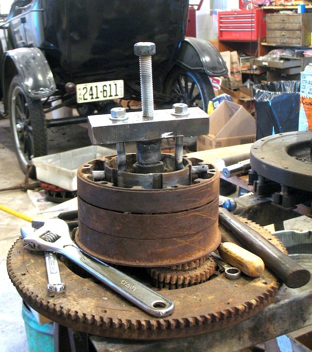

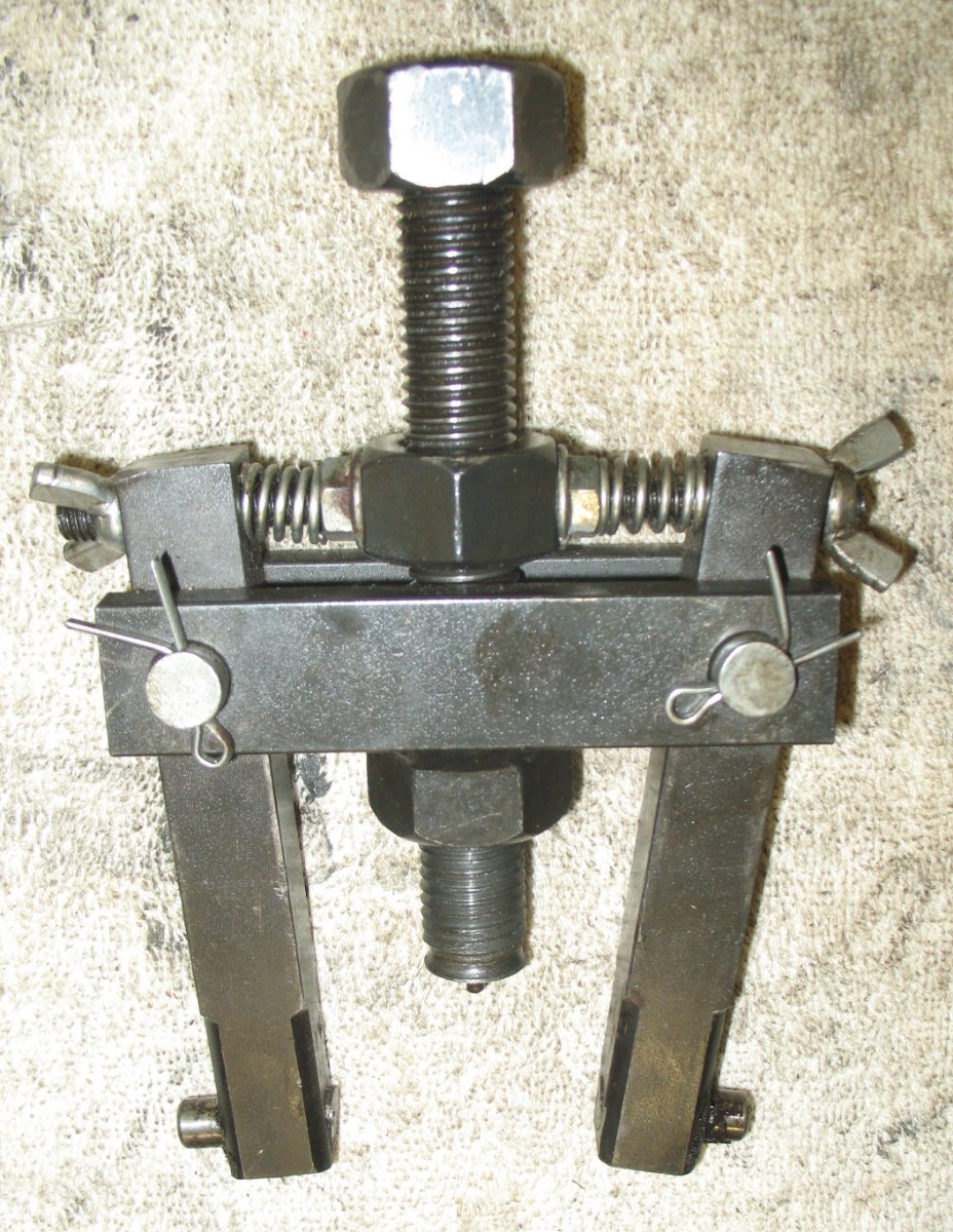

Same set screw used in cam bearings. Part #3046. About $3 from the parts dealers. The puller sometimes works but a drum that's really stuck will wreck it and you'll have to devise your own tool or buy one.
Home made.
Store bought.

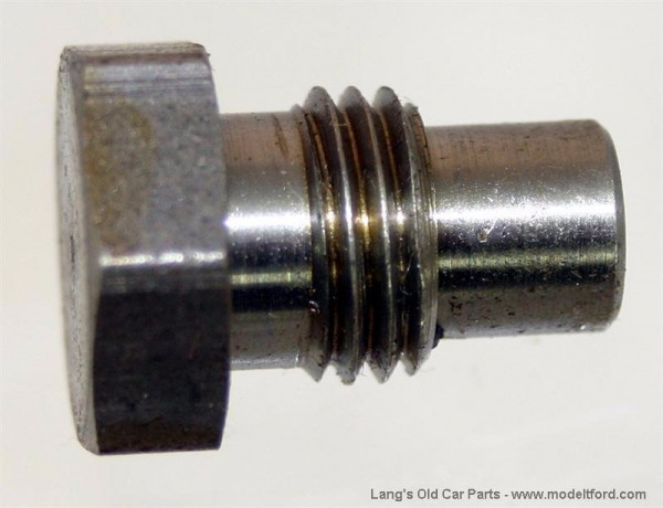

Thank you for all of the replies.
Here is a photo of the set screw that is available from Langs.
I'll have to see if my dad has any NOS or used in his parts stash.

On a hard pull, you are better off using 3/8 bolts with nuts. The pins tend to allow the puller arms to spread out and bend. Just FYI.
- Posts: 4624
Re: Clutch Drum Puller 5Z314 - Question
Steve is right about those hard pulls. It’s why you occasionally see the original puller ‘spread out’. That’s why the first pics show those 3/8” bolts with nuts on the puller. Just as Dan M. mentions. Sometimes those clutch drums are really tough to get to move.
