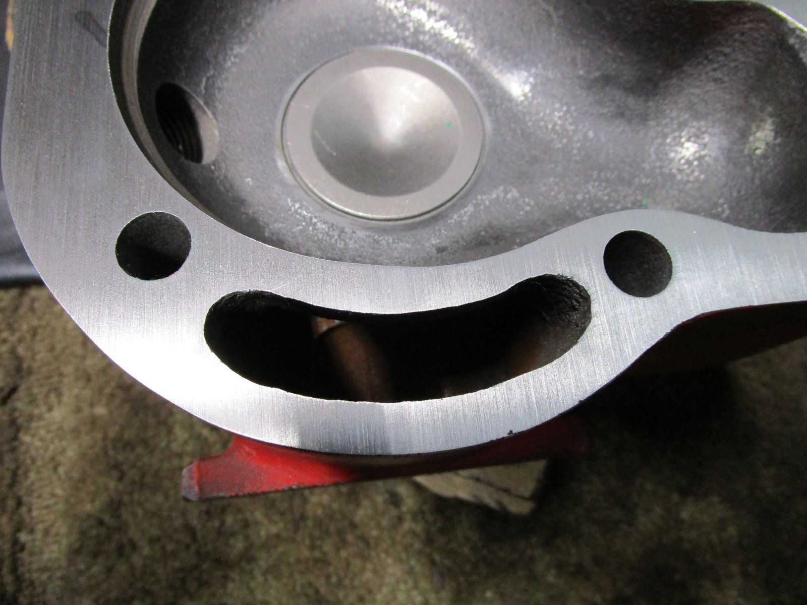

Re: Speedster project update, blown head gasket (again)
The heavy leak seems be coming from the area circled in blue;
Could this area be the issue? It looks lower then the rest of the surface. What about filling with JB Weld to build it up?I know the voices aren't real but damn they have some good ideas!

Good morning, Thanks for the input. Ill try to post a few more pics this evening.
Ill try to make a seal plate with gasket to do a pressure test of the #1 combustion chamber in a few days, as suggested. A bad casting is something I thought about. But dye check and mag test shows no indications at all.

I took the head to the shop today to have it surfaced. With Walters concerns letting me know the questions to ask (thanks Walter) and after talking to the owner of the shop who has been there over 35 years I decided to give the belt sander a try. After checking it with his straight edges he estimated we would remove about .005 thou. He placed it on the belt and ran it for 2 to 3 seconds. Then we flipped it over to see what was "shiney" The spot between the front two bolts was already showing to be flat. Also the entire outer edge showed to be flat. But the center areas of the head still showed no "shiney" It was like the head was milled into a "bowl". So he put it back on the machine and ran it for maybe 10 seconds. When he flipped it back over the entire head was fresh "shiney" except a small area between cylinders #1 and #2. He flipped it back over and ran it about 5 seconds. This time it was "shiney" everywhere. I really like the finish. It has just a little "tooth" to the surface. Its not a mirror like surface but just rough enough to barely feel. I forgot to ask what grit the belt was but it looks like 320 or maybe 400 grit to me as to the finish. We had checked the deck height before he sanded it. After sanding he checked again and it showed .004 thou removed. He judged the amount he would remove by "eye" when he first used his straight edges. He said he could see the "bowl" I mentioned before. His "eye" said it was about .002 to .003 thou of a "bowl" so .005 was his target removal. I was really impressed with his abilities. 35 years at the business showed. He said he has done thousands of heads thru the years, with very few problems. I do not think the belt sander is a good option for Hi Performance/Hi Compression engines but for T's, I'm happy with the results (so far). It was 25.00 to surface the head. I mentioned that I had about 20 to 30 original ford heads that I may want done. If I take him 10 or more he will do them for 15.00 each. I think Im getting ready to sand blast all my good looking heads, mag test them (I have my own Magnaflux test equipment) , and have him surface 10 of them. Then list them on e-bay a couple at a time. If it is clean, and you say it was tested, things sell very good on e-bay, but if its dirty or unknown, not so well. So today was a good day in Arkansas Model T Land
Im not sure if the "bowl" had anything to do with my problem or not. But now, I do feel more comfortable that the head is flat. I guess my next step is to try and pressure test the block and head using the old solid copper gasket. Any thoughts on how much pressure. ??
Thanks for all the input.... I can usually "work thru" all the problems I have, but its sure nice to have someone to "cry to" when things keep going to pot...
It was hard to get pictures of the finish to show up,
