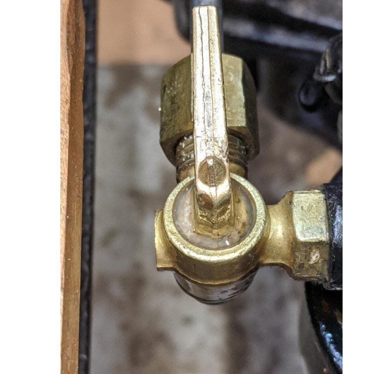

Would someone please tell me how to stop the gas valve from leaking? My other T also leaks but I live with that one.
The leak is from the top. I tried taking it apart and putting soap on it and some other stuff they say airplanes us on gas valves (I think.)

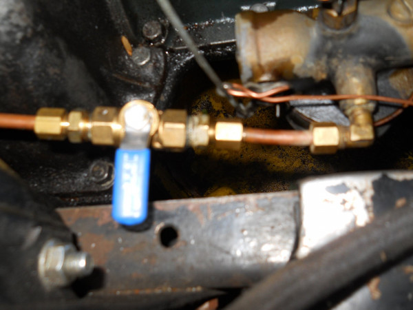

I installed a ball type inline shut off. Not original looking but would rather have one that worked then worry about appearances. In my OP, the modern type brass used to make the valves like you are using is too hard and makes hard to get a seal plus they are not real user friendly to open and close. If you want to keep the one you have you can try lapping it in with toothpaste or Timesaver then relube. Are you sure it is not leaking where it is screwed into the carb? Looks like it is installed really deep. Normally would expect to see threads showing, not seated all the way to the flats.

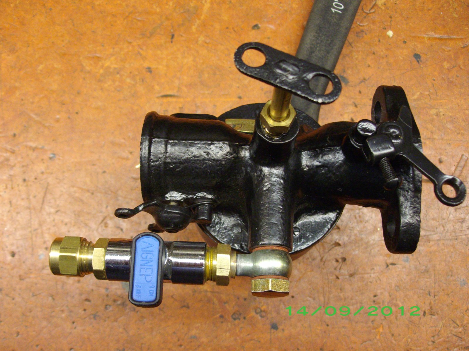

Bob , I use this one for years now , no problem .

A fuel tap with a shoulder like that one is designed to seal against a washer between the tap and the carb body. It will have a parallel thread. The standard elbow on the carb is a tapered thread, and winds in until tight[often in the wrong alignment] The carb body is not machined flat for a washer to seat against. It is the wrong tap for this application.
