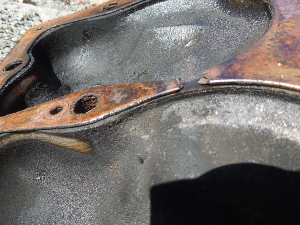

Thanks for all the information. Well, finished the tear-down this morning and found the engine does have a blown (piece missing) copper head gasket between cylinders one and two and also looks like traces of a water jacket leak at the forward passage. Torque was low on several bolts. The pistons are .060 over, domed type. Engine was recently rebuilt by the previous owner as there was hardly had any carbon build up yet. The pistons in two cylinders that have been running cold even appear clean and shiny. Valves look great, very tight, clearances still at .015. Sent Adam an email hoping to find suitable gasket so I can see how it runs on all four cylinders!

I had a very similar problem with blowing head gaskets with a Z head. There is really not much material between the cylinders in a few places and even less material in the casting of the Z head in the same places ( less that 3/32"), and that's where the gasket lets go. After replacing three head gaskets, a race engine builder friend came up with a way to deal with the problem. He suggested I apply regular solder (using a soldering iron, not a torch) along the folded over edge of the fire ring on the copper head gasket, just enough to seal the gap (not a big lump) and explained that it would crush as the head was torqued down to provide a more secure seal between the cylinders. That was three years ago and I've had no problems since. Hope this helps.

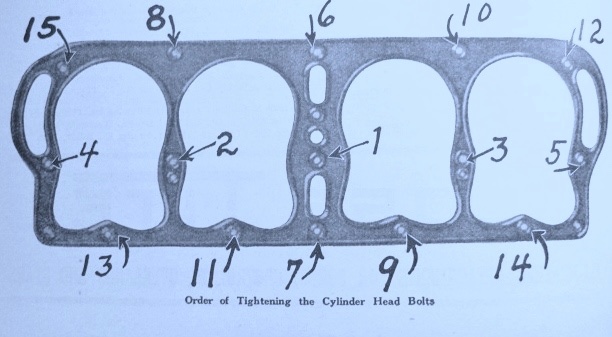

Just a note on gasket install, all the other postings are correct on having the bolt holes clean, etc. Use Copper Coat or equiv. heavy metallic content Alum spray paint and coat the gasket. Fit the gasket with #4 and #1 @ TDC, to be sure the gasket is aligned.
Then run down the head bolts. Finally do the torque sequence shown, very important to torque first all the center bolts, as that is where the cylinder walls and the gasket is thinnest. Doing the squish there first is necessary, then go outboard and finish at the ends of the cylinder head.

Between the cylinders in the center is where most times the gasket goes.
