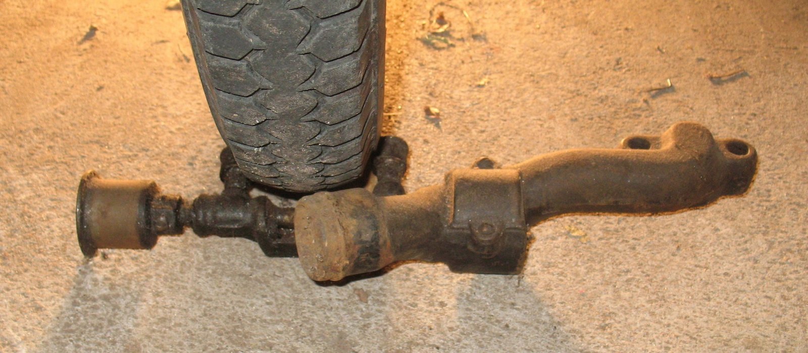

One here has a pump just like Steve's wheel chock. I like that type of pump. :)
Doesn't move much water and allows the natural water movement to happen too. Just a two blade impeller.
I didn't have an inlet elbow when this one was put together so I re-packed the gland nut, made gaskets and put it on.
Original rad that's been baking soda cooked out for the scale. Voila!
NEVER any problems parading with both "ears up" but maybe as it's worn completely out, it naturally stays cooler...
