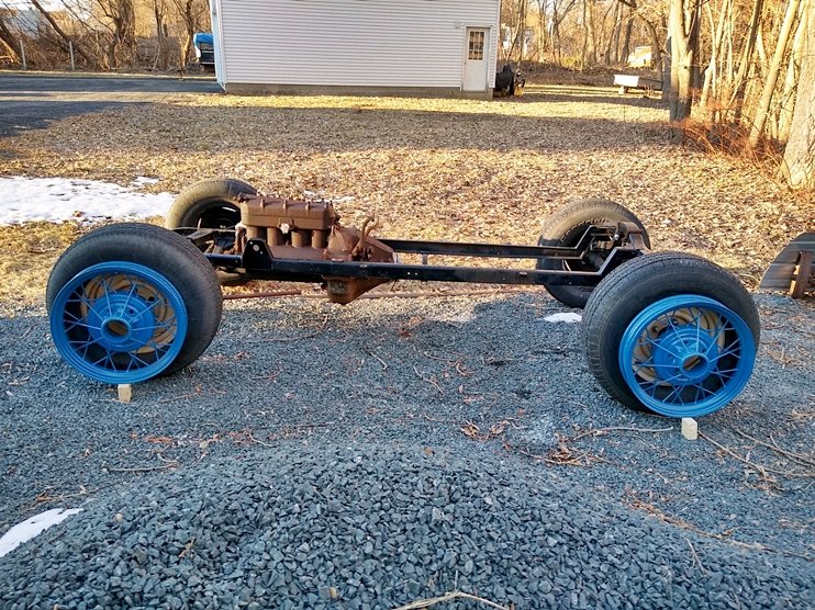

I prefer to use the early term Gow Job, rather than speedster. To me, a Gow is a modified full body car where a speedster tends to have a smaller (or none) homemade body, and sometimes a single seat car.
In another thread, some requested me to post pics. So here goes. Started about three years ago. I am still a long ways away, but its coming around. Shape eye people might have seen a brief write up earlier this year in Hemmings.
The goal is to use only aesthetic parts available from 1935 or older. There will be some more modern parts (specifically in the engine / drivetrain area that will be much newer, but hopefully none of those grow to become viewable out in the open. I am trying to make an as correct pre-war car as I can.
Please let me know if you have any questions, I will list the current state of parts.
'23 Roadster body
'20's frame
T block with A crank and rods, custom pistons
Frontenac "T" model head
SU - HS6 carb
Laural-Roof cam
Semi- pressured oiling
Model A front end and steering
Model A wire wheels (19's will be the final size)
Lowered 5"
Model A trans
T rear axle
Speedster Project 15.1.jpg (109.43 KiB) Viewed 8739 times
Speedster Project 25.1.jpg (91.32 KiB) Viewed 8739 times
Speedster project 59.jpg (99.43 KiB) Viewed 8739 times

Post by Chad_Marcheese » Wed Dec 09, 2020 7:13 pm
just before the cold really set in, i mounted up a body side to see how all of this was coming together.
