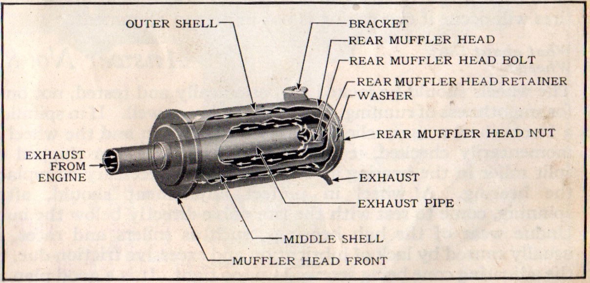

What material is used to pack inside mufflers thanks

None, they just have the 2 internal tubes with a few hole at one end of each tube. The gases enter the muffler travel to the back of the very inside tube and out the holes at it's rear, then travel back to the holes at the front of the middle tube then out the back of the muffler.

This is a Ford Canada muffler. The difference is where the exhaust exits. John Page, Australia.
