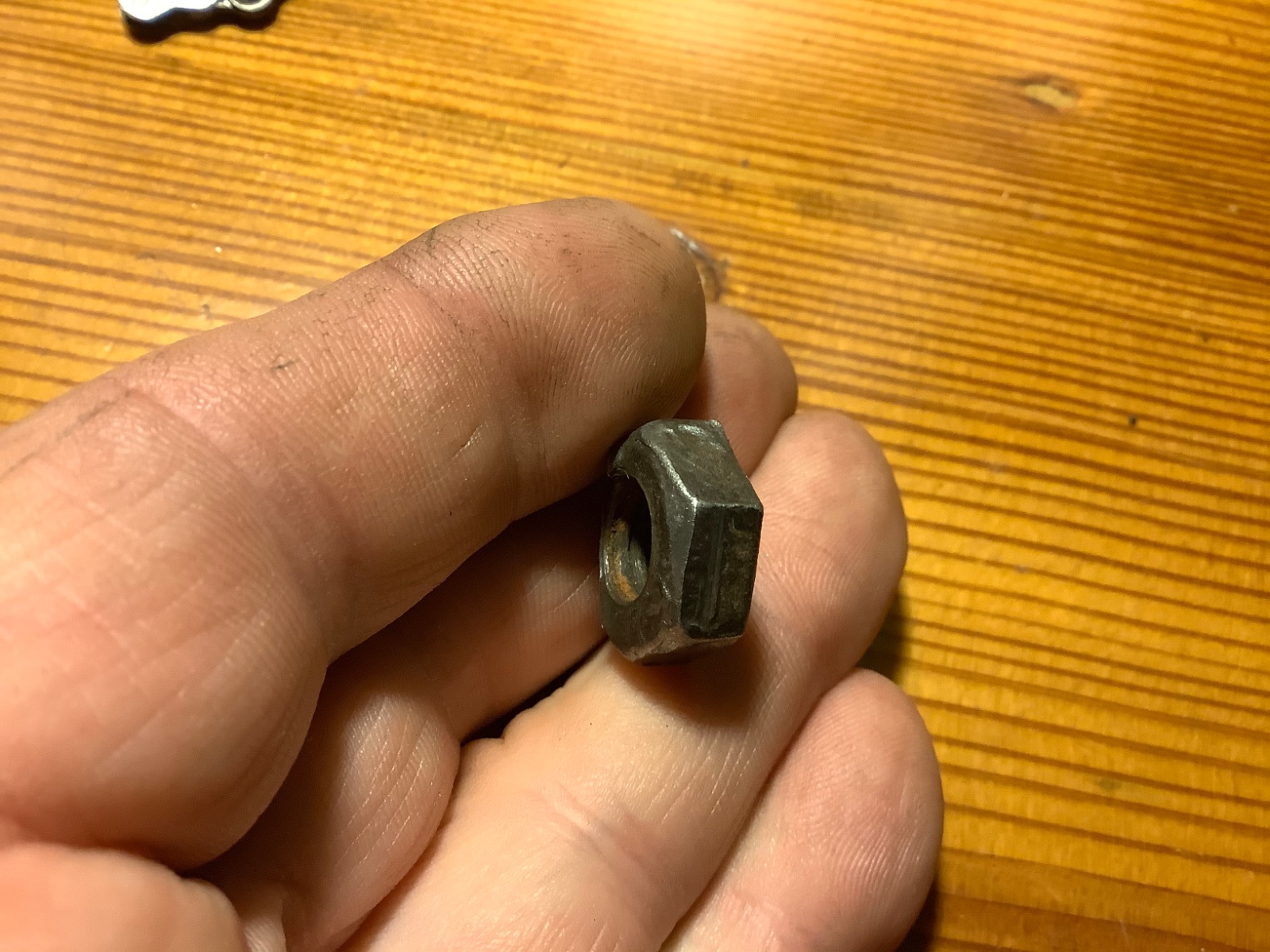

RV, I don’t have a print nor have I ever seen one, but I have had enough factory NOS nuts to do several sets of wheels. The ones I had were not made on a screw machine, I am certain of that. As Dan says, the threads were formed , not cut, and the nuts themselves were not machined , but formed, or headed. For what it’s worth. Of course , I’m subject to be wrong, and perhaps later they were made differently.

Originally they were cold punched, and about a Grade 1.5

Formed, headed= cold punched. Same thing. I would think that would be a tough look to replicate in a screw machine. JMHO

You are correct Tim. machined parts are like peas in a pod. Each one is an exact replica, unlike the punched/formed units. If RV's nuts are machined to the correct dimensions, they will be superior to the stuff presently available, and that is a good thing.
Machining replica parts can never produce exact copies of forged/stamped/punched items. langs now list machined flanged nuts and loose lugs for Kelsey wheels, and that meets a new demand, and I congratulate them for their efforts. But each one is a smooth, exact replica of the next. the original stamped nuts varied in the thickness of the flange, the hex was slightly tapered, getting thicker near the flange, and quite often the threaded hole was somewhat off-centre. These irregularities reflect the method of manufacture. The original loose lugs look to have been shear cut from a hot rolled steel section. The shearing slightly deforms each one. No two are exactly alike, unlike the new machined articles. Original parts have a different 'look' about them, because they are different.
None of this matters, if you are short of the bits you need, and the vendors can help with a practical, quality solution. Good on them!
