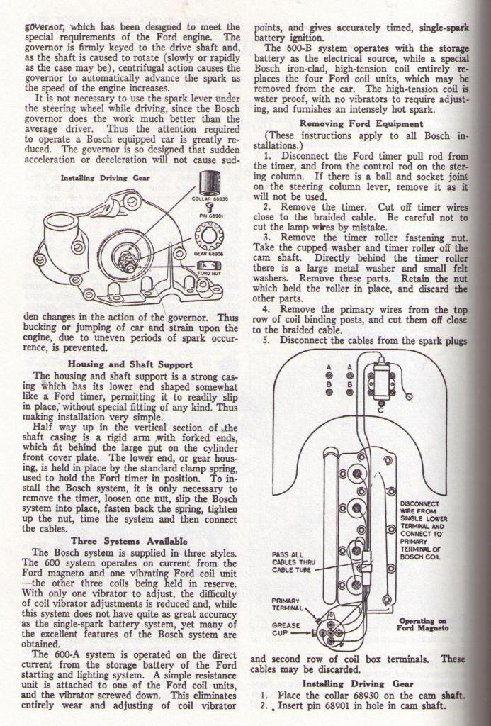

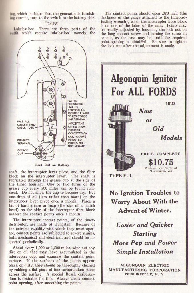

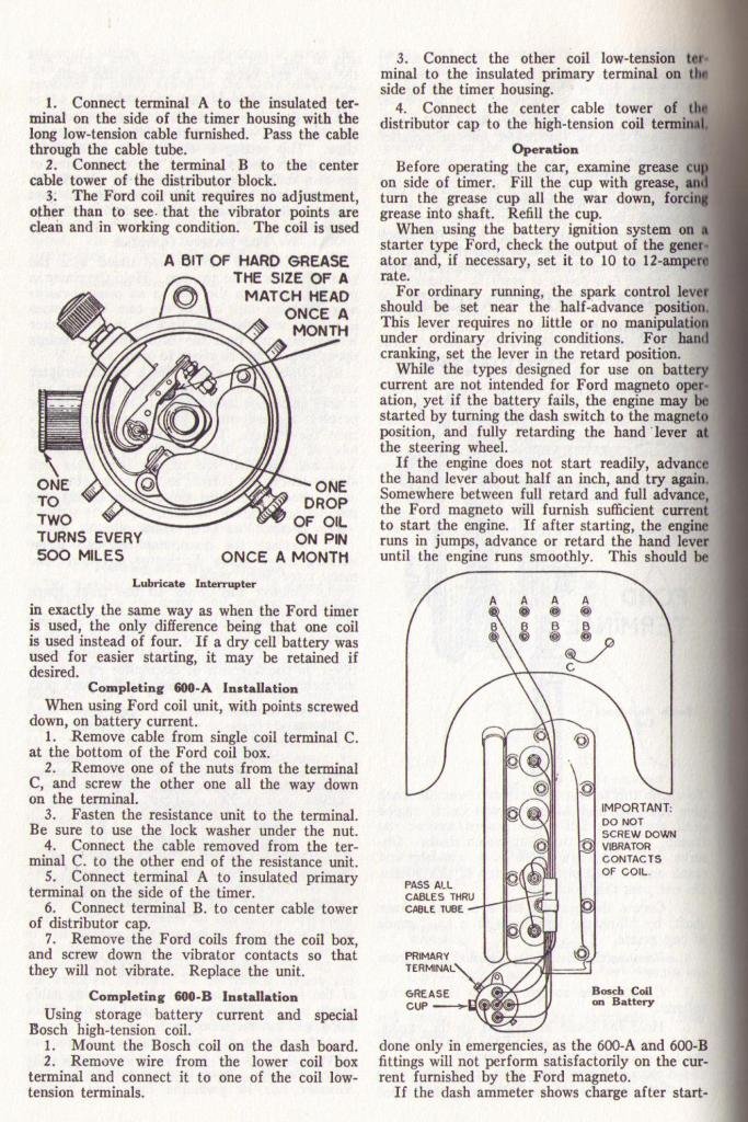

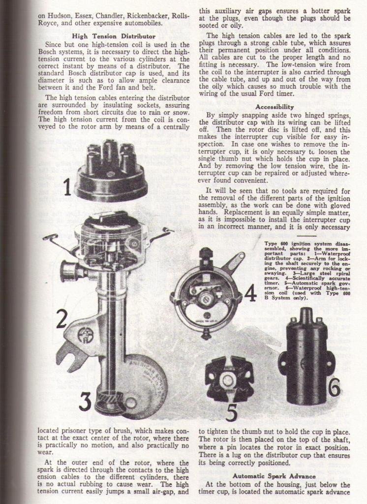

There is "BOSCH" (Robert Bosch GMbH as we know them Today) and then there was "AMERICAN BOSCH" which made the Model 600 distributor, Magnetos, Radios, etc . Parts are not interchangeable. Robert Bosch started the BOSCH company in Germany and at the advent of WWI the manufacturing of products here in the US was seized by the US Government and the Company here became AMERICAN BOSCH. Here is in o on the American Bosch 600 distributor.
- Posts: 6579
Re: Do they make a self advancing distributor?
and the rest of the story

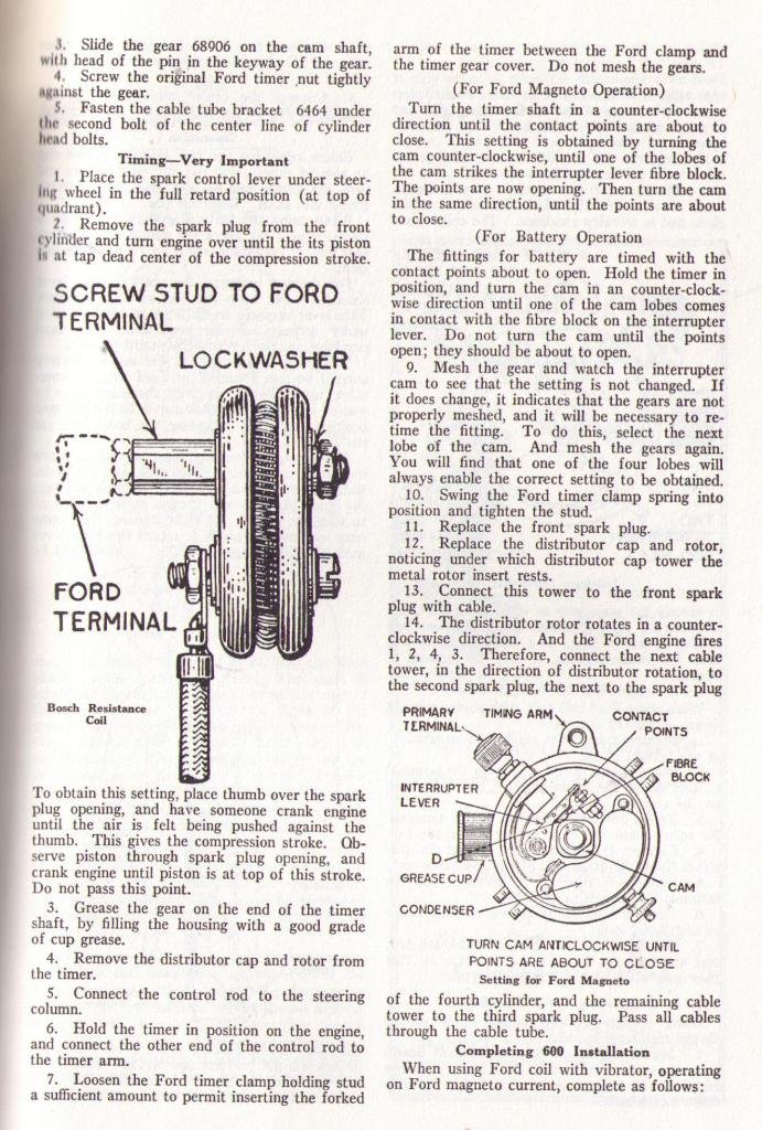

See the attachments in my previous response. The Bosch Clip on with centrifugal advance is the American Bosch Model 600. Previous forum discussion have said that the Texas T unit is distributor is a copy of the Volksbuggen 009 Bosch distributor. Making reference to a distributor as a Bosch, VW, 009, Texas T can be physically different distributors.

Mine is an American Bosch like the one shown in that literature above on the second page.

Just to be clear. The vintage "Bosch" distributor is best referred to as the "American Bosch" and not to be confused with Today's "Bosch" branding. The PDF contains information about the 600 Distributor
This is a link to modify the points (expensive) to electronic http://mtfctulsa.com/Tech/distributors.htm
There is History about the seizure of the Company during WWI and afterwords .
