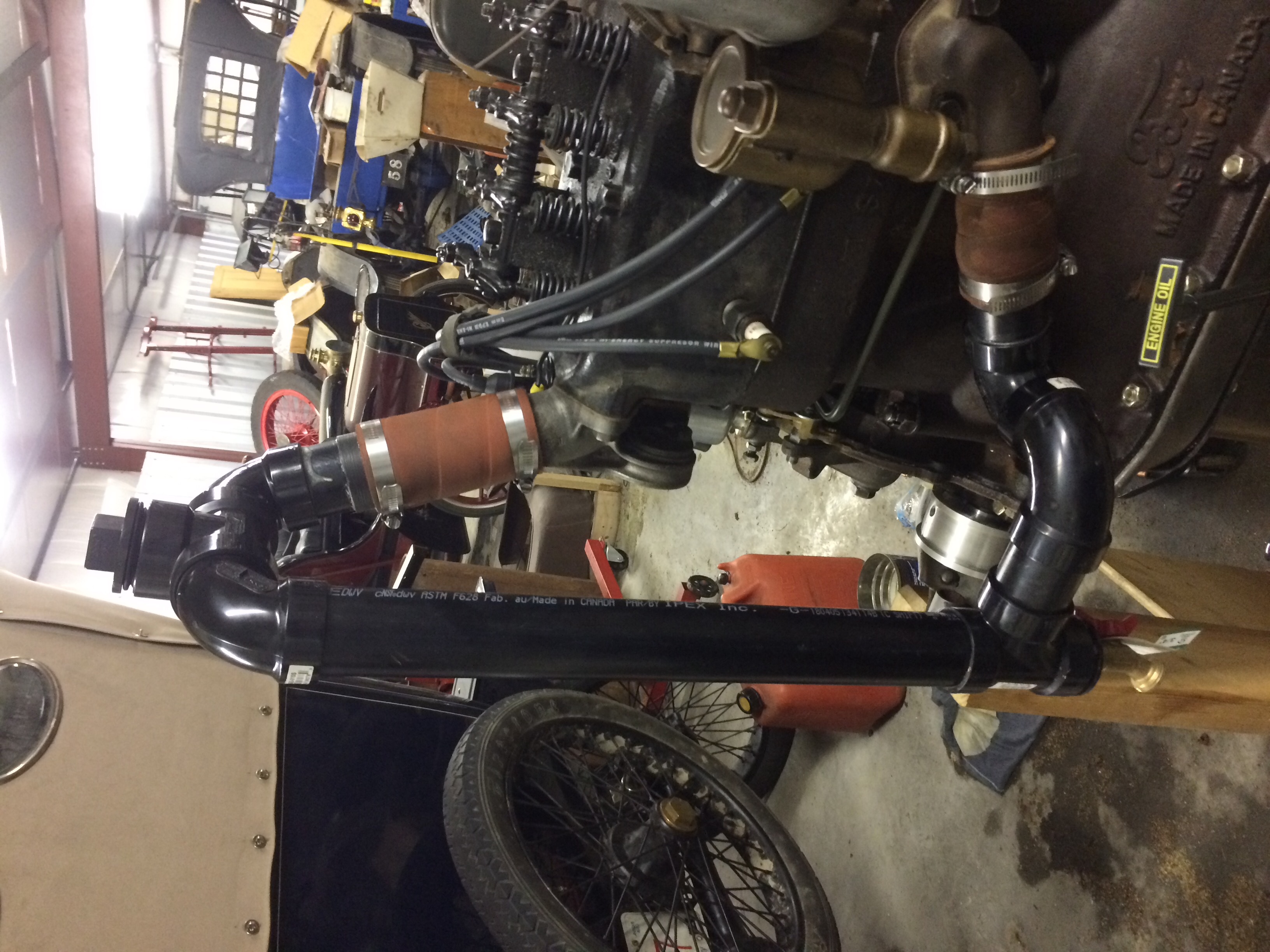

Here is a picture of a water pipe system that I made to facilitate test running a T engine. All made from plumbing fittings
Les Schubert
- Posts: 1364
- First Name: Les
- Last Name: Schubert
- Location: Calgary
Re: starting an engine on a stand
About $10.00 of material and a hours time!!

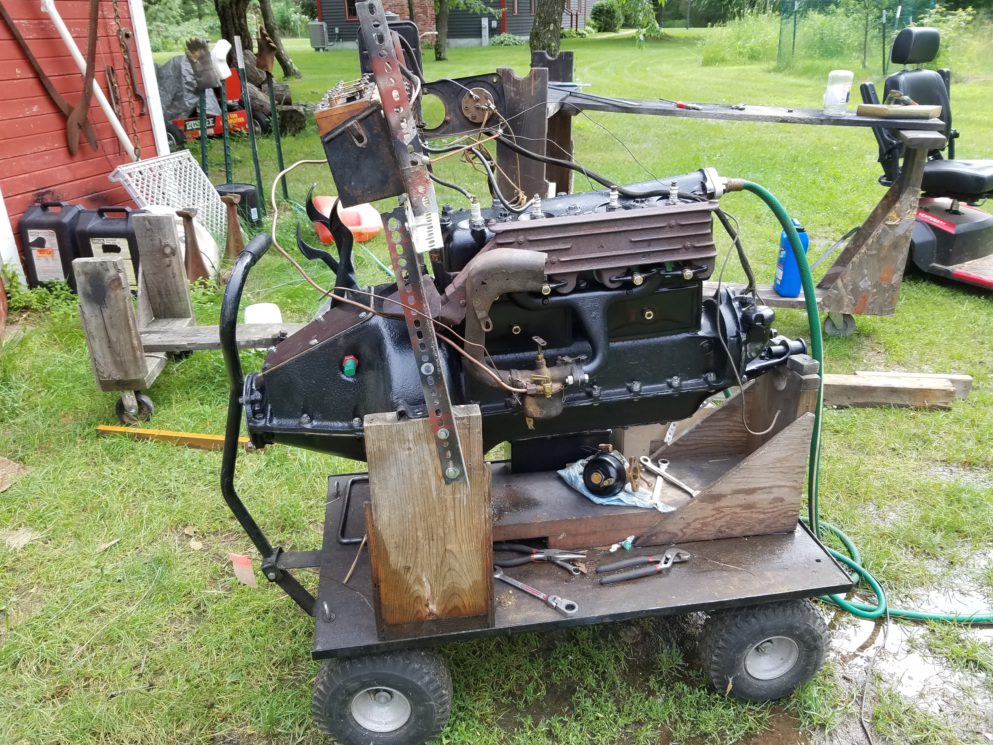

I use a cart so I can push it in and out of my shop. I also us a garden hose for the water supply.

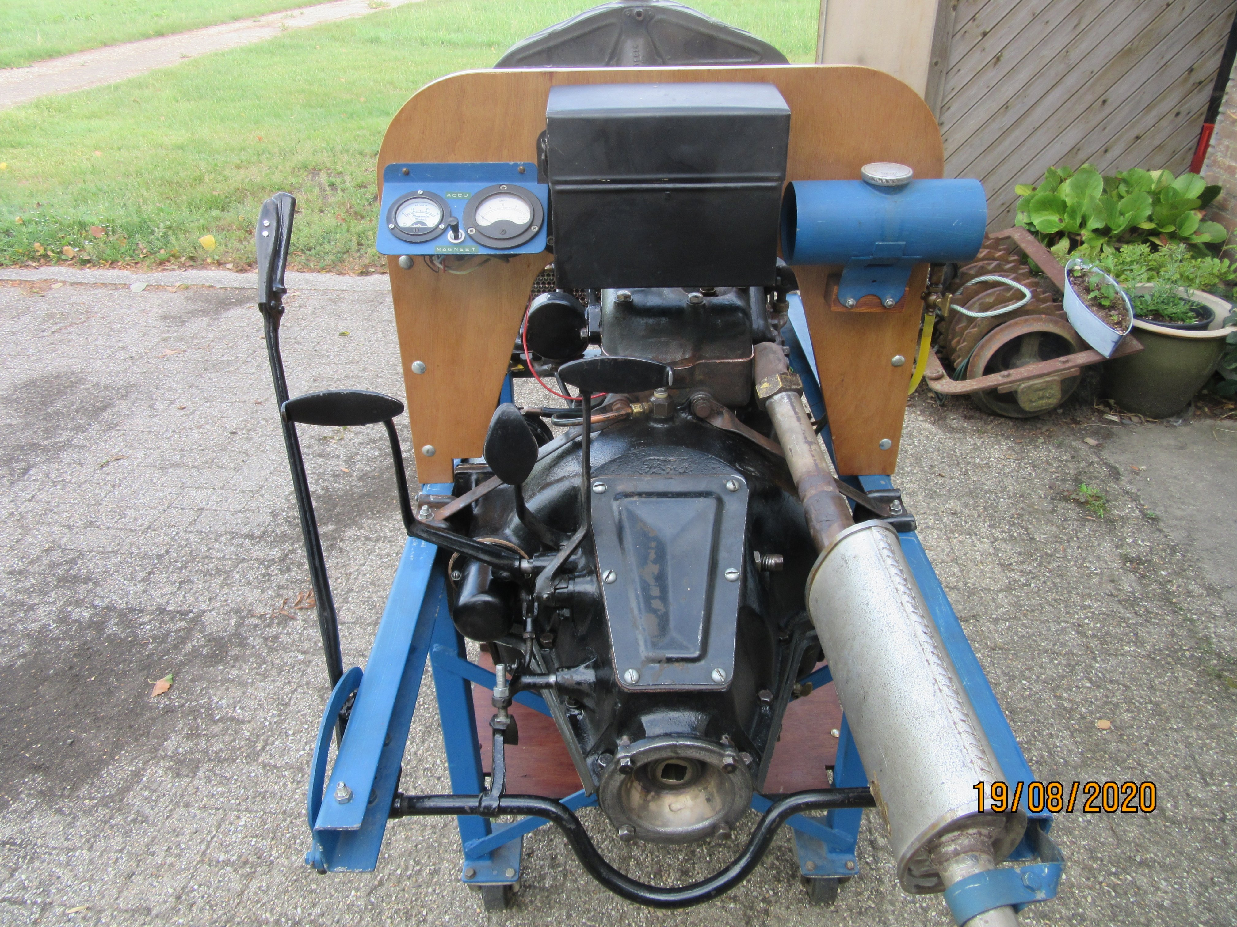

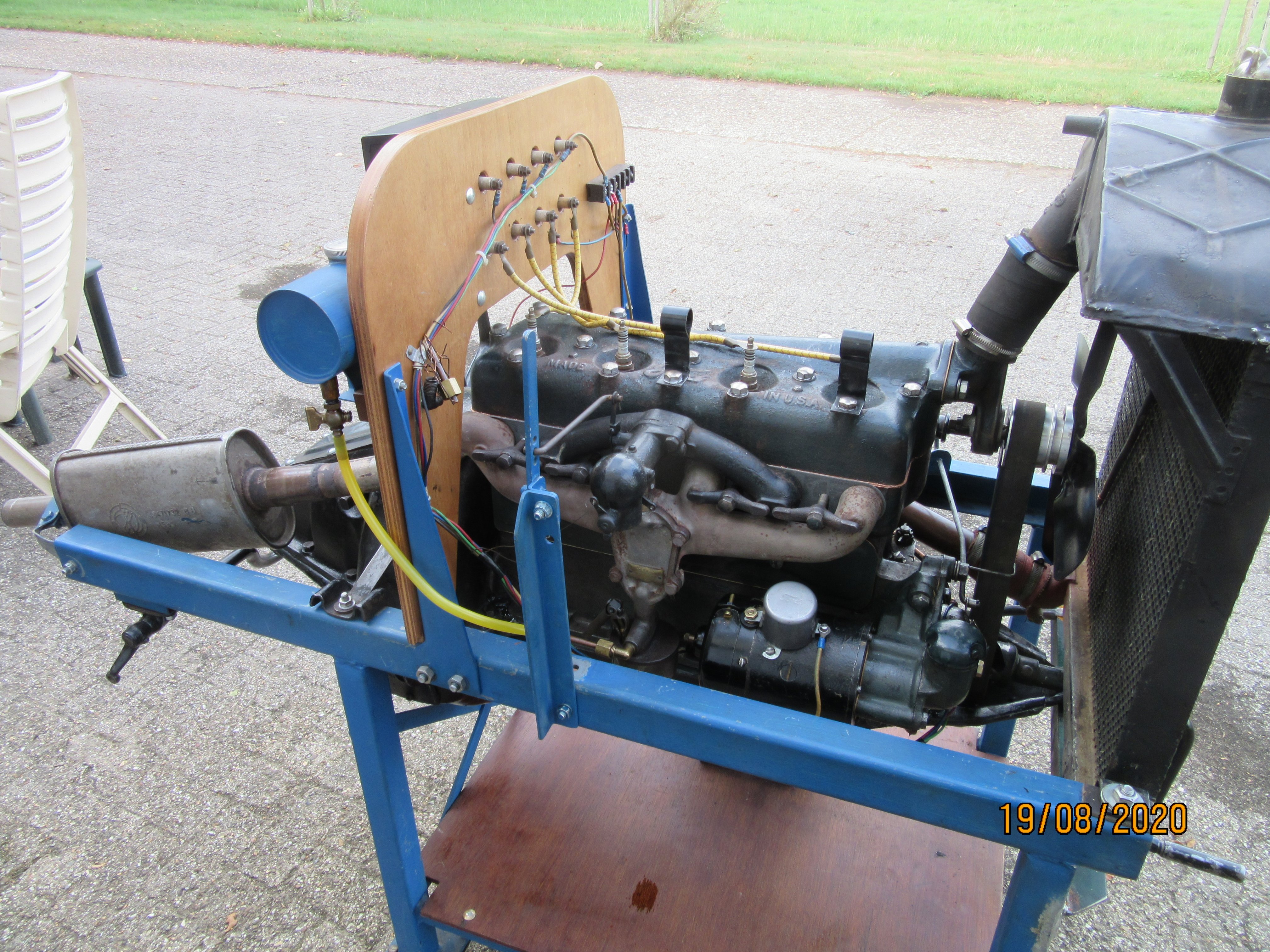

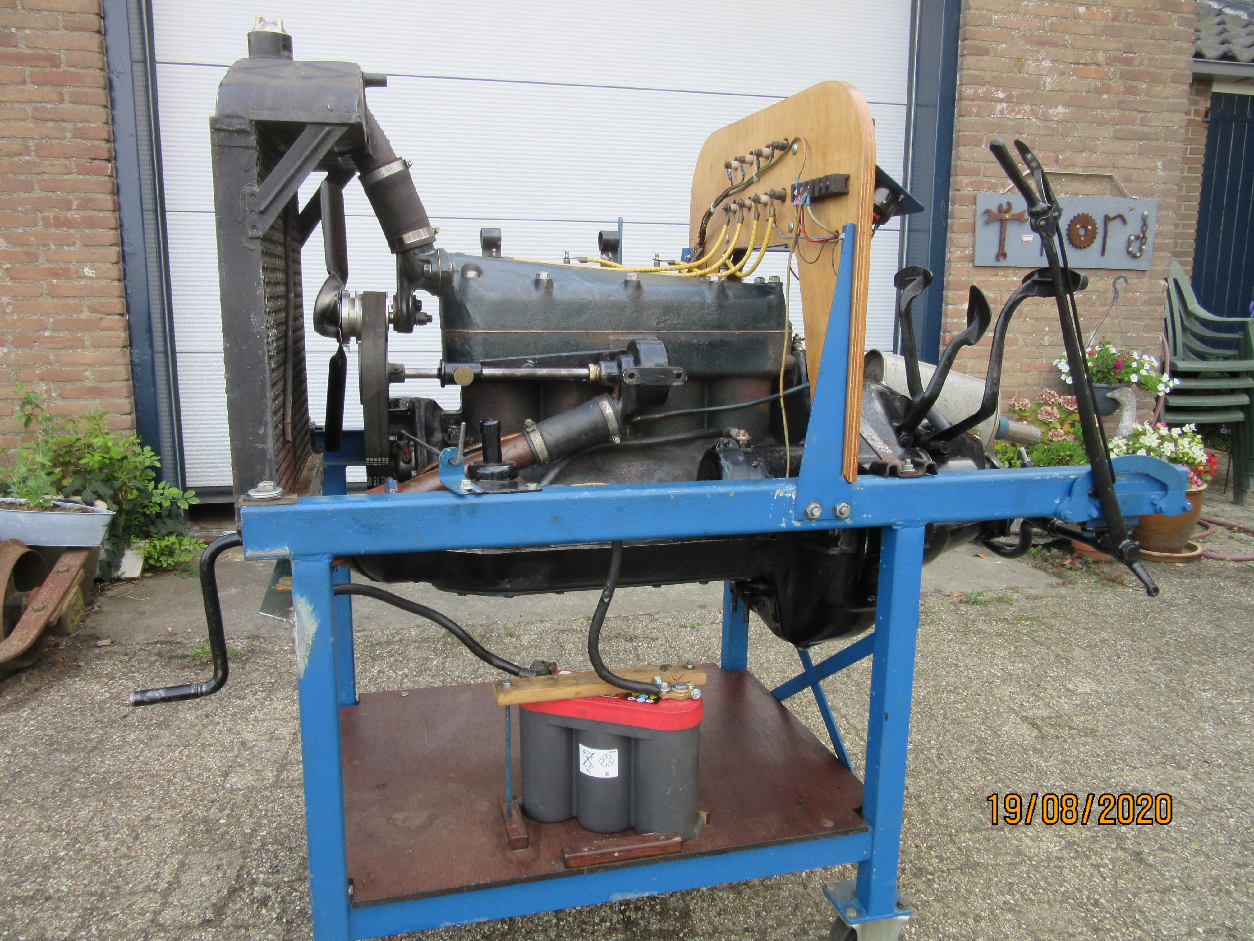

Cory ;
I hope this give you an idea how you can do it . Toon

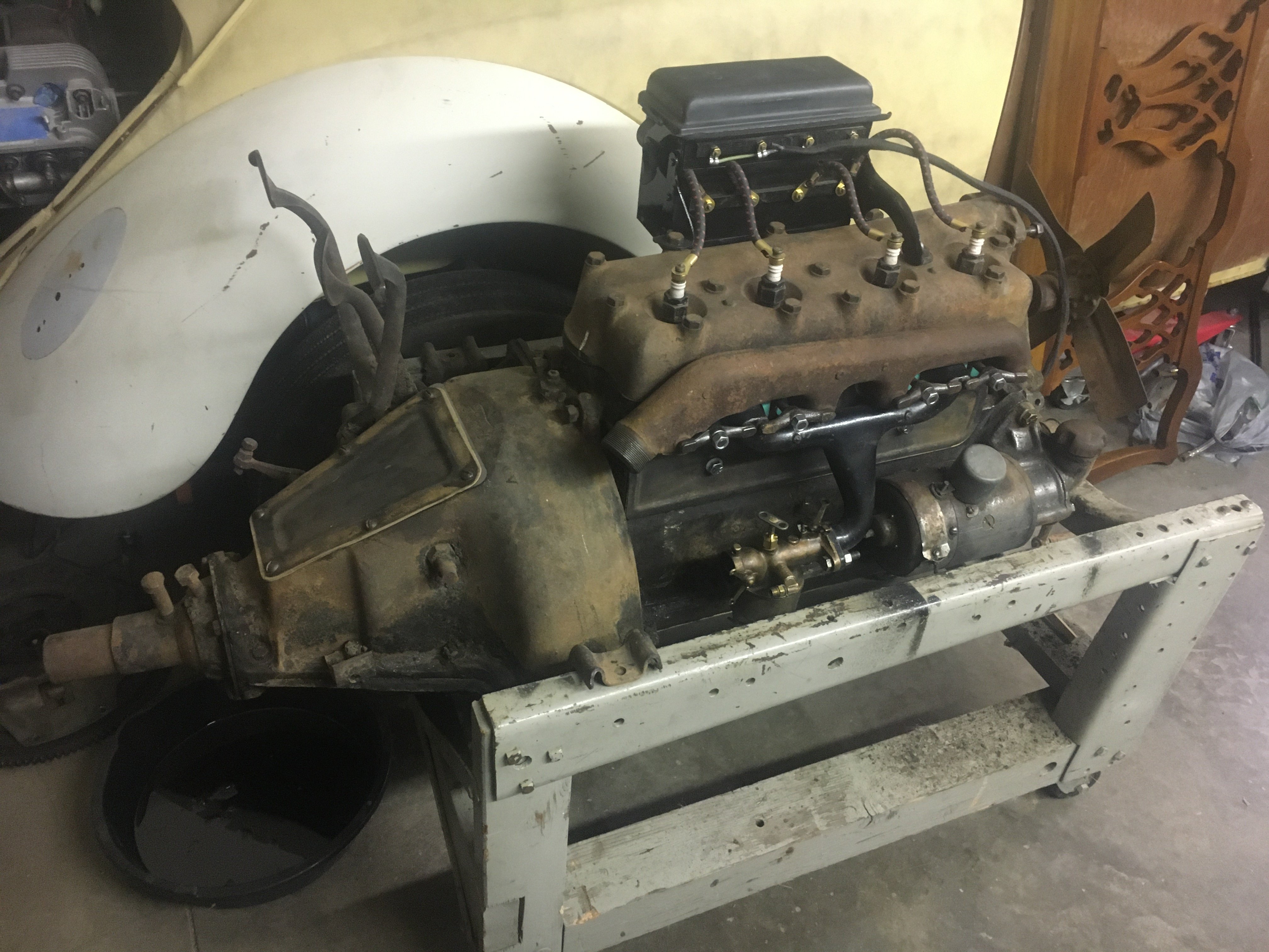

I have a stand that someone had built out of a model t frame. I use a radiator no fan, for safety, so I can adjust the timer as needed and a fuel tank from a honda motor. Bolt the forth main in. After it is running you can test the transmission and brake. It would eventually over heat with out a fan. Sounds feasible to use a hose on a low flow in the block and out the head.
