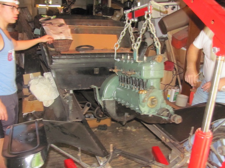

This summer, we pulled the engine on my 1910 Touring. It is a May 8, 1910 build. Open valve, original one piece pan, original head and trans cover. The transmission is a later non starter I installed in the 1960s and is tight and nice. The mag coil stopped working some time ago. I stored the T for 10 years, and used one of my 1931 Model As as vintage transpiration. The 1910 engine was rebuilt in about 1975 and performed very well. We pulled the engine to replace the field coil with one of the nice ones Mark Fleischaker rebuilt. New NOS band set installed and four NOS champion X spark plugs. New wiring. The coil box is one that was on the T when I bought it in 1946 and the box is a 1915 with four NOS coils from 1960. Hot spark and sparks nice and in correct order. The carb is a Ford NH (was NOS when put on in 1980.) The engine popped a few times when we tried to start it a few weeks ago. The head leaked water and we used helicoils on three head bolt holes and now is sealed okay. It will not fire at all. The timer is nice and the setting is correct. Sparks nicely at the pulgs and correct order. We jacked up one real wheel and put it in high. cranks well, sparked well. We primed each cylinder, we choked it, we spunned it over. No firing, no pop, nothing. When the head was off, the saw the the valves seated well.
