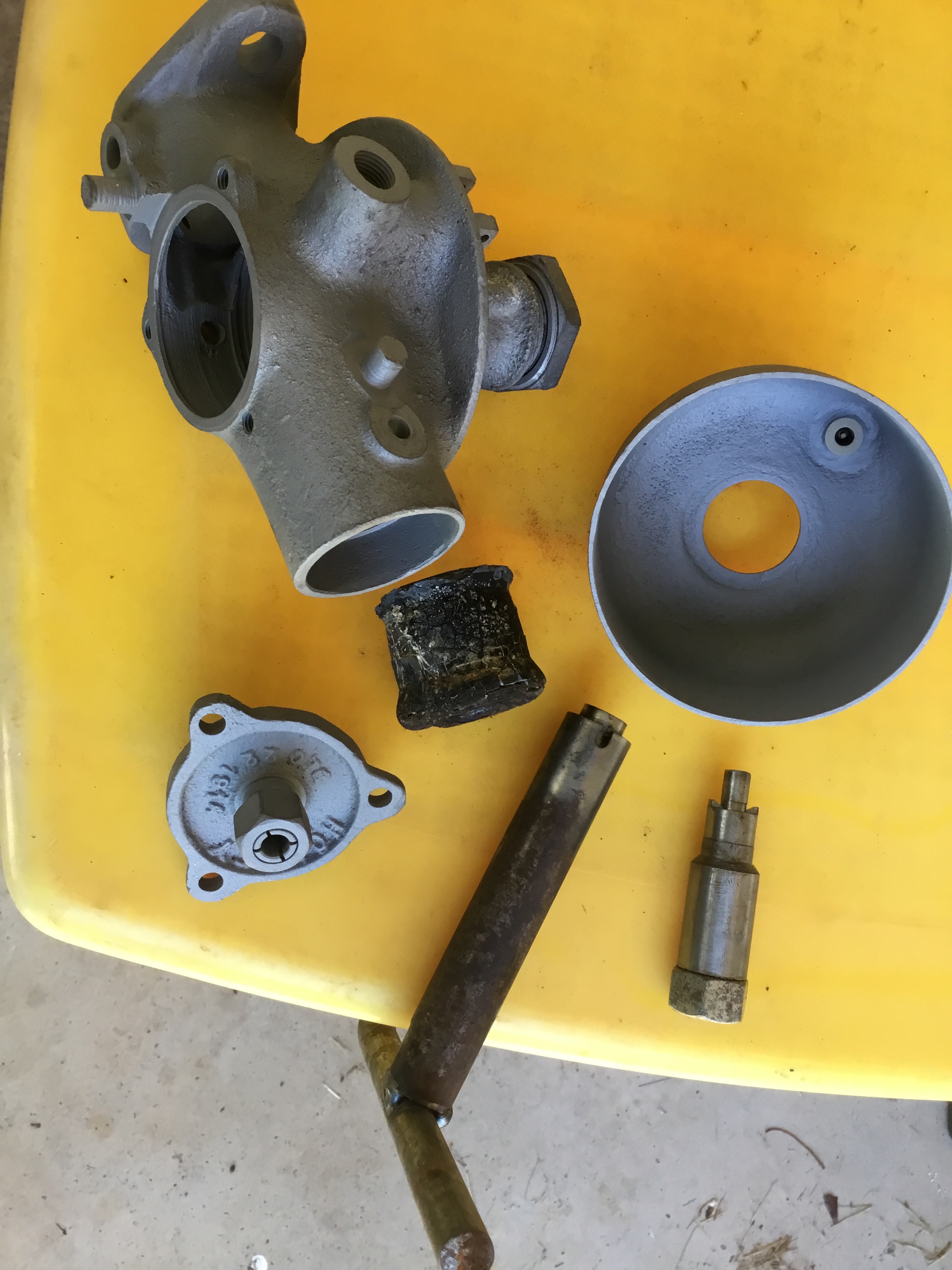

How do I get the black cone out?
I removed the wire keeper, but cone is sure stuck.-

Small bit of flat stock, not as wide as the bottom hole, curved on both ends, and a little longer than the bottom hole. Drill & tap the center for a small bolt, like ¼-20. Another piece of flat stock, long enough to go over the cover hole. Drill the center of that piece for the bolt to slip through. Put the threaded piece into the venturi at an angle so one end goes underneath then allows the other end to drop. Center the piece. Put the unthreaded piece across the cover hole, insert the bolt, and thread it into the bottom piece. Turn the bolt to pull up the bottom piece and force the venturi upwards.
After all this you may find that the old venturi is so brittle it goes to pieces and you have to spend $25 for a new one.

A carriage bolt of the right size can be used to pry the venturi out of the carburetor body. As Steve notes, the part may break easily; they are "pot metal" and subject to decay with age. I've seen some that were solid and sound, but more that were too decayed to be useful. Fortunately new aluminum ones are available.

Chances are it has swollen with age and will get broken when trying to remove. It's not black it's dirty, they were a pot metal and would have been about the color of dark aluminum. Heat will just melt it. You could try good penetrating oil, not WD40. Seems to me someone was just looking for one because they are out of stock.

The MTFCA Carburetor book (which would be a good investment at this point) says to use a long 5/16" carriage bolt. Slip the edge of the bolt head under the venturi and use it to pry it up. Use lots of good penetrant (50:50 ATF and Acetone) for a day or two to loosen it, then pry it out using the carriage bolt.

Exactly, Mark. I've found that characteristic "swelling" is an indication of decay. Don't be upset if you break it trying to disassemble. The "sound" ones I have found came apart fairly easily.

I agree, if they're in good shape they come out easily. If the pot metal has gone bad you will probably need a new one. The upside of that is that it will be aluminum and will far outlast pot metal.

Thanks Guys, had to dig it out. Made a couple of tools to finish getting it apart and all went well after the tube.

It came out in one piece? Cool. This G venturi was easier but it was in pieces.
Any cracking found yet?

After reading the writings of Herbert Franklin (Franklin automobiles, who got his start by perfecting the die-casting process, which gave him the money to start building automobiles) the explanation is fairly simple. Die cast parts are made with zinc. The more zinc in the mix, the easier the part is to cast in a mold. So you can make up for poor molding practice or bad tooling, or poor heat control, by adding more zinc to the die-casting mix.
The problem with zinc is that it NEVER stops changing. It swells with age and changes in temperature and humidity.
The die-castings on my Franklin are perfect in every way, after 94 years. H.H. Franklin knew his die-casting, and he used very little zinc, and kept tight control over his molds, temps, and everything else. The result is very solid and stable die-castings.
On the other hand, I have just taken a Model T AC speedometer apart, (From a 1927 Coupe, that had 30,000 miles on it, and looked like new) and the die-cast support that carried all the gears and drums was bent like a banana. It was obviously a very cheap die-casting. I was told by Russ Furstnow, that AC speedometers were the cheapest Ford could get, and also the worst in quality. They had a very high failure rate, and there was no provision for repairing them or overhauling. They would be thrown away when they broke or jammed. I am looking at putting a Stewart-Warner in to replace it.
The Holley G on my 1914 had a cheap pot-metal or die-cast venturi, and it fractured into pieces when I went to remove it. The new aluminum ones are much better, fit perfectly, and won't swell or deteriorate like the originals. Even if you got your venturi out in one piece, I would throw it away and put in a new aluminum one. They aren't worth messing with more than once.
