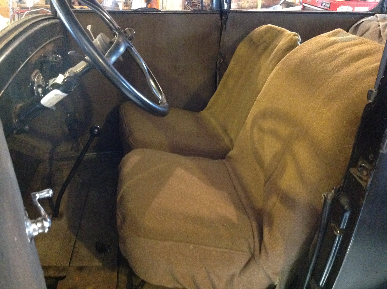

I bought two old US Army wool blankets on ebay and had a seamstress friend sew seat covers.
A coupe seat would be easier.
The blankets were not expensive and I only had to give the seamstress an old cast iron skillet.

Re: slip cover for Coupe bench seat???
Post by Walt Wise » Thu Feb 21, 2019 9:02 am
Mr. Myers,
MUCH Thanks for your reply post!!! Although I am sure Classtique makes beautiful seat covers, here again $500 plus is NOT in my budget for a seat cover! Thanks to others that responded as well, but I have a plan that I think will work for me. My seat covering is still in good enough shape to remove for the "pattern" to make a new seat cover, so I now will search for the best inexpensive material(fabric, blanket, whatever I can find the right color for me) and have the seamstress that I use make a cover that I can then "attach" back to my bench seat. If it turns out good enough to post and not get laughed at, maybe I will post some pics in a couple of months. Thanks again to ALL !!! Walt Wise
