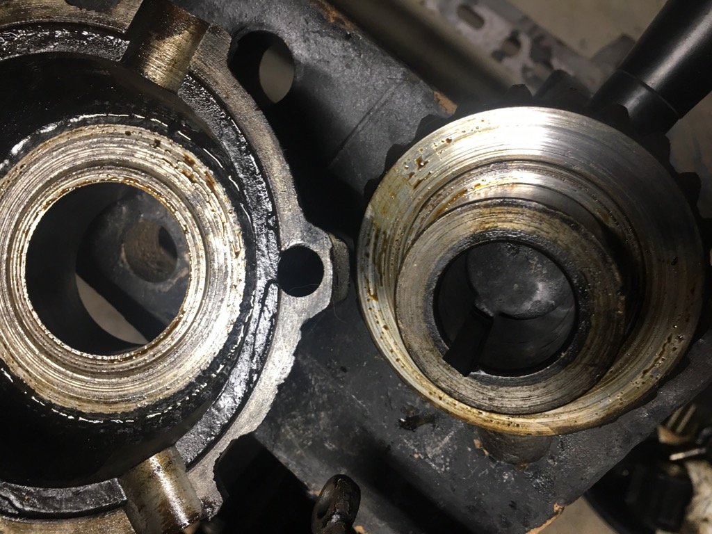

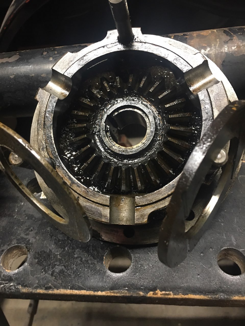

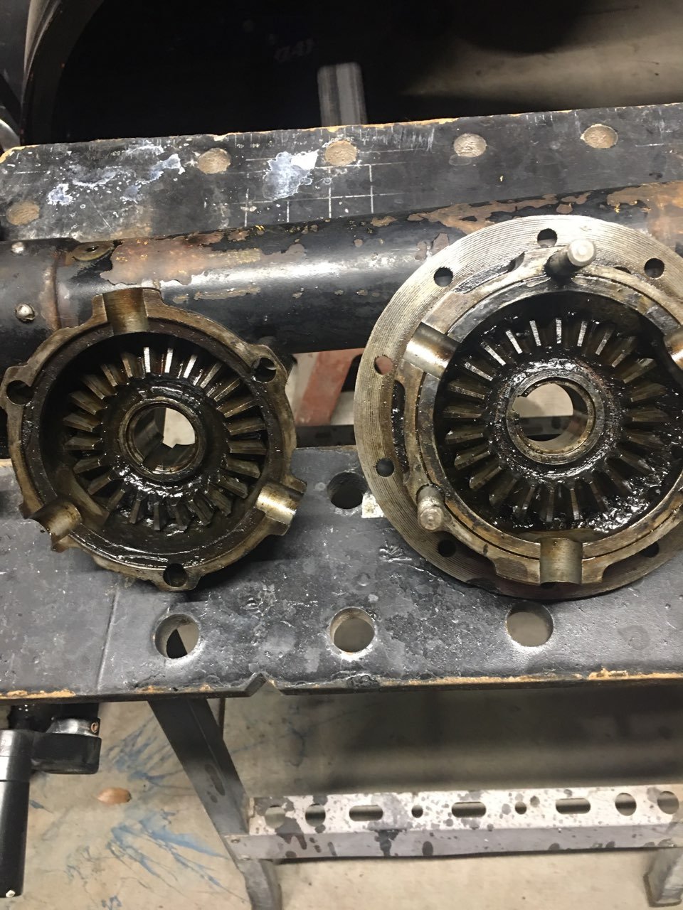

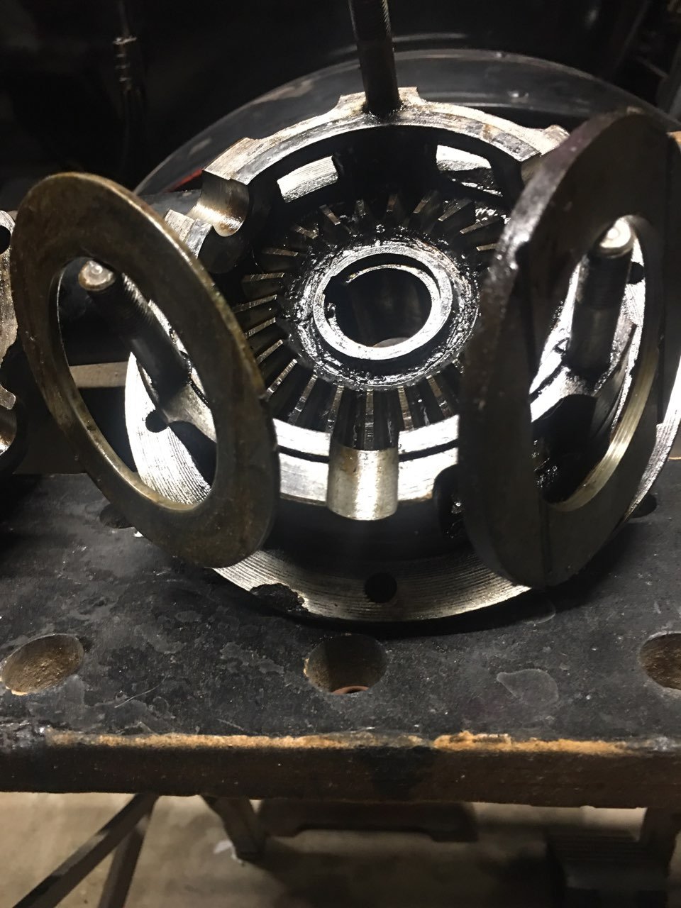

Looking for axel drive gears ! The right side gear in the differential bad and the right top diff cover grooved also, can not get axel out of ring gear diff housing used a plastic hammer on it and my brass hammer did not come out ,the axel rotates but when you hit it it dose not rotate, hit with care. Axel keepers are removed so i cant tell if there is damage to the drive gear or the ring gear. Diff did have babbitt bearings worn on right side, Axel and the wheel would move in and out on the right side , driver side is fine no play no noise from the rear axel! the drive gear #2520 b

Thanks all for info on the2520b gears the right side is grouved realty bad and has a crack at the keyway and the righe difftop cover is grouved also the ring gear side the left the 2520b gear will not come out of the ring gear housing hit medium taps with a brass hammer tomorrow the 2# pound hammer if that don't work i get a bigger hammer it probably will need replacement anyway the rear did not make any noise!!

It appears that none of the parts in your photos is reusable. If the axles were loose in the differential gears it's probable that the axles may be no good either. It should take a lot of force to get the gears off of the axle shafts.
