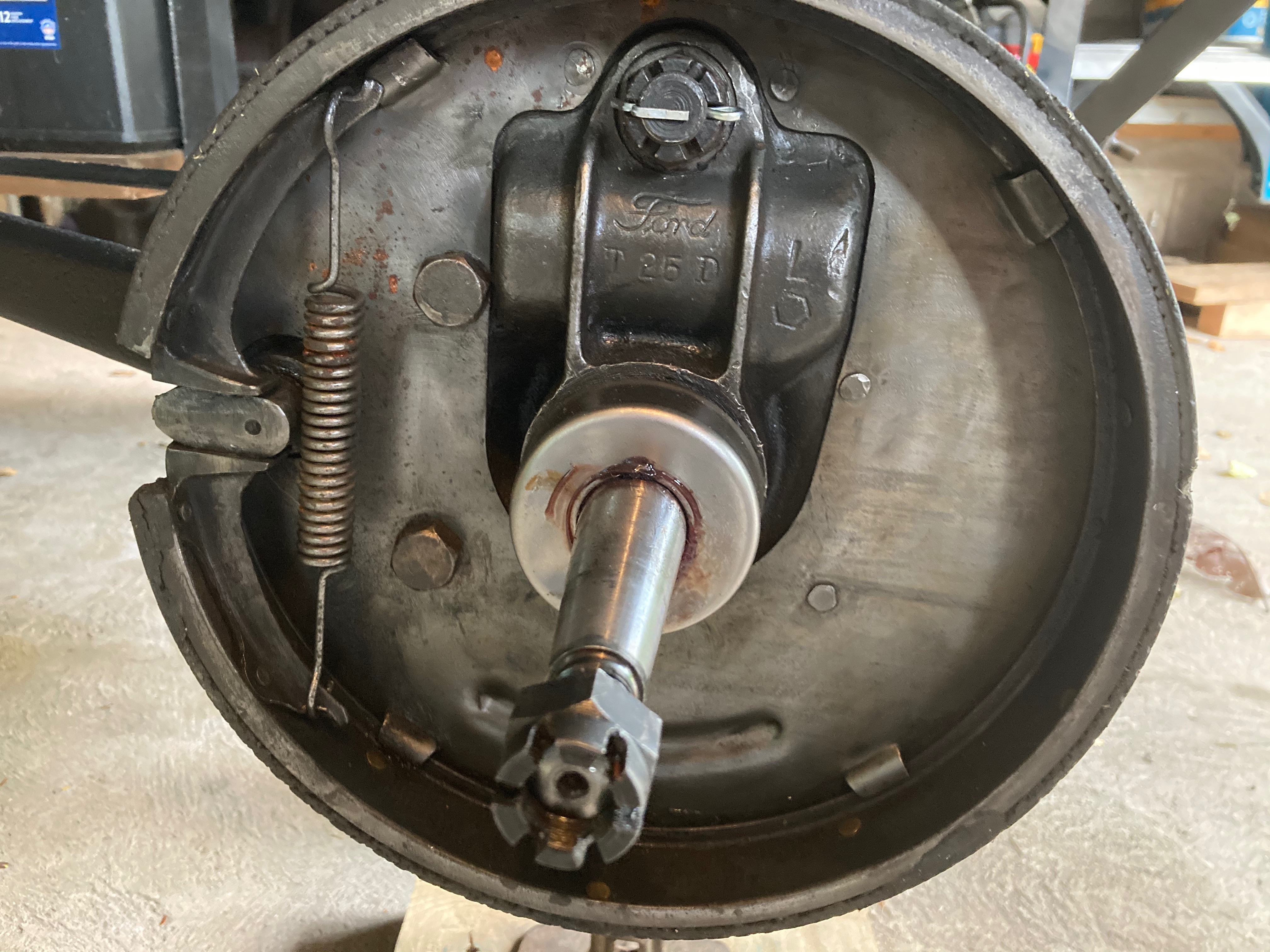

I have a ‘23 with a large drum (‘26-‘27) Ruckstell. I discovered that the drivers side rear hub gets hot after driving. When I removed the wheel to investigate I found that the brake shoe is not being held concentric by the four tabs in the backing plate. There is a lot of play which is allowing the shoe to move around and rub against the drum.
I am thinking that the shoe itself may be sprung and should be a tighter fit in the tabs to restrict movement. The tabs themselves are in great shape and not bent.

As it is now, there is enough play that I can move the shoes in the up or down direction and the linings will over hang the backing plate by an 1/8” or more. It seems to me that if the shoes can move by that much in the retracted position, they would rub on the drum without any chance of being recentered by the drum.

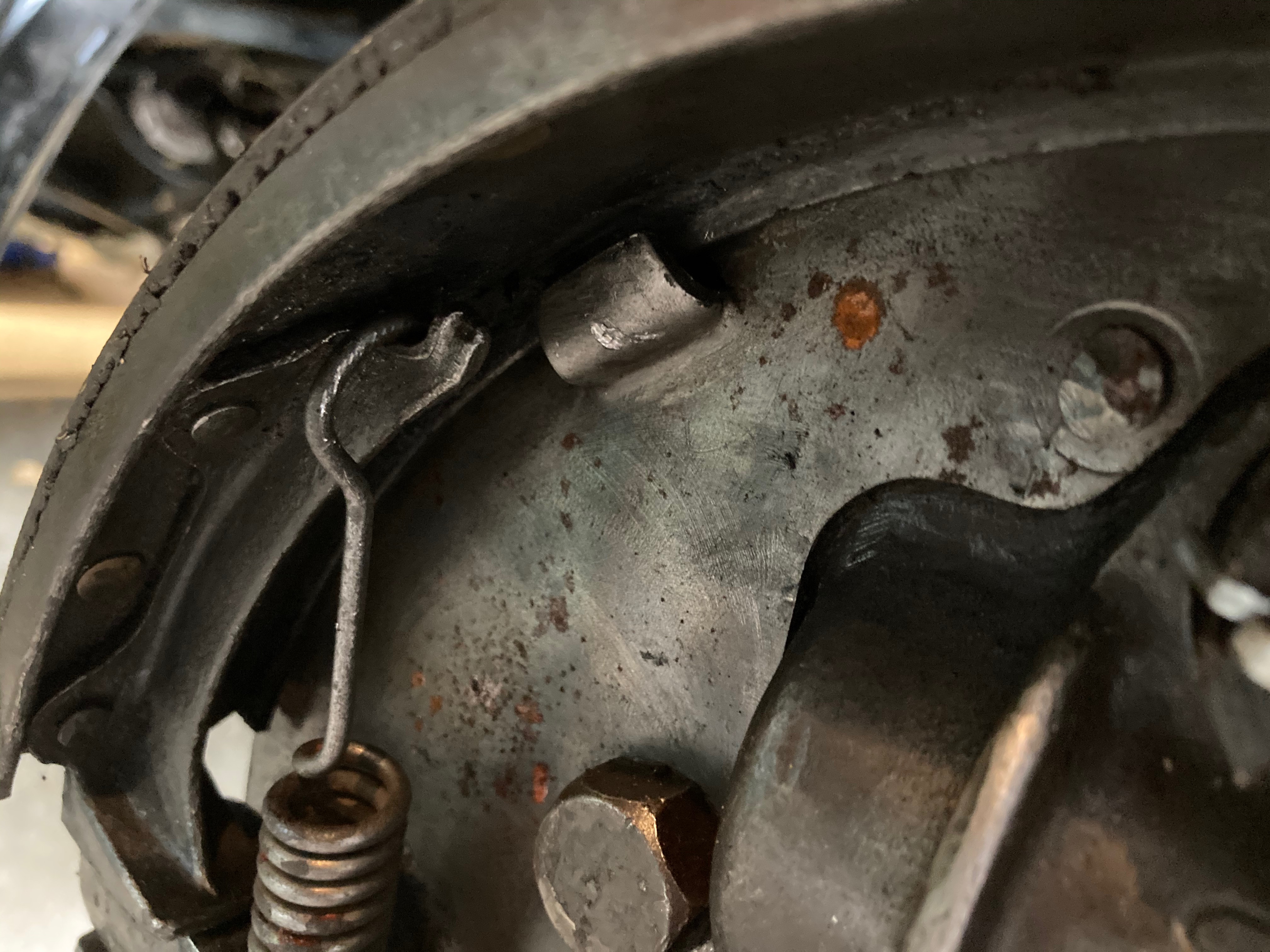

I tried to take a closeup of one of the tabs so you can see how much play is there. This is with the shoe pushed all the way up. I can understand that they float but again I’m surprised it would be this much. I have nothing else to compare it to though.
I don’t know how long this condition has persisted. I went for the first drive after freshly rebuilding the entire Ruckstell and was feeling around for warm spots. The axle housings themselves, bearing areas, etc are cold. Just the drum on the one side. It’s warm but not so hot that you can’t touch it. So this could have been going on for a long time.

Looking at the "rivet job" on the backing plate, it appears those have been "worked over" and the tab does seem be exaggerated.
