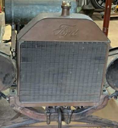

So forgetting the 'drama', are the shorter skirts truly Ford replacement radiators where the wider ones are originals? My '1915' radiator has the narrower apron.
