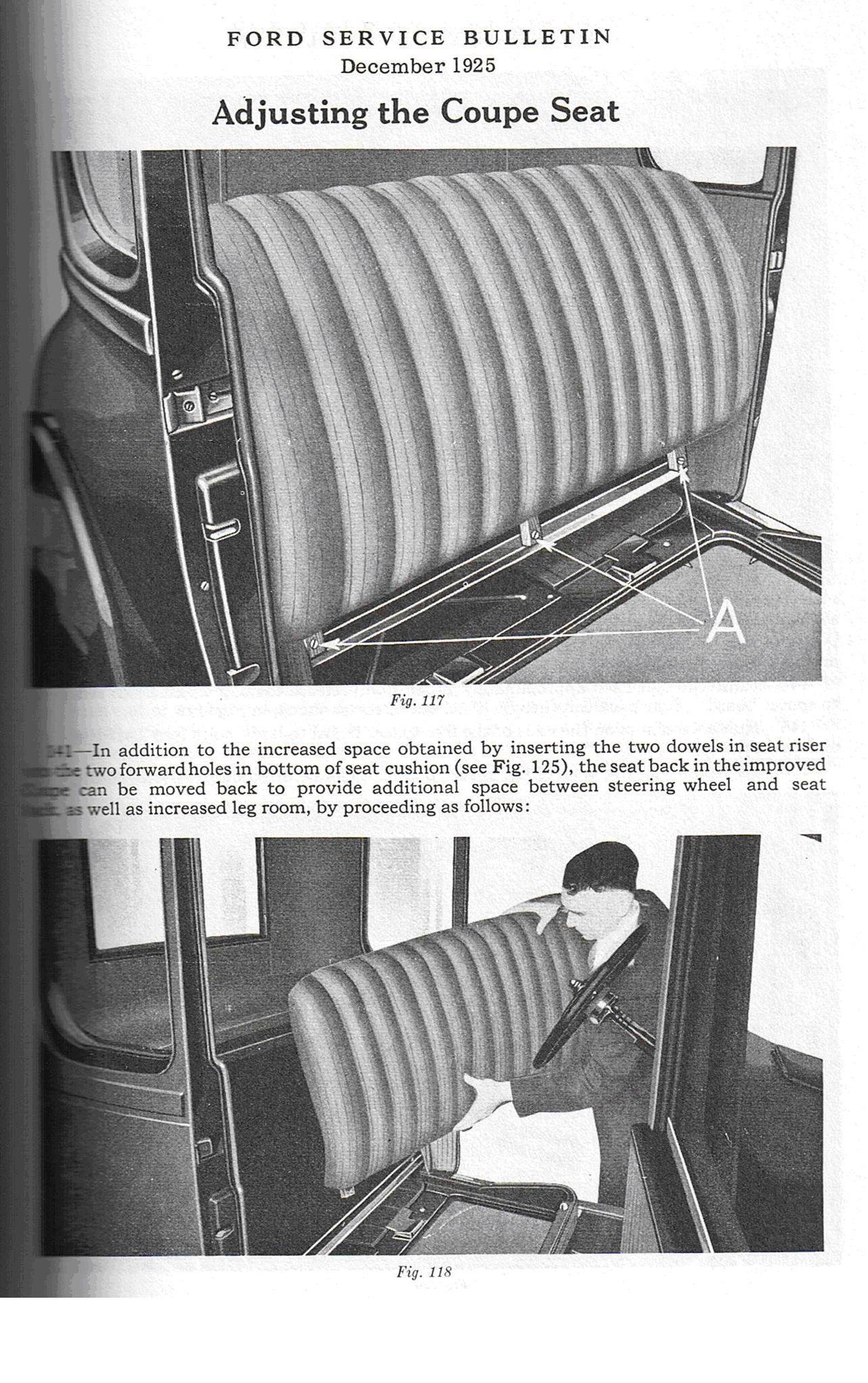

Is it possible to move the driver’s seat back in a coupe for more leg room? One of our club members can’t use the peddles.
- Posts: 4694
Re: How to make more leg room in a coupe?
Depends on what year. If before the 26-27 model, the gas tank is under the seat and you can't move the seat back. If a 26-27 you could do some work on the body to move the seat back, but not easy. It is also possible to remove some padding from the seat back and cushion, or modify the coil springs, but the seat will be less comfortable. Third option would be to have surgery to shorten the legs
The Ford service manual has instructions on how to move the seat back on a 26-27 coupe.

I have a 24 Coupe and it’s tight for a 6’3” guy like me. I don’t see how a big or may I say a ‘portly ‘person could get in one. Probably we are so used to using easily adjustable seats in our roomier cars and trucks it really seems real tight in a T. People back in the T era got use to driving a T did the best they could. The later Coupes had a provision to move the seat back but it wasent much for a big guy whether tall or just big. My 21 Touring to me is a tighter fit but the 3 black era T’s I have are tight. Just the way it is.
Instructions in the Ford service manual shows the improved 26-27 Coupes and the Tudor seats can be moved back approximately 2” or as the manual says you can make more room for the larger than average sized driver.
We started taking bolts out today. It is a 1926 coupe. We are trying to get it back about 4 inches. Will let you all know how we come out. Thanks for all the ideas. Clyde

Clyde,
This may be posted too late to help you, but perhaps it will be of help to someone else with a 1926-27 coupe in the future. I had tried posting this as a link to an earlier posting. But when I click on the link it gave a 401 error or something similar. Since I had it saved, I will repost it here. It all deals with moving the early 1926 and 1926-27 Coupe seat back.
Hap_Tucker
- Posts: 409
- First Name: Hap
- Last Name: Tucker
- Location: Sumter, SC
(continued)
The following is from the Jul Aug 1981 Vintage Ford page 43 used by permission to promote our hobby:
From Don Ball – answering in the column “Questions and Answers”
The [1926-27 Coupe Package] tray was made of wood and was covered with the
same material as used around the rear window area of
the body. …. The holes were not for ‘drainage”
but rather were for the retaining screws which held
the shelf in place. (They used large washers to allow for
the usual lack of precision in body construction.)
Ford had realized by 1926 that people don’t all come
in the same size and had allowed for the seat back to be
moved back for more leg room. The job was not easy;
you had to remove the package tray, saw off a couple of
inches; unbolt the seat and move it back, then reinstall
the whole mess. This procedure is detailed in the Ford
Service Bulletins and is reprinted in Ford Service Bulletin
Essentials (Post Motor Books, 1966) on pages
367-370 and 463. [note page 463 was how to move the seat closer to the steering wheel - so not included]
A drawing of the shelf, as well as the rain gutter is
reprinted here.
See also the posting at: http://www.mtfca.com/discus/messages/80257/81912.html
Respectfully submitted,
Hap l9l5 cut off
