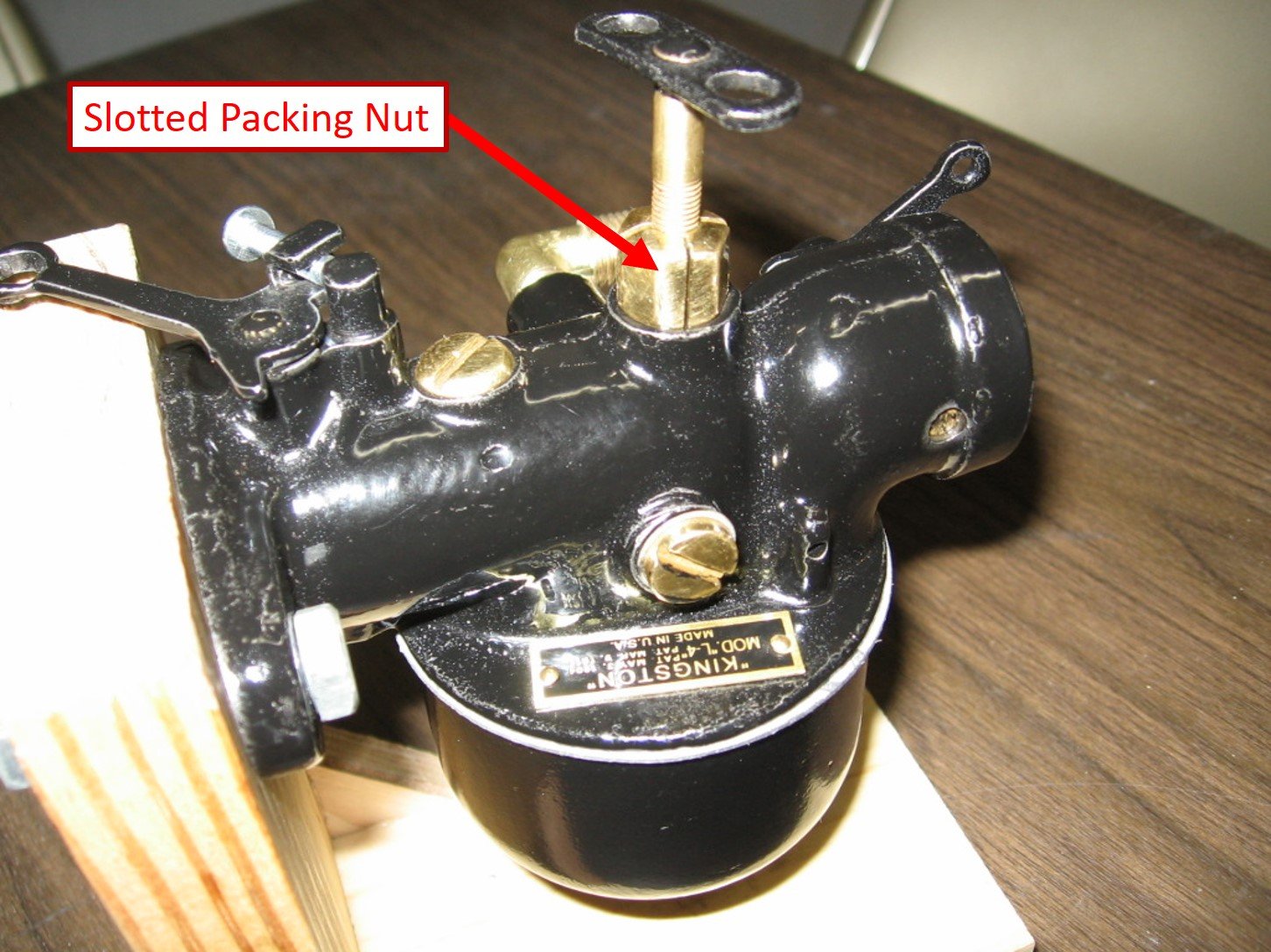

Are you saying that the car dies with more than 1/2 turn open, or the needle is physically stopped from turning more than 1/2 turn open? If it's the latter, there is a slotted packing nut that the needle passes through. Try loosening the nut to allow for easier/more turning of the needle. Don't go too loose or the needle will start turning by itself.
If you want to inspect the needle, loosen the packing nut all the way and unscrew the needle from the carburetor. If the tapered end has a groove worn in it from being tightened too tight, you can dress away the groove like this:
