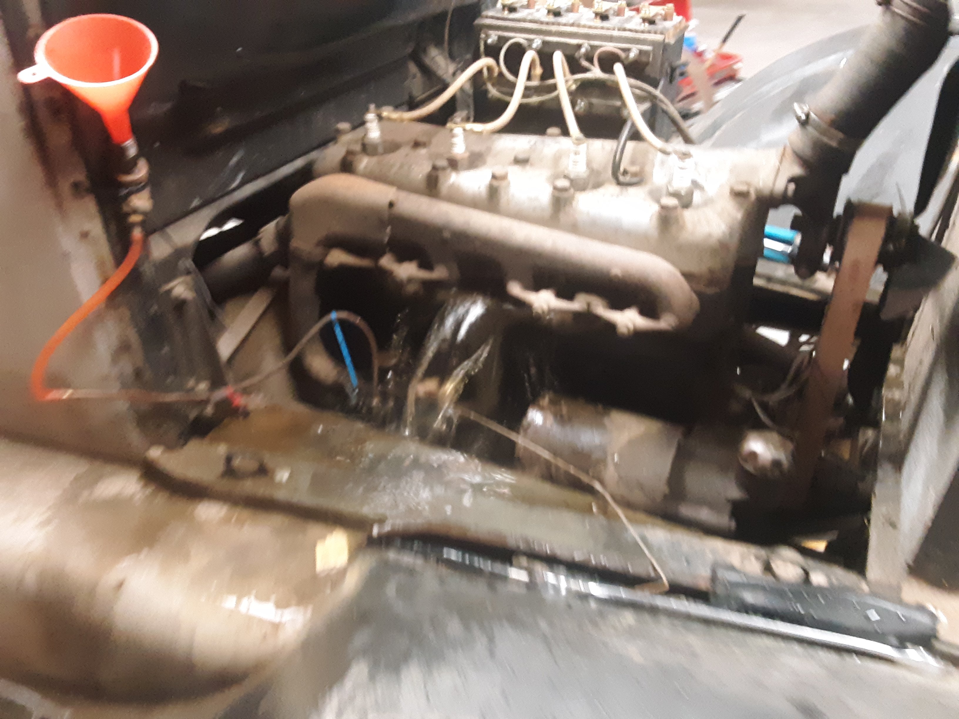

I started up my engine after installing the freeze plugs and the radiator and apparently installed the freeze plugs wrong. Do the freeze plugs go dome in or dome out?

Dome out, then you use a punch just slightly smaller and a hammer and tap the center flat. This expands the plug to seal it in place. Some put them in dry, some use a sealer like ultra black Permatex in a thin film on the edge. Some use a buffalo head nickle that they form a cup in, and then set like a steel plug.

The guy in the video is using steel plugs. Don't do that. They rust. Use brass or nickel. A bit of Ultra Black behind the plug doesn't hurt.

Using the ball end of a ball pein hammer, make your own out of buffulo nickels. Really neat to use ones with the 1927 date of your T. Jim Patrick.

Be really careful with that open fuel funnel setup you have there which is susceptible to sloshing and spilling over from typical T vibration or to a backfire through the carb. Even with a fully functional fuel tank, fires are prevelant in this area so close to the exhaust manifold. A lawn mower gas tank with a lid and copper tube would be a lot safer. In any case, please have a full ABC fire extinguisher right next to you when you fire up your T in case of a flare up. Make sure you know how to use it prior to cranking your T. Jim Patrick
