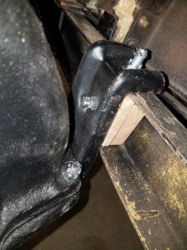

There are wood blocks that support the bolts which mount the oil pan dogears to the frame. Should the heads of the horizontal bolts that secure the blocks in the frame channel, be counter sunk into the wood? Those bolt heads give me fits, by hanging up the dog ears when pulling it replacing the engine. There simply isn't enough room between the frame rails for the dogears, with those bolt heads sticking out. I had a devil of a time getting the motor out, and worse time putting it back in. I forgot that I was going to counter sink them before putting it together, then forgot. 😖

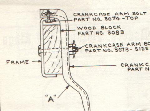

The bolt goes through the hole in the dog ear. I have attached a drawing to show the way it is supposed to go together. Make sure that the bolt at the top of the dog ear is as tight as possible. The one going through horizontally should be just snug, too tight will cause cracking.
I hope this helps

Unless you have a late 25-27 TT truck the stock frames and all stock pan ears have a hole. Use a thin box end wrench and some tape to hold the nut and pre mark the bolt to locate split pin hole up and down. Use long nose pliers to place split pin and bend just enought to hold pin. The picture doesn't show it but the wood block has a champer edge that goes down and to the frame side. This is for the fuel line on the carb side.

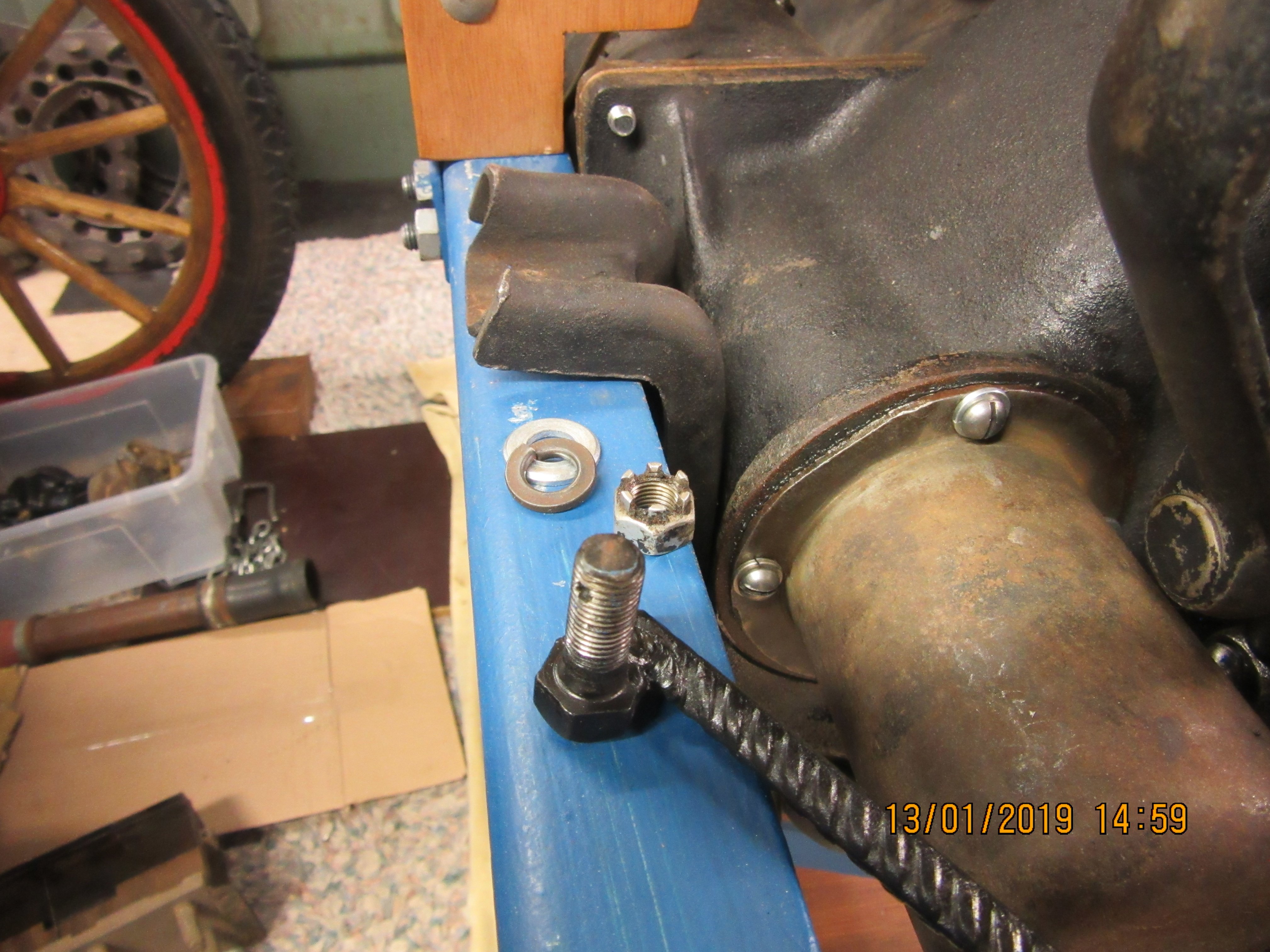

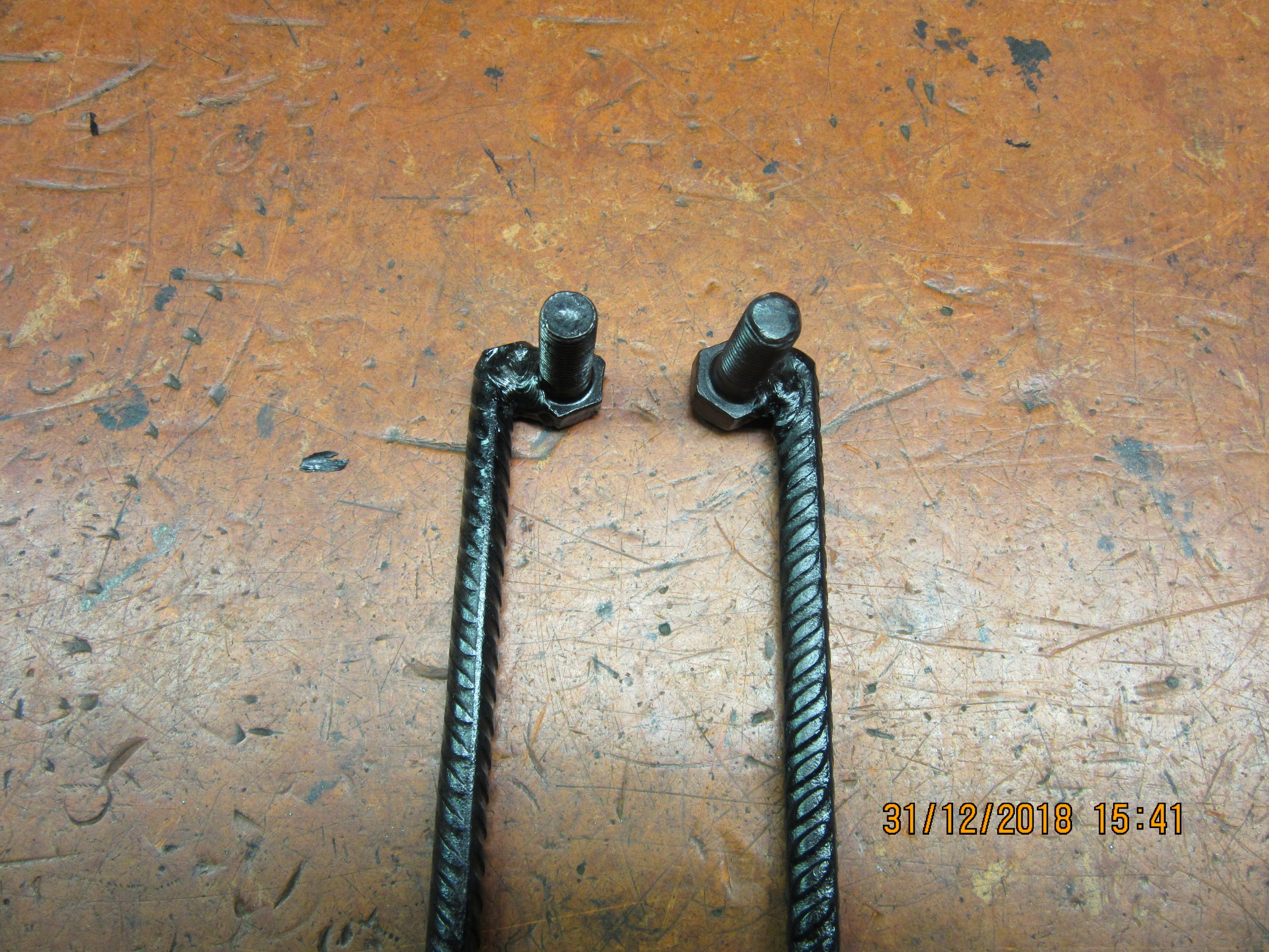

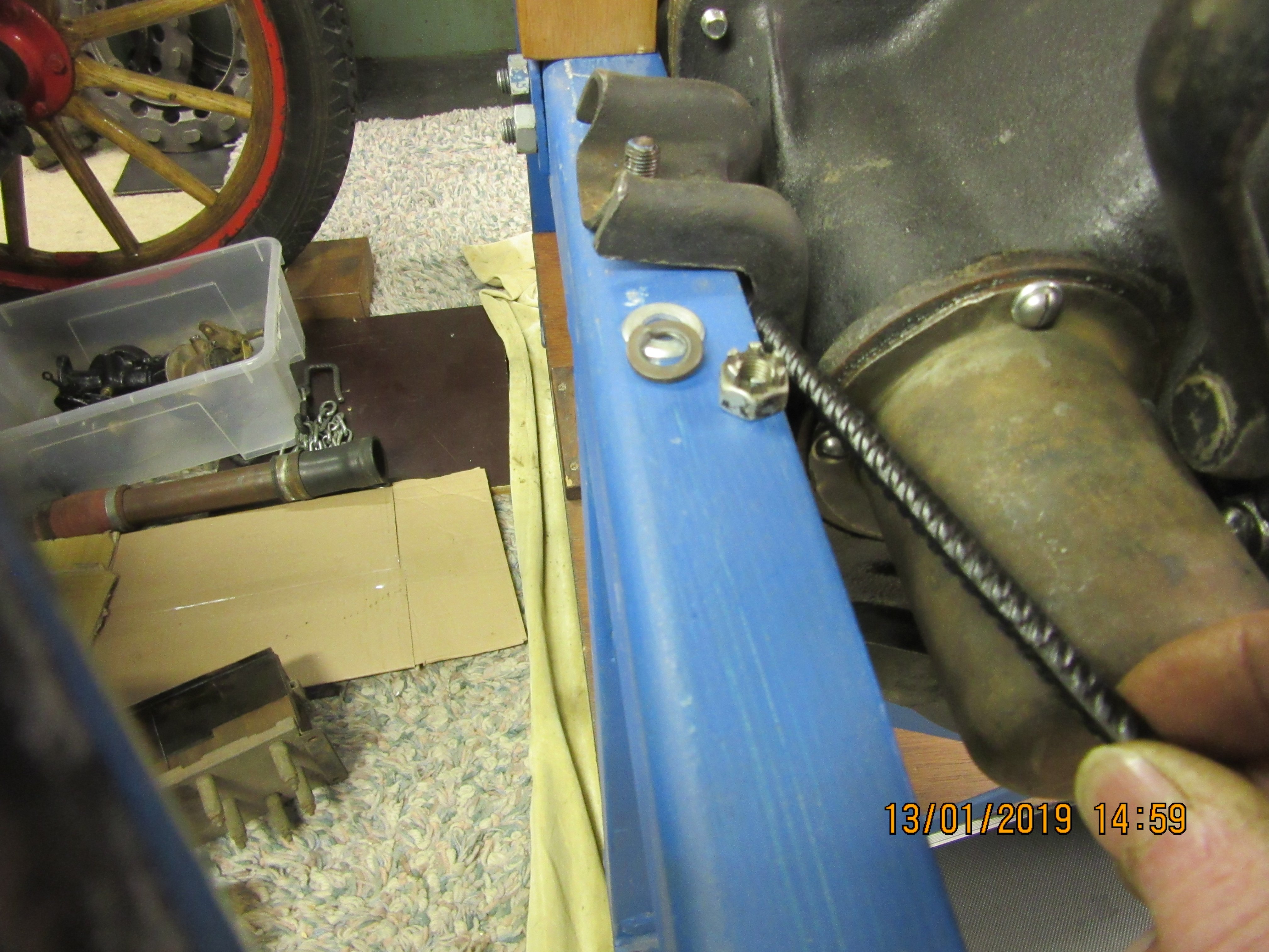

For the top bolts , I use this already for a long time .
Toon

Thanks for all the tips. My problem was I put the wood blocks in the same way that I took the old ones out. I assumed they were put in correctly, and they were not. There is indeed a whole for the horizontal bolt in my dog ears, and most of you probably thought I was crazy for saying there wasn't period ;-) I stand corrected. But, I'm not going to take the engine out in order to put the bolts in correctly. However, I might be able to get one of those all in one tools that cut bolts and trim off flush, with a Long blade to cut off the bolt that I have in there, and then put in a new one properly. There would be no problem on the passenger side getting a nut in between the dog ear and the hogshead. I can't say quite the same on the other side, given the starter housing is in the way. But, I think I have a plan, now!

Turns out, it wasn't all that hard to resolve . Well... Would have been easier if I was 27, an not 67... But that's another story. I removed the top bolts, and removed the nuts from the horizontals that were pit in wrong. Then took an air chisel and cut and knocked out the wood blocks, then removed the 2 bolts and clamp over the nose. I was able to hack the engine up just enough to barely get the horizontal bolts out. Set the engine back down, put the top dogear bolts and nuts in, cut new oak blocks for the frame, and bolted them in. I didn't have too much problem getting the nuts on. Cotter pins were another story! Especially the driver's side one!

Place the vertical bolts first and tighten. Then install the wood blocks. Horizontal bolt goes in from outside the frame, so no need to counter sink into the wood. Tape castle nut in place in wrench and have assistant turn bolt while you hold wrench. Then I wish you the best of luck getting the cotter pin in. I ended up getting a longer bolt with a washer before I inserted it into the frame and block so I could install the cotter pin.
