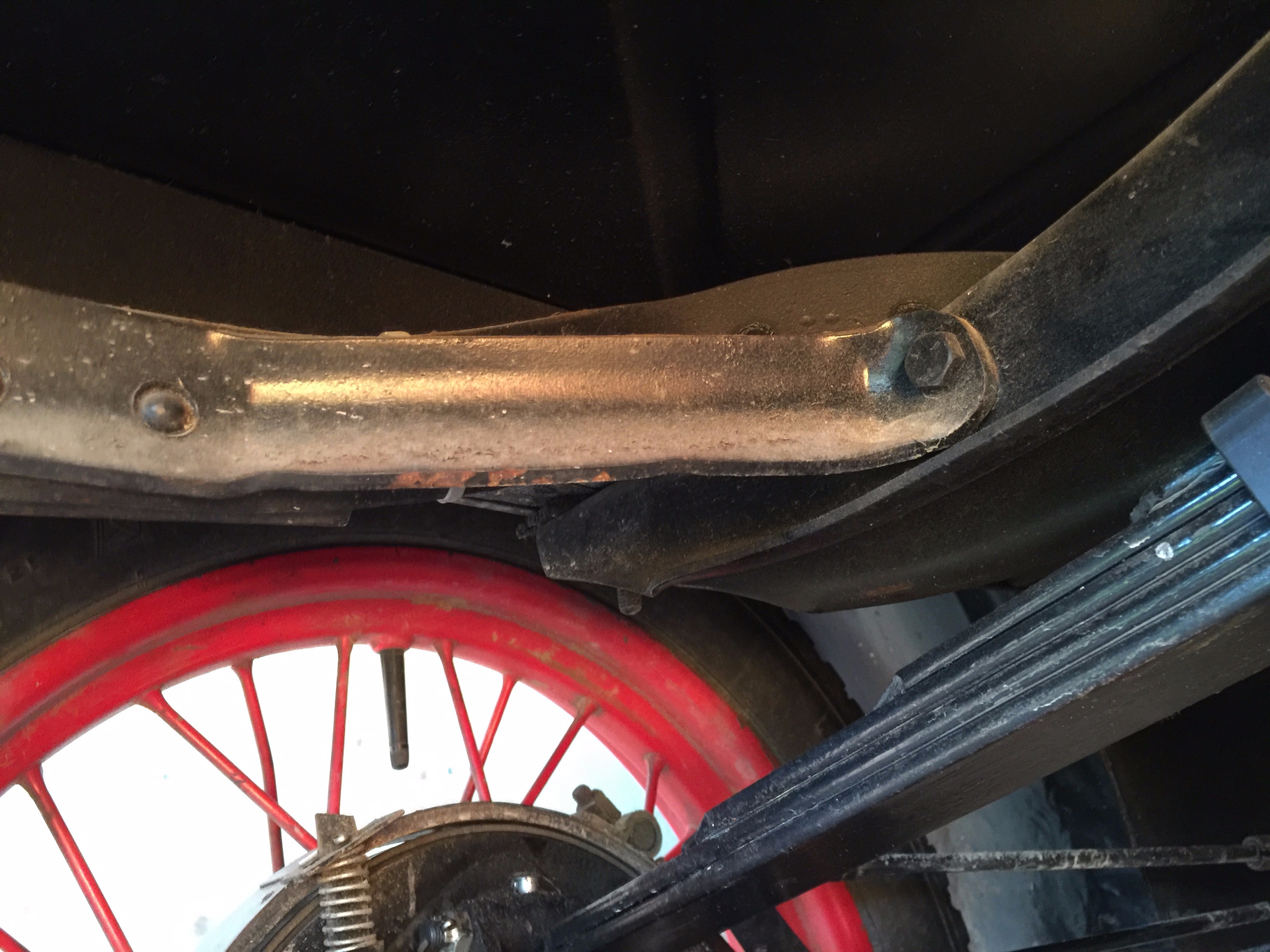

Hi. This is how my brackets are attached on my 1926 roadster.

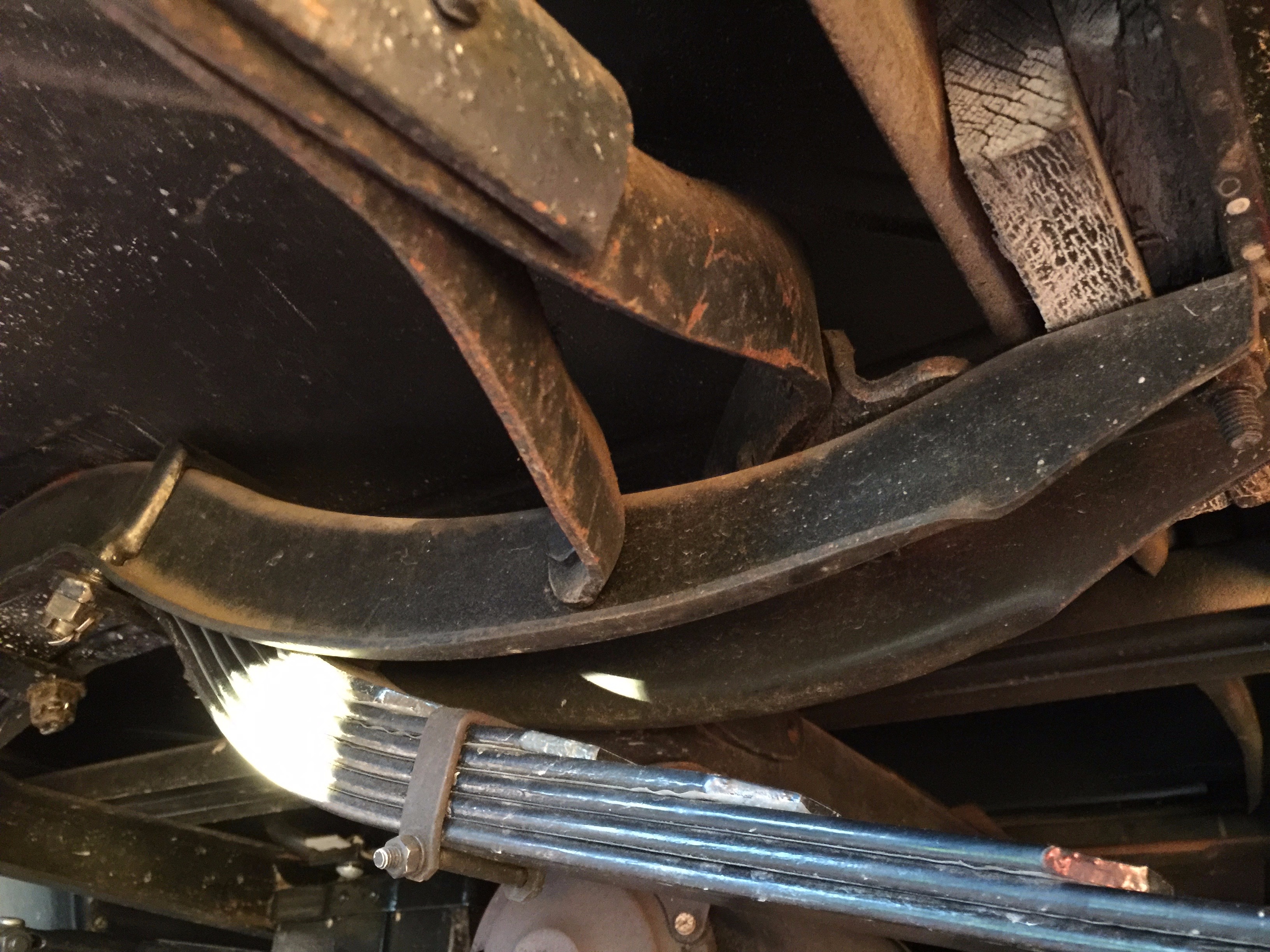

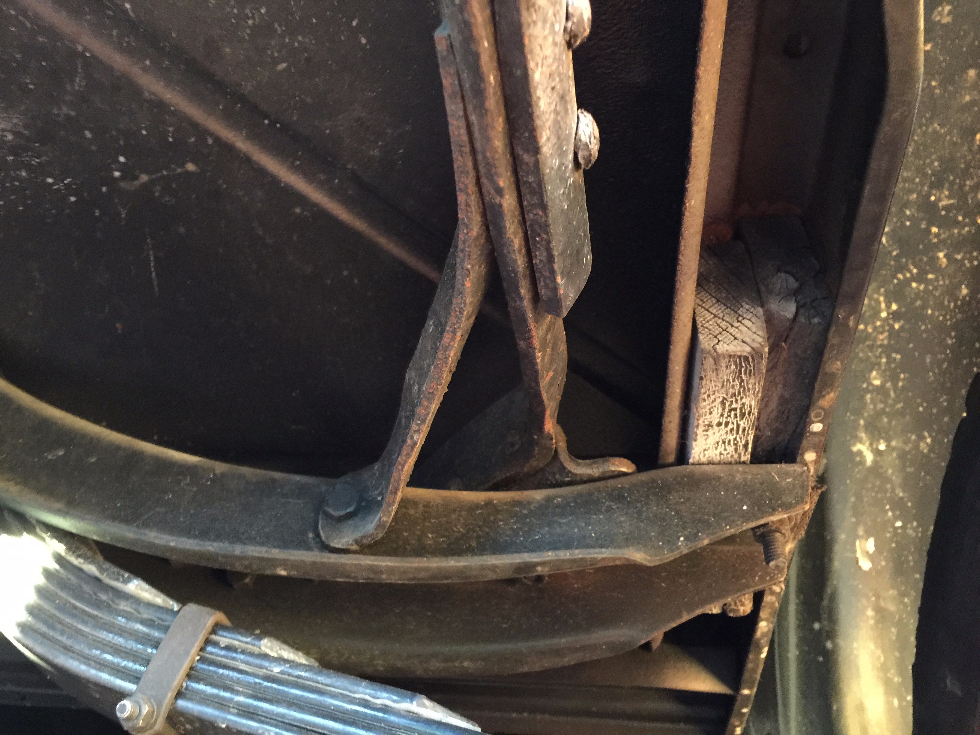

Different rear bumpers with different brackets. The photos are from a 26 that was in storage for 41 years and never dissasembled

Re: Photos of 1927 Coupe Rear Bumper Brackets?
Post by OilyBill » Tue Oct 13, 2020 4:01 pm
Thank you VERY MUCH!!
The last set are the ones on this car!

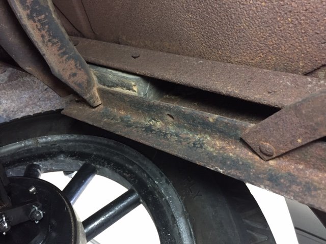

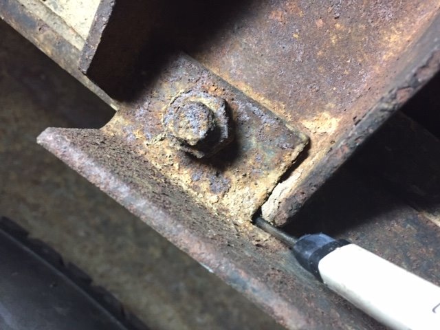

So two with the same brackets .
They do not require any lift of the body - look very closely
at the front of the L angle bracket where it comes in contact with the frame crossover - the bracket is notched at that point so it sits on the underside of the frame crossover - the screwdriver blade is in the notch - you take the nut off the frame /wood block bolt and assemble at the front and work backwards with rear bolts dropping in from the top

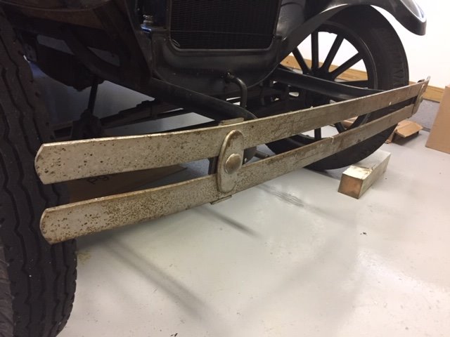

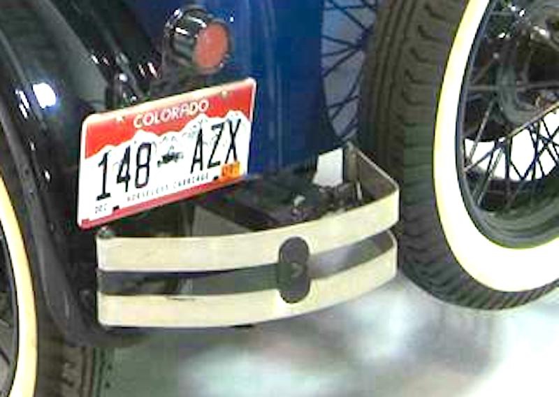

To add to the discussion here is a pic of my front bumper
and links below to Forum 2010:Bumper and a 27 coupe sold at Barrett Jackson event in 2014 . On the Forum 2010 note the Marquette ad in the Ford Service and Field paper.
http://www.mtfca.com/discus/messages/11 ... 1283355195
https://barrettjacksoncdn.azureedge.net ... 62394.html
bumper links http.docx
(10.22 KiB) Downloaded 98 times

Bron
Thanks for posting those links. Pretty clear that the rear split bumpers on the Barrett-Jackson runabout are aftermarket bars, and sure are identical to the Marquette brand.

Post by bron-hertford-nc » Thu Oct 15, 2020 3:28 pm
Right on - so both my and OilyBills are Marquettes , but Marquette was smart enough to design so you didn't have to lift the body, re the angle bracket
notch. Small little thing but made for easy owner or service center installation. And only less than $9. No small change back then, but did the ladies like T's more with bumpers or not? I can only venture that the large skirts of the day were of concern not to get dirty or caught on fenders or spare tires.
