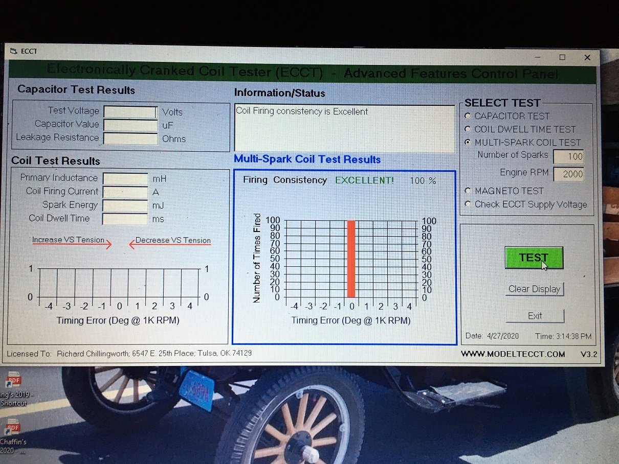

richc
- Posts: 132
- Joined: Sun Jan 06, 2019 6:44 pm
- First Name: Rich
- Last Name: Chillingworth
- * REQUIRED* Type and Year of Model Ts owned: 1924 C-Cab TT
- Location: Tulsa, OK
Re: Coil Testing and Tuning Revisited
Sometimes you're lucky!
Rich C.

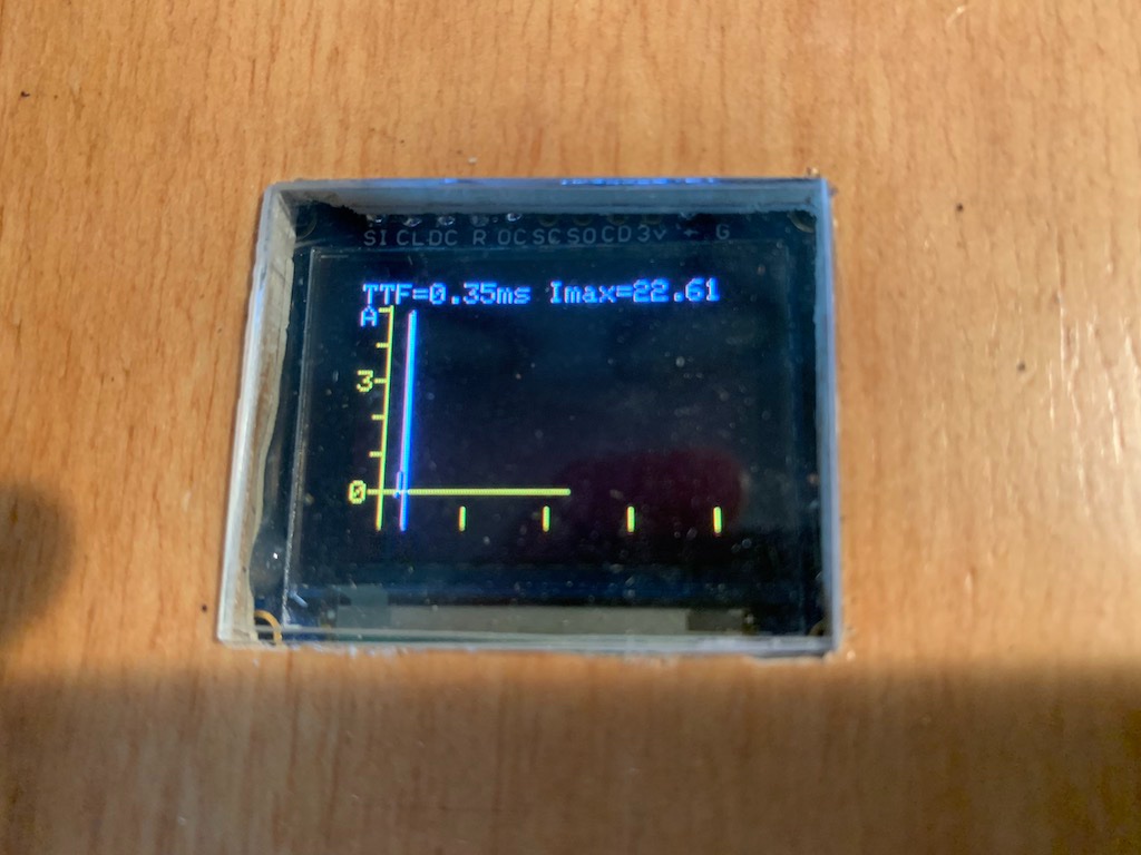

I have an original 1913 coil that I cannot figure out. Any thoughts or help would be greatly appreciated.
Windings measure OK: 3.62 k Ohm
New capacitor: just put in
Electrical connections measure: OK
When tested
No spark
TTF = 0.35ms
Imax = 22A
Any thoughts on the problem, what to try or how to fix it?
By the way since tuning my coils to TTF my cars have never run better - smoother and more power.
Best Regards, John

MKossor
Topic author - Posts: 539
- Joined: Sun Jan 06, 2019 7:30 pm
- First Name: Mike
- Last Name: Kossor
- Location: Kenilworth, NJ 07033
John, can you post a screen shot showing the single spark test result and the multi-spark test result.
Run both tests then press the following 3 keys simultaneously: Ctrl + Alt + PrtSc That will take a screen capture of the test screen that you can paste the screen shot into Word or Paint then save as a .JPG file that can be attached to your post by clicking on the Attachments then Add files button. You can also paste the screen capture into an email and send it to me ( mictel@comcast.net ) for review and comment.

Mike, thanks for the reply. Attached is the screen shot. I am using an Arduino based DIY TTF tester, based on the forum postings. Currently the multi spark is not working as I need to add some EMI shielding. I have refurbished the 3 other coils that came out of a relatively untouched 1913 coil box without issue. This one is being stubborn. Comments and suggestions appreciated.

John, thanks for the screen shots of your coil test results. I'm not too familiar with the DIY TTF. If the measurement is correct, 22.6A in 0.35ms indicates a shorted (low resistance) primary coil (inductance well below the 0.0033H) which would result in high DC current that is reached very fast (0.35ms) OR bogus result to EMI/Noise. Can your power supply even supply 22.6A? The saturated DC coil current is approximately 7A to 8A as I recall and takes about 2.5ms to 4ms to reach if the coil primary winding is good and the secondary winding is not shorted. The primary winding resistance measures about 0.3 Ohms and the secondary (high voltage winding) measures around 3200 Ohms.
