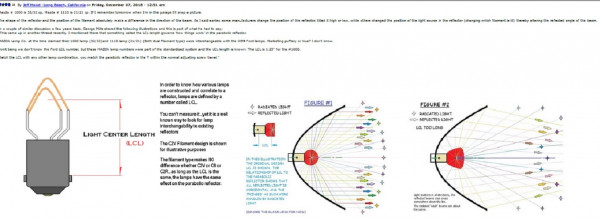

The answer question all depends on your intended power source 6v, 12v magneto. Do you have a single (BA15S) or double contact (BA15d) bulb base? The BA15 base (1156) (Model T socket) has its contacts on the bottom and 2 parallel lugs on opposing sides of the base 180 degrees apart. Sometimes these get confused with the BAY15 style base (1157) which has its contacts on the bottom but its lugs, while parallel, has one higher than the other.
Now for the technical part - the concave reflector is expecting a near pin point light source a short distance from the socket called a focal point, (picture the incandescent bulb) to project light. If you look into a good reflector you can see almost tell where that is - a clear ring towards the back of the reflector. Most LED bulbs have an array of led chips in various configurations - with few if any that are located near the focal point. Some have some chips projecting outward that give the appearance of a brighter headlight when looking at it but do little to light up the road ahead (these are good for daytime driving lights). The other factor that make LED lights look "brighter" is their color temperature. Conventional bulbs are warm yellowish about 3200K with LEDs (most are white light) at about 6000K. So whiter light makes things look brighter. Lots of discussion in this posting about incandescent bulbs that is directly applicable to LEDs http://www.mtfca.com/discus/messages/82 ... 1544665848
The attachment can be viewed larger by clicking on it or browsing the link

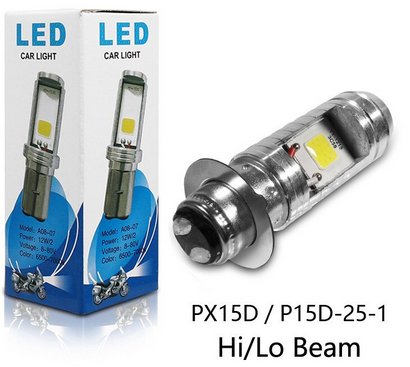

Over the past year I went to some trouble to locate an [inexpensive] LED replacement for the tungsten filament bulbs in my T. I wanted to use LED's for the low(er) current requirements, which meant I could reduce the generator charge current and save the battery from cooking, amongst other things.
While there were several LED recommendations from various people on this site, the cost by the time they arrived in my country made them more pricey than they should be, and I was convinced there was a better way.
To that end I purchased a number of LED headlamp bulbs via suppliers in China (which is probably where they mostly come from anyway). The difference in what I bought, and what is supplied specifically for the task, was mostly around the base type.
I had decided that I could likely use LED's originally intended for motorbike headlamps, with a suitable modification. The P15D base has the same diameter as that required for the Model T, but it uses a flange rather than two locking pins to locate it in the headlamp proper. I thought it should have been possible to remove the flange and solder a couple of pins in the correct place so that it could be installed into the T.
As it turned out this little exercised worked even better than I hoped. It took just a couple of minutes to cut off the flange with a pair of sidecutters, and solder a couple of short pins in the correct place on the base.
Although I can't, unfortunately, use my T any more (because the motor has packed up) I have installed these bulbs in my Model A and find that they work very well - the light output is good, and they focus reasonably. I would expect the same in the T.
Here's a photograph of a converted bulb, apologies for the poor image:
A couple of things to note:
(1) I have converted my T (and A) to 12V (and the A to negative earth!), the bulbs I used have an 8-30V rating so they may work on a 6V car, or they may not. (similar 6V LED bulbs are available however).
(2) The photo above is of a bulb type that I ultimately rejected for a better one (which is currently in the vehicle). I show it simply to demonstrate how I did the modification. Below an image of the one I presently use, the cost was $1.82USD each:

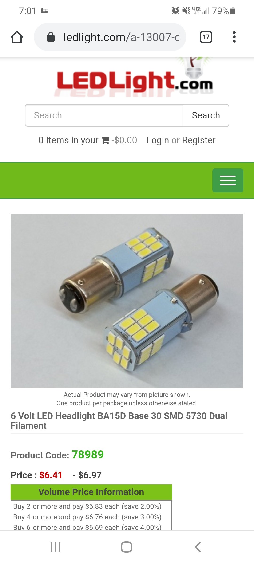

Take a look at https://www.ledlight.com/6-volt-negativ ... spx?Page=3. Specifically look at product numbers 87455 ($7.49) and 74475 ($17.47). I have the 87455 installed on my T, but can't make an assessment of effectiveness at night on the road as I haven't yet driven it. They do fit perfectly in the original sockets and the high-low beam function works fine. In the manufacturer's description, particularly 74475, they claim the LEDs are positioned at the same location as would be a conventional filament. Sounds good but whether true or not, I don't know.

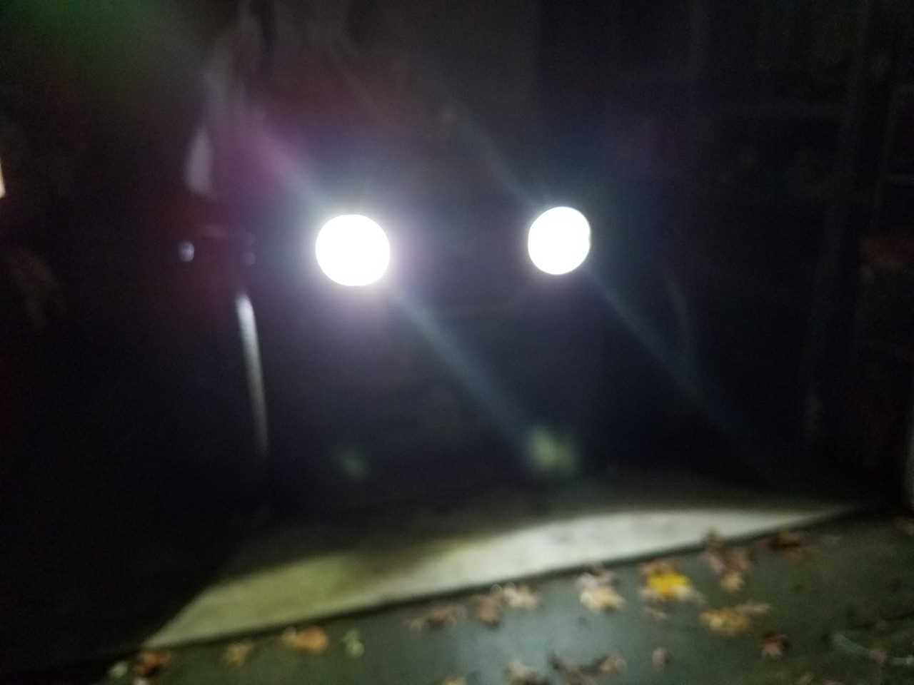

LogoLites, installed them the other day and test drove the T that night. On my T @ night it WAS a big difference, night and dayJim Eubanks wrote: ↑Wed Oct 14, 2020 5:02 pmSo, the bottom line to all this is that there is no off the shelf LEd bulb that will fit a T with 6v system?
No pun intended fellas but those vender available crappy, hot amp drawing china bulbs are no match for the LogoLites 1amp LED's. I can now actually see a difference between ON and DIM. Just my findings and result for my T. Good luck and don't over think "the light".

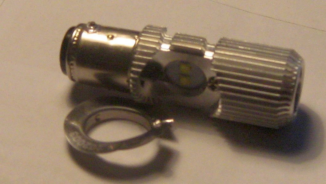

I have used this direct replacement 6 volt bulb made for a model T with elevated elements. The amp meter used to run about 10 amps on bright now You can barley see the needle move. Another LED bulb that looks promising for head lights has four tee pee pole type elements. It looks more like a regular headlight bulb. would replicate a 12 volt model T headlight and focus but would need small 12 volt battery for power.
I like the barrel type bulb. works fine made for 6 volts no focus problems that I have found. use a pair on My 6 volt open express. Then there is the wedge bulb very very bright. too bright for on comming traffic. The Tee pee led 12 volt only and not made with parallel pin base needed for the headlights. comes in 1156 & 1157 base. but You could grind one pin off and improvise base mounting. I use the barrel type bulb in My open express and have tried the wedge which has a funny c or U pattern and way too bright. but not the tee pee which I think would be the best one if made with parallel pins but still great for tail lights,turn signals and cowl lights

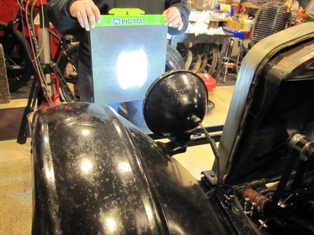

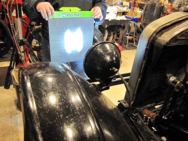

Some pictures of the middle rectangle bulb reflecting off a pad to show the reflection, the first is DIM and the last is ON

Scott, I have a similar headlight bulb in our 26. What are your steps for proper focus with these bulbs?.... Rather what is your experience with focusing these bulbs. No intention of negativity, but I've had a problem as far as going with the focusing procedure in the green book, and I find myself adjusting so that the socket is pulled back in the headlight as far as it will go and then adjusting the headlight buckets at night using a predetermined spot on the road where I would like to have the headlights give the most brightness. That's brightness on the road, not in the environment. I don't know maybe that'll help you, I'm looking for your experience. Thanks

- Posts: 7133
Re: Direct LED replacement headlight
Scott, your photos of the light beams produced by the rectangular bulb illustrate a problem with LED bulbs. I presume you are holding the board and someone else is operating the switch. The only difference in the two beams is the amount of light generated. Both beams have the same orientation.
With a twin filament incandescent bulb, the low beam filament uses less current to dim the light, AND, it is differently oriented to the high beam, so it is reflected downwards also.
The parabolic reflector used in conventional lights relies on pinpoint light sources to accurately reflect the light as required. Light from LEDs is directional. Multiple LEDs facing forward and arrayed around the bulb to get light pointed at the reflector can only approximate a pinpoint source.
Hence the light reflected only approximates a beam. Rather, it is more like a floodlight, the intensity of which can be most disconcerting to oncoming drivers.
Personally, I do not like the appearance of the bulbs when not lit, nor the colour of the light produced when they are lit. Nothing looks more out of place in a lamplight parade than a brass T with LEDs among actylene lit lights.They just don't sit well with the character of the vehicle, much like chrome plating rather than nickel, and metllic paintwork. Others will have differing opinions o these.

Terry, as far as the base is concerned they are the same.ModelTWoods wrote: ↑Mon Oct 19, 2020 3:58 pmSnyder lists LED replacement headlight bulbs for MODEL A's in their catalog. Are the locating pins the same as a Model T? Would they work?
In terms of the business end, the Model A has a 50/32 CP (Candle Power) bulb, the Model T manual "Answer 116" states the headlamp bulb (for a vehicle with a starter) is a 17 C.P. bulb.
In practice the more modern bulb will work (whether it's a good idea or not); I'm looking at the tungsten filament bulbs from my Model A and Model T right now and they're both the same (50/32). However that's the way they came to me, 90 and 94 years from new, so they've probably had the odd bulb replacement in that time!
Interestingly, early treatises on headlamp bulbs discuss 16-25 C.P. lamps as being the standard of the time. Heat was consideration for them, especially with "large candle-powers (25 or 30) ... ". Later documents, with input from Ford, talk of 21/32 "candlepower sizes".
Personally, with the LED's I'm far less concerned about heat, wiring and charging issues, so the question as to whether one should use a 50/32 in a T isn't one that's exercised my mind. What did concern me was the placement of the (LED) light source so that it would ensure the most correct light output possible.
To that end, and given my background, when testing the LED's I considered the standard stating that "The light center [sic] length for all incandescent lamps for in head lamps for either electric of gasoline propelled vehicles shall be 1-1/4 +/- 3/64 inches, as measured from the center of the filament field to the bulb side of the lock pins in the base. The longitudinal axis of the lamp filament as the focal point shall not deviate more than 3/64 inch from the axis of the lamp base". Although they provided a reasonable light output in terms of ability to drive, the LED's I rejected had a light centre length of just 1"...

Yes there is i purchased 6v led lights for my 22. I have attached the website and part number i used

I ordered the same ones. Should be here in the next day or so. I'll let you know how they work

OK Guys,
I received my LED "bulbs" yesterday. Please find attached make and model. They are a direct replacement and fit exactly as a traditional bulb would. I installed them this morning before work, and they work great.... The picture shows the result, fyi, they are running off the 12V battery and are wired in parallel

Hey Robert just got back after being away for work so....Experience focusing these bulbs, no sir. I have fresh strings or headlight lens door gaskets and clean H lenses. When I drove this in the evening I really did not look @ the direction or focus of the light as it related to the road.Moxie26 wrote: ↑Mon Oct 19, 2020 10:28 amScott, I have a similar headlight bulb in our 26. What are your steps for proper focus with these bulbs?.... Rather what is your experience with focusing these bulbs. No intention of negativity, but I've had a problem as far as going with the focusing procedure in the green book, and I find myself adjusting so that the socket is pulled back in the headlight as far as it will go and then adjusting the headlight buckets at night using a predetermined spot on the road where I would like to have the headlights give the most brightness. That's brightness on the road, not in the environment. I don't know maybe that'll help you, I'm looking for your experience. Thanks
What I did notice was a huge difference with what I could see versus those 6V double contacts available. The difference in temp is huge the LED's stayed cool and constant, glass bulbs heated up instantly. As I noted also can actually see the DIM and On increase and decrease.
Currently I have the headlight focus screw in the socket just protruding enough to get that cotter pin in, they seemed to be straight ahead and not glaring @ on coming traffic or shining into the woods. Will look again @ "proper focus and use the garage door as a reference.

Thanks for sharing Scott... My latest experience in " focusing" and beam distance is now with the bulb holder position closest to reflector and the whole headlight housing positioned a bit lower than what is suggested in the Model T factory book. Brightness is improved...... even was helped with LED bulbs for both tail/stop lamps by a appreciated fellow MTFCA Life Member in my area. The power needed for these bulbs is only a mini-fraction of amps compared to the original filliments, saving on generator/alternator power strain and battery life during use on nighttime driving...... There was a show here in New Jersey a week after Hershey that was a 70 mile one way trip back home, half of which was in the dark, at home left car outside to cool down for a while, could not be started with electric starter..... all because the battery was not being charged due to standard lights...... Now no problem, same battery and generator. I'm happy. Bob J.
