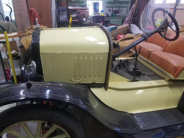

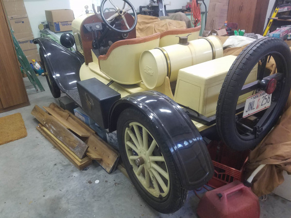

Newbie from NC, in my late, late 50's. Been a vintage Honda Motorcycle guy for a few years so I'm moderately metrically mechanical. I'm about to be thrust into the caretaker's role of my Aunt's 26 (I think) Speedster. My uncle passed in '08 so the last time it ran was before then. I would like to know what I need to do to get her started again. Will gladly answer any late '70s Goldwing questions in exchange.

It looks good! Unless the fuel system was completely drained, that is the most likely place for a problem. Old gas tends to set up like shellac and will plug the bottom of the tank, the fuel line and the carburetor. If you have a starter and a battery, you will need a new one. I would also recommend changing the oil and coolant and check oil level in rear axle and lube all grease cups, fittings, and oil all oilers. The engine will probably start right up if you have a good battery and get fuel, to the carburetor. You might want to put about a teaspoon of oil in each cylinder before you turn over the engine to oil the rings. It is possible that one or more valves could be stuck, but not necessarily so. Also air up all tires and pack front wheel bearings before you take it for a drive.

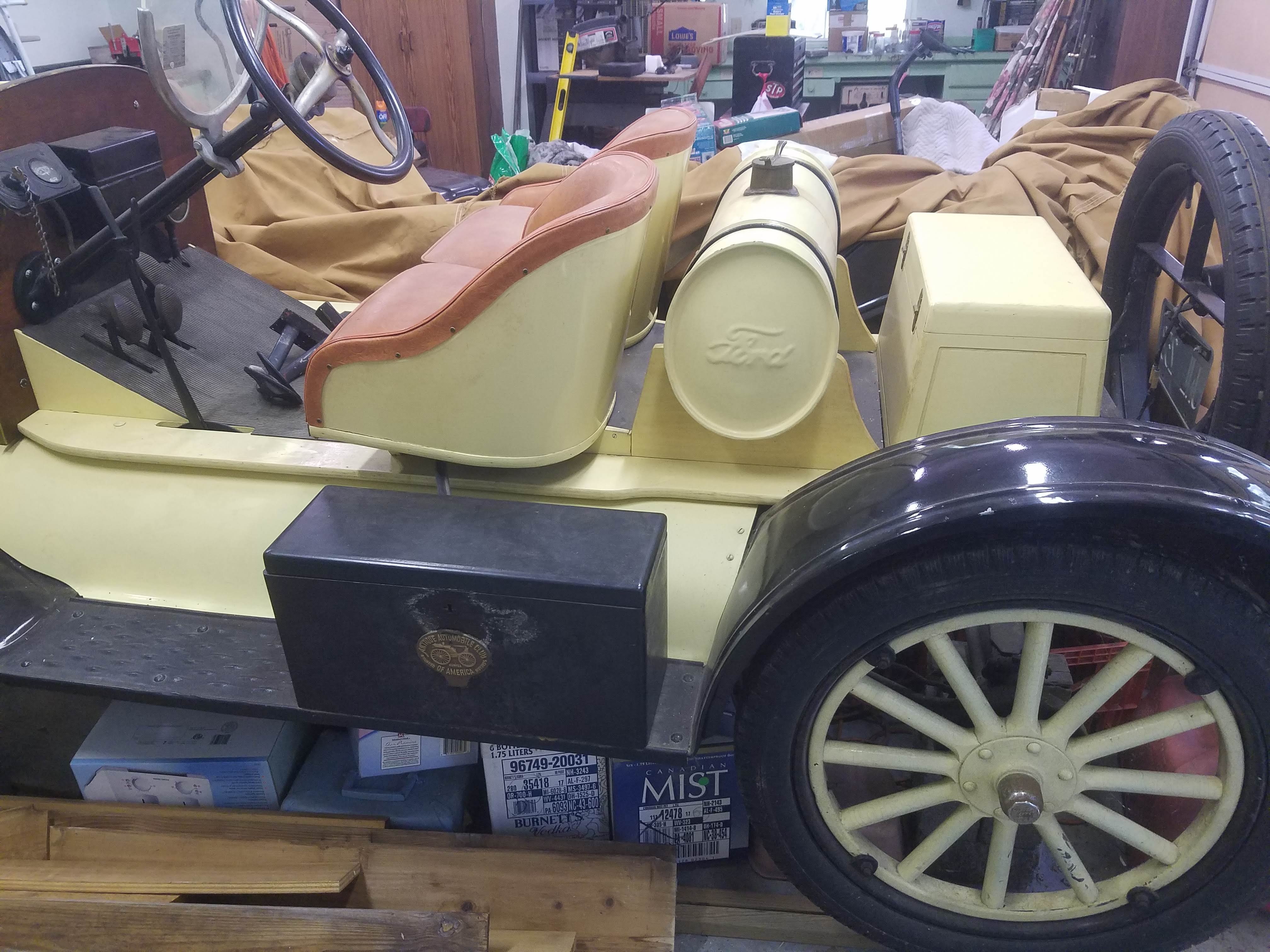

Fenders and pedals are wrong for a ‘26. It is earlier. Maybe ‘24 or ‘25. Look under the hood at the drivers side of the engine above the water inlet. You should see an 8 digit number. This number will tell you the year, month and day the engine was made by comparing it with the numbers in the encyclopedia section of the forum. If the engine is original to the car, that is the year of your T. Jim Patrick.

Your car is not stock. It is a "speedster". These were creations made aftermarket and many times have non-stock parts, and or parts from various year cars fitted together. So you can only tell by the engine number what year the engine was manufactrued, and even then, some previous owner might have ground off the original number and stamped in the registered number when the engine was changed. You can get an idea when the block was manufactured by the numbers molded into the metal.
