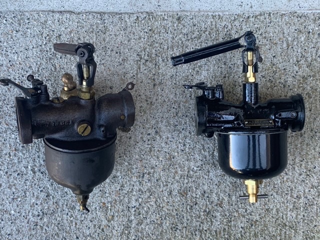

Post by Darin Hull » Wed Oct 14, 2020 1:01 am
I have been running a Kingston carb (L4?) on the 13T. Over the last year, I’ve read numerous threads about T carbs and decided I wanted to purchase a new model carb and keep the Kingston in reserve as a backup/spare. Though there’s always debate and disagreement... there seemed to be a consensus some carbs were simply better performers. Though a Strom OF had my attention, I decided to contact Russ Potter and order a Holley NH swayback.
This week I received the Holley NH from Russ and I give him my appreciation for his workmanship/knowledge. I installed the Holley NH today and was actually shocked at the difference in the 13T’s performance. I know the mind can play tricks and perceive a difference in something, like performance, when there is actually little difference. Well, bring out the stack of bibles... because it was an obvious difference and I’ll swear to it!
I followed this link to adjust the Holley NH carb after installation:
http://www.mtfca.com/encyclo/holley.pdf
The carb started up easier than I expected having not dialed in the adjustments yet. It had a smooth idle and it took little time to adjust it following the MTFCA instructions. The difference between the Kingston and the Holley NH was immediately apparent upon opening up the throttle. The carb’s impact on acceleration and its throttle response were outstanding.
I’ve read in past forums where Russ dynoed different carbs on the same T engine on the same day. I haven’t run across those findings. I have found some material about cfm ratings on various carbs and the debates as to what the results mean. I also understand the Kingston was only cleaned/serviced by me versus the Holley NH being newly rebuilt by an expert. However, through obviously anecdotal evidence... I’m a believer in the ol’ Holley NH!
Anyone have a link to Russ Potter’s dyno testing or some good articles on carb performance?
Darin

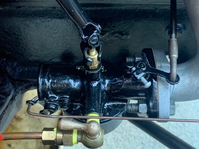

Post by Darin Hull » Wed Oct 14, 2020 1:06 am
I also don’t know what I don’t know... but always pursuing knowledge and learning. Please let me know if there’s any comments or concerns when looking at the pic of the installed carb setup.
Thank you,
Darin

Post by Its_Always_T_Time » Wed Oct 14, 2020 1:58 am
I guess you have no starter since there is no choke to the dashboard!
Cranking her up off of magneto I take it? :D

Post by Darin Hull » Wed Oct 14, 2020 4:44 am
The 13T has no starter and runs with a 25 engine right now. The original engine is in my garage waiting for some attention.
I crank start and run off a 6v battery as my magneto works but it results in a rough running engine. The mag will be a future project to work on.
Darin

Post by Original Smith » Wed Oct 14, 2020 11:15 am
I don't understand why you would want to use a 26-7 carburetor on a '13? Why not change the spray needle?

Post by Original Smith » Thu Oct 15, 2020 11:08 am
You can use the 25-27 NH carburetor on your '13! I do. Just change to the earlier spray needle and 6208 clamp nut. That way you can use your original carburetor adjusting rod.

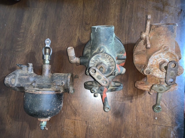

Post by Darin Hull » Sun Oct 25, 2020 7:38 pm
I just found three carbs in a box I didn’t even know I had. Potential future candidates for rebuilding.
Darin
