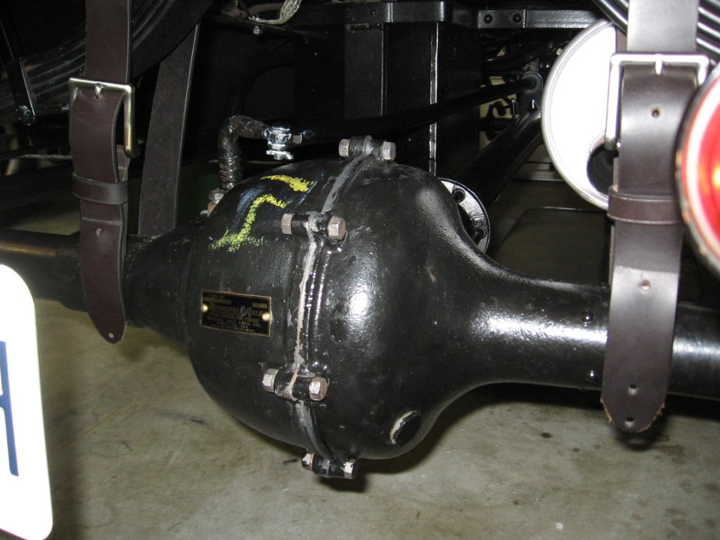

I'm back. I have a question for Cudaman. Why do you have those straps on the rear axle? Do they go around the spring or the chassis? I haven't seen anything like that before.
- Posts: 2542
- Last Name: Strange
- Location: Hillsboro, MO
- Board Member Since: 2013
Re: To Ruckstell or not to Ruckstell....that is the question
Those are rebound straps, they limit the amount of rebound from the springs over bumps. Reduces the "ejection seat" effect. They were a period accessory. I made mine from the beefiest leather belts that I could find at Walmart. They go over the frame. I have them on the front and rear, they actually help.

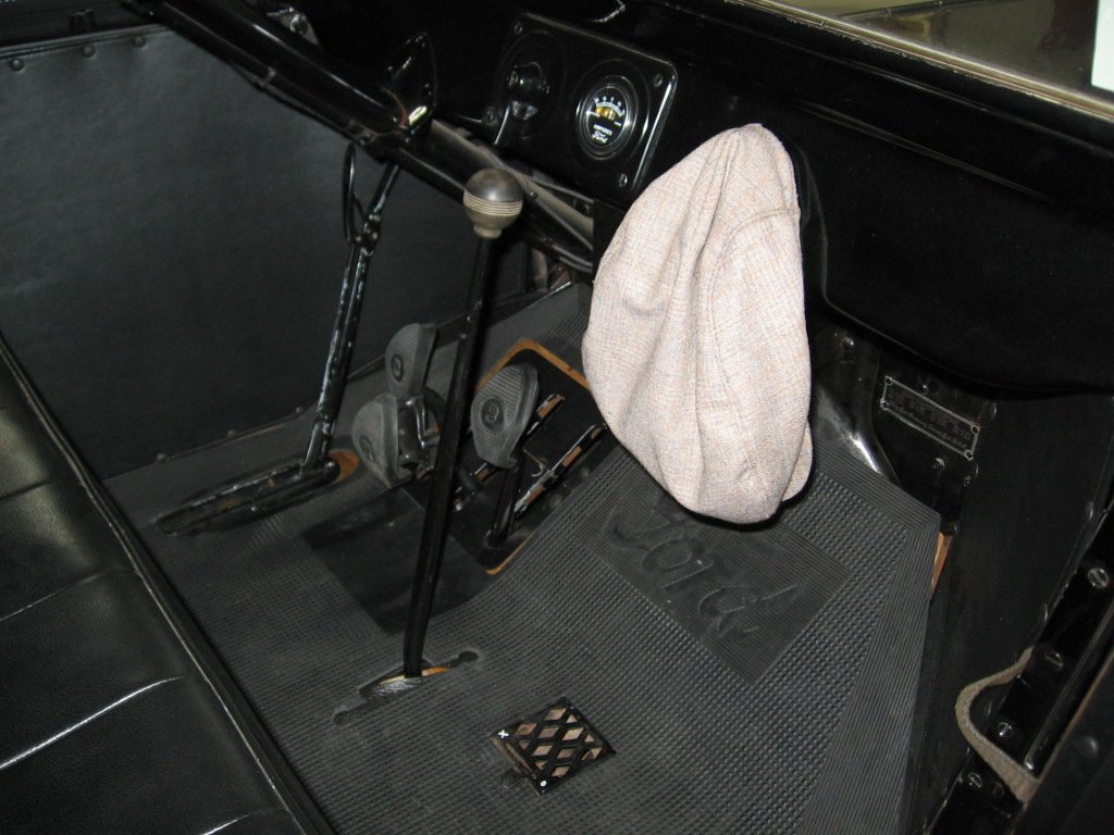

Low in the transmission is 2 3/4 to 1 and high is 1 to 1. That is quite a difference between ratios. There are plenty of hills too steep for high but not quite steep enough for low. That is where a ruckstell comes in handy. When you can't get up a hill in ford high simply downshift to ruckstell high and up you go about twice as fast as in Ford low. With a ruckstell you have four forward speeds. These are the speeds from lowest to highest.
1. Ruckstell low: Ruckstell shift lever back and pedal in low
2. Ford low: Ruckstell shift lever forward and pedal in low
3. Ruckstell high: Ruckstell shift lever back and pedal in high
4. Ford high: Ruckstell shift lever forward and pedal in high.
Basically a ruckstell gives you an additional 1.54 to 1 under drive when the shift lever is pulled back. With the lever forward the additional reduction gears do nothing and the car drives as if the ruckstell were not even there. If your car climbs the hills in high where you usually drive, you don't really need a ruckstell. If you tour or plan on driving in an area with larger hills, then a ruckstell is a great addition to your car.

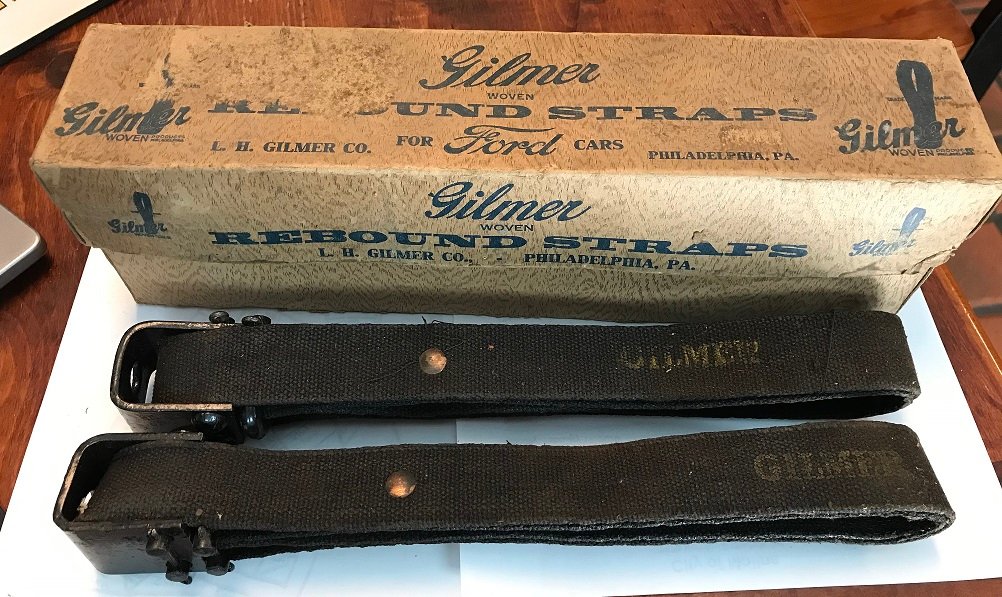

Period accessoryNorman Kling wrote: ↑Thu Oct 15, 2020 4:23 pmI'm back. I have a question for Cudaman. Why do you have those straps on the rear axle? Do they go around the spring or the chassis? I haven't seen anything like that before.

I would be concerned by two things;
1. The straps are very close to the center of the differential and risk bending the housing from a big bump.
2. The right one seems really close to the exhaust outlet.
I would like them if they were located as far out as possible!!
