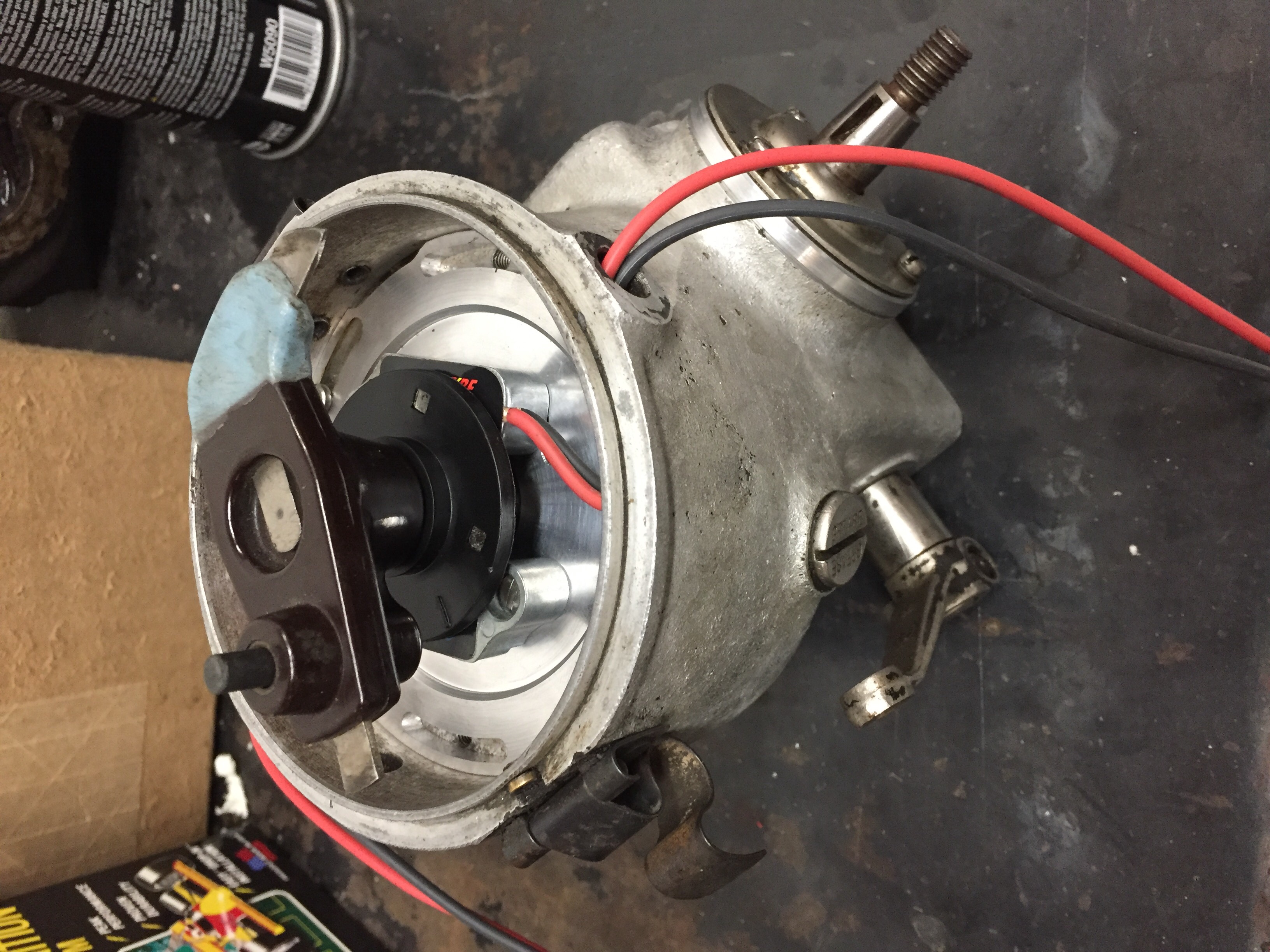

Here’s a pic of the Pierce arrow dizzy that I reworked a while ago. The original plan was to redesign the internals to incorporate the centrifugal advance mechanism from a VW 009... turns out that fixed timing was OK for the application, and the 009 centrifugals ran the other direction anyway...!
I used 2 009 dizzy electronic pickups triggered off the same magnet ring, and the pickups could be loaded into 1 of 3 locations to allow simultaneous firing, +3 degrees, or -3 degrees.

Kevin,
That looks good and thought out well. My concern would be operation with a caveman charging system.
If you use an alternator, 12 volts, and is regulated, it should work well.
What does that weigh?
Kevin Pharis
- Posts: 1642
- First Name: Kevin
- Last Name: Pharis
- Location: Sacramento CA
Re: Options for spark ignition for twin plug heads
There are 6 volt options out there too...
https://www.steinertractor.com/EIGN16?c ... gKwVvD_BwE
The Pierce Arrow dizzy is an aluminum base housing, and fits on any one of your favorite accessory mag drives too!
I’ve always felt that one of the coolest accessory combinations was a dizzy conversion in a mag drive!

This setup is a little more involved. I used Bosch dist. mounted on 1920's Dodge 90 degree dist housing. The rear dist has the trigger to fire a coil pack from a Buick V6.
Gary in MN
Gary in MN

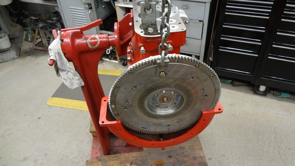

More info on that engine and transmission Gary? I'd love to see more photos as well.

1927 T block, A crank, A rods. Himico cast oil pan and starter housing . Billet flywheel, V8 pressure plate, aluminium adapter to mate the V8 transmission to the Himico. Gary

Nice looking engine Gary. Thank you for the pictures!!

Very cool Mr Anderson. What is the new build?
