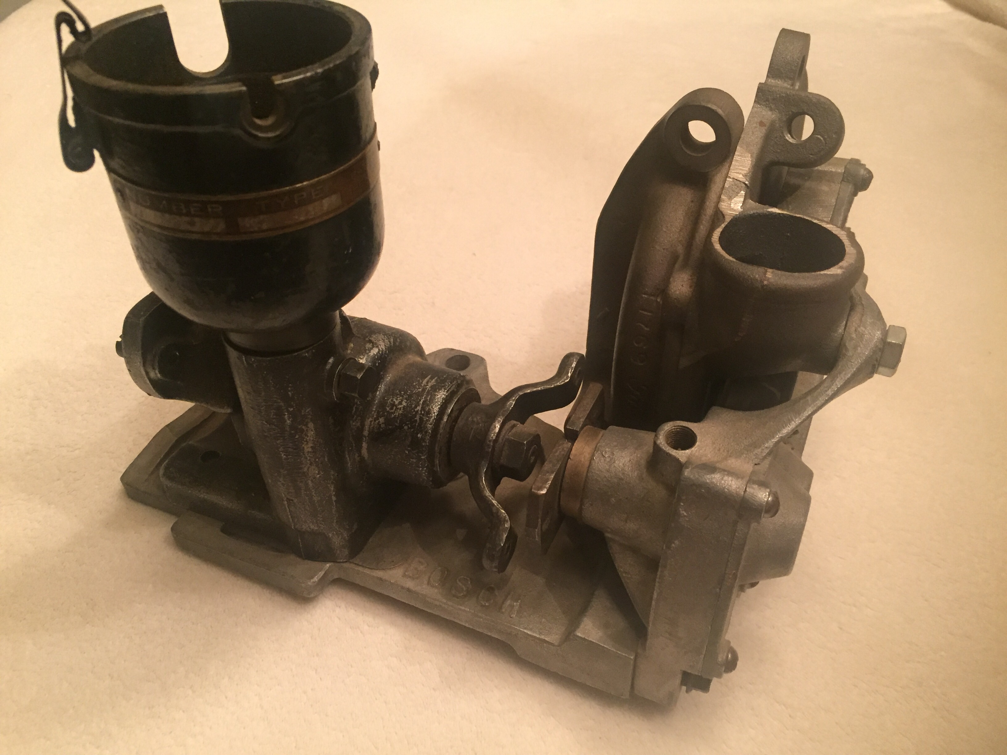

Bosch made a Two spark magneto.
Or, better yet, use a Bosch Two Spark Dual magneto.
With this, you can have two spark plugs per cylinder and have the option of
starting with either magneto or battery!

Yes, the Bosch ZR4 dual is the ticket BUT rare & pricey ! When I built up my BB RAJO racer, I searched for quite some time for one but at $1600.00 near 30 years ago, it wasn't in the budget !

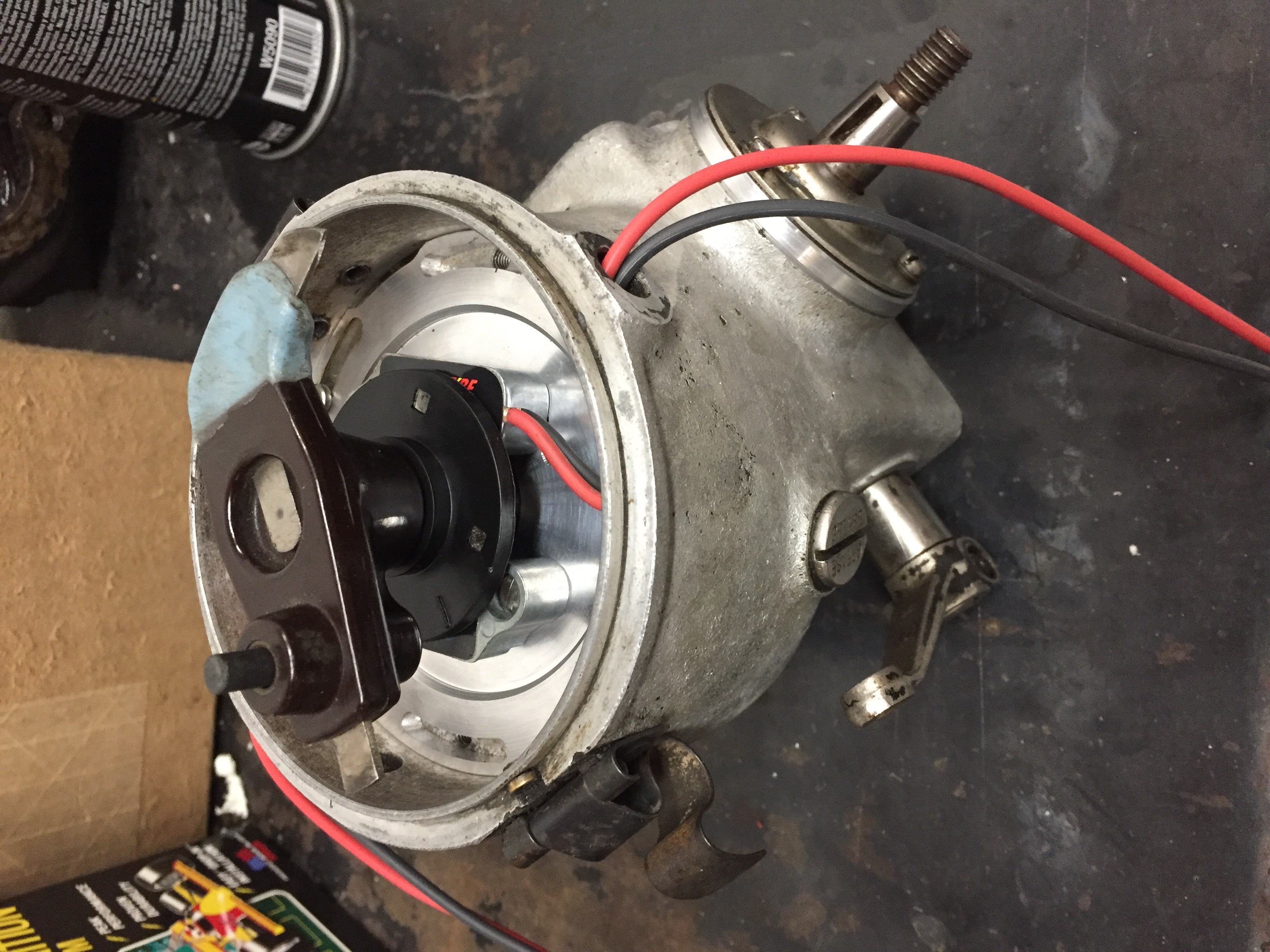

Here’s a pic of the Pierce arrow dizzy that I reworked a while ago. The original plan was to redesign the internals to incorporate the centrifugal advance mechanism from a VW 009... turns out that fixed timing was OK for the application, and the 009 centrifugals ran the other direction anyway...!
I used 2 009 dizzy electronic pickups triggered off the same magnet ring, and the pickups could be loaded into 1 of 3 locations to allow simultaneous firing, +3 degrees, or -3 degrees.

Kevin,
That looks good and thought out well. My concern would be operation with a caveman charging system.
If you use an alternator, 12 volts, and is regulated, it should work well.
What does that weigh?

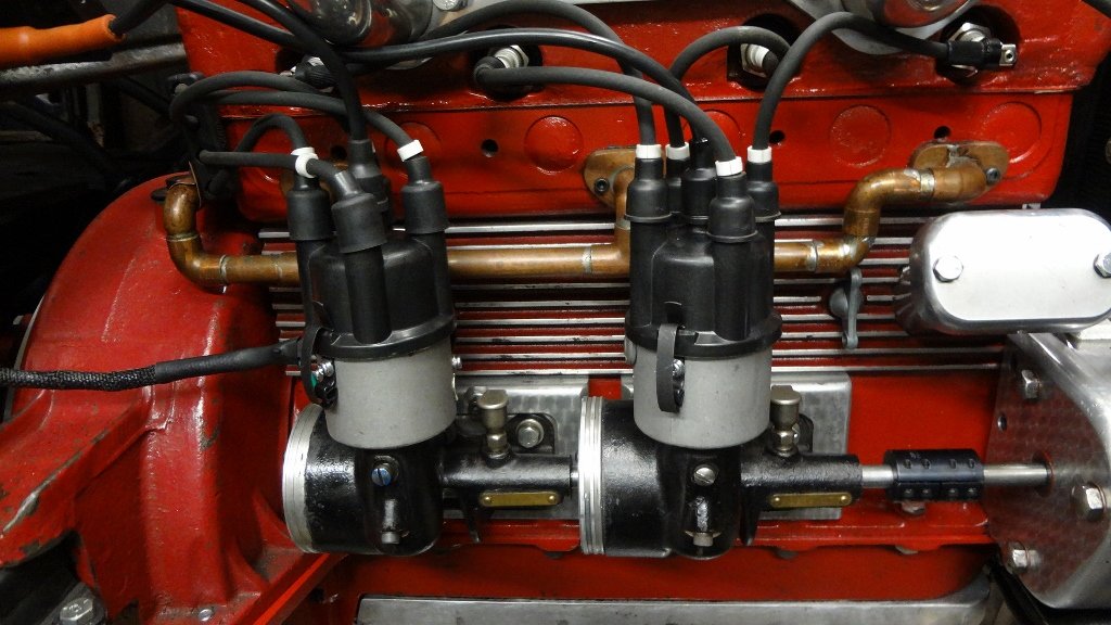

This setup is a little more involved. I used Bosch dist. mounted on 1920's Dodge 90 degree dist housing. The rear dist has the trigger to fire a coil pack from a Buick V6.
Gary in MN

Re: Options for spark ignition for twin plug heads
Post by Gary_in_MN » Sun Oct 18, 2020 1:23 pm
1927 T block, A crank, A rods. Himico cast oil pan and starter housing . Billet flywheel, V8 pressure plate, aluminium adapter to mate the V8 transmission to the Himico. Gary
