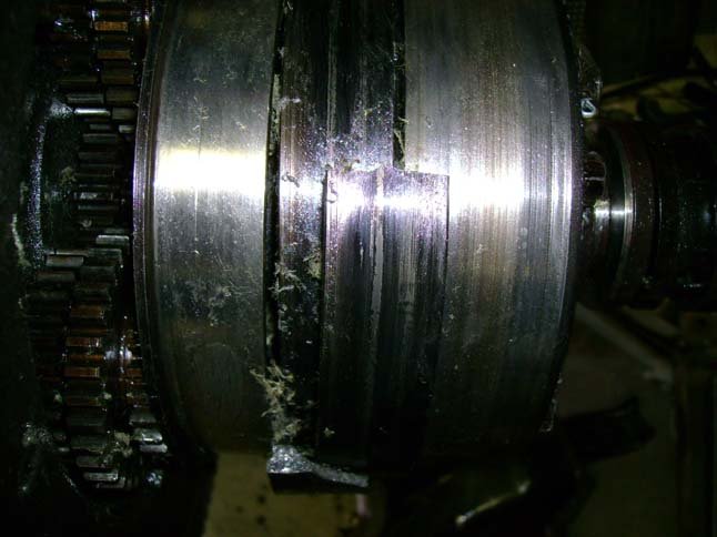

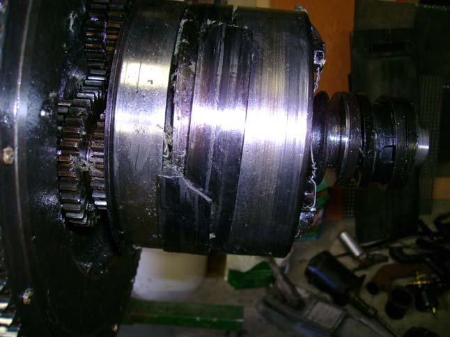

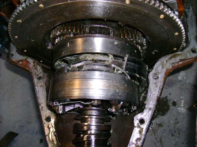

What Erik said, is especially true if the low cam and notch are worn out. In that case, the pedal does not move far enough to lock the low band unless it is so tight that the low band drags. When everything is adjusted right, you can pull the parking brake into neutral and push the car without the engine turning, and if you crank the car in neutral, it won't roll forward. I have had a car where the only place I could adjust the low band and have both a locking low with the pedal down and also a free neutral was to remove the floor board and adjust it so it locked the band after the pedal was before floor board level. This is especially true with new band linings. If you let the low band drag with kevlar brakes you can cause the drum to overheat and crack. Remember it will not only drag in neutral but also in high and reverse. So if the cam and notch are worn out, replace them. I will attach pictures to illustrate what happened to one of my cars. before I replaced the cam and notch.
