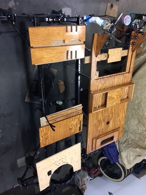

I'm ready ton install the Brass wooden body trim, 3/4" x 1/4" x 60" arround my 1914 fire wall. Any suggestion how to do the 90 degree corner? See bellow 2 pictures I took from internet. The third pictur, is my actual project so far. I would like to avoid cutting the brass at 45 degree if it is possible.

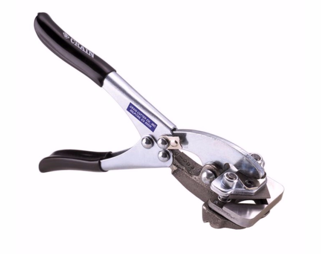

I notched a lot of Brass moldings when I was selling them way back when. I used a metal miter tool like this.
