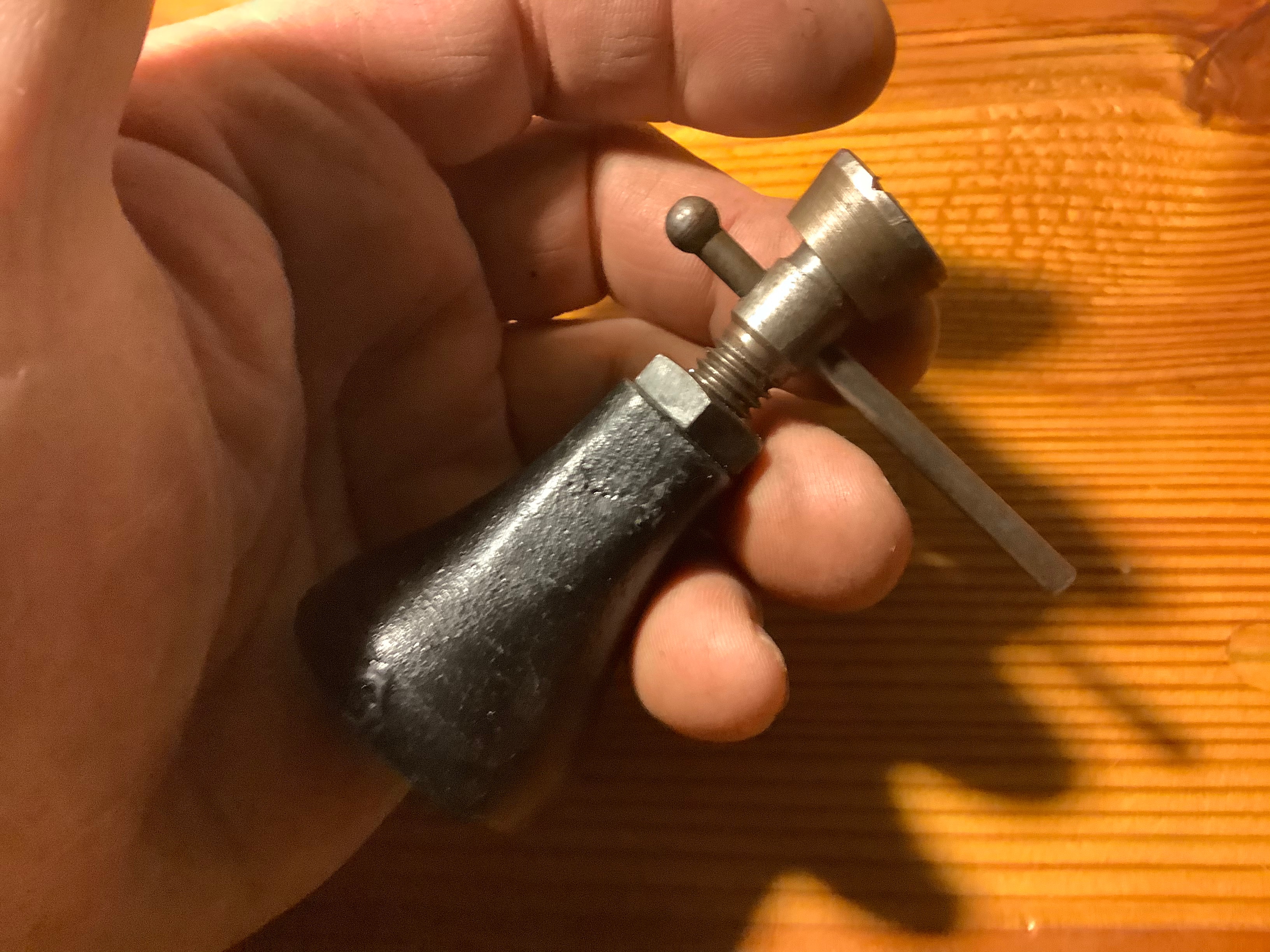

IMHO Do it once and do it right. Take some before pics, as different spots are riveted differently. By the time you are done you will be an expert at riveting. No matter how you cut it, it’s a nasty job, and only just a bit nastier doing it right, instead of cheating. A couple jacks like
these can be your good friend, or even a couple big bolts with nuts, to be your bucker.

I never riveted anything until I did my front cross member. I learned quickly and the overall experience was a very good one. I suggest you purchase several more rivets than you think you will need. Some will not set as they are supposed to. The small machinists jack (shown above) would have made my job MUCH easier. It would be well worth the money for you to purchase one of them. I used the rivet tool sold by the vendors - air powered type. Worked very well.

A rivet "jack" can be made very easily by using an "All Thread" coupling nut. They are much longer than a standard nut. Just check out what size and length bolt you need and drill/form the head of the bolt to what you need for a buck. Dave

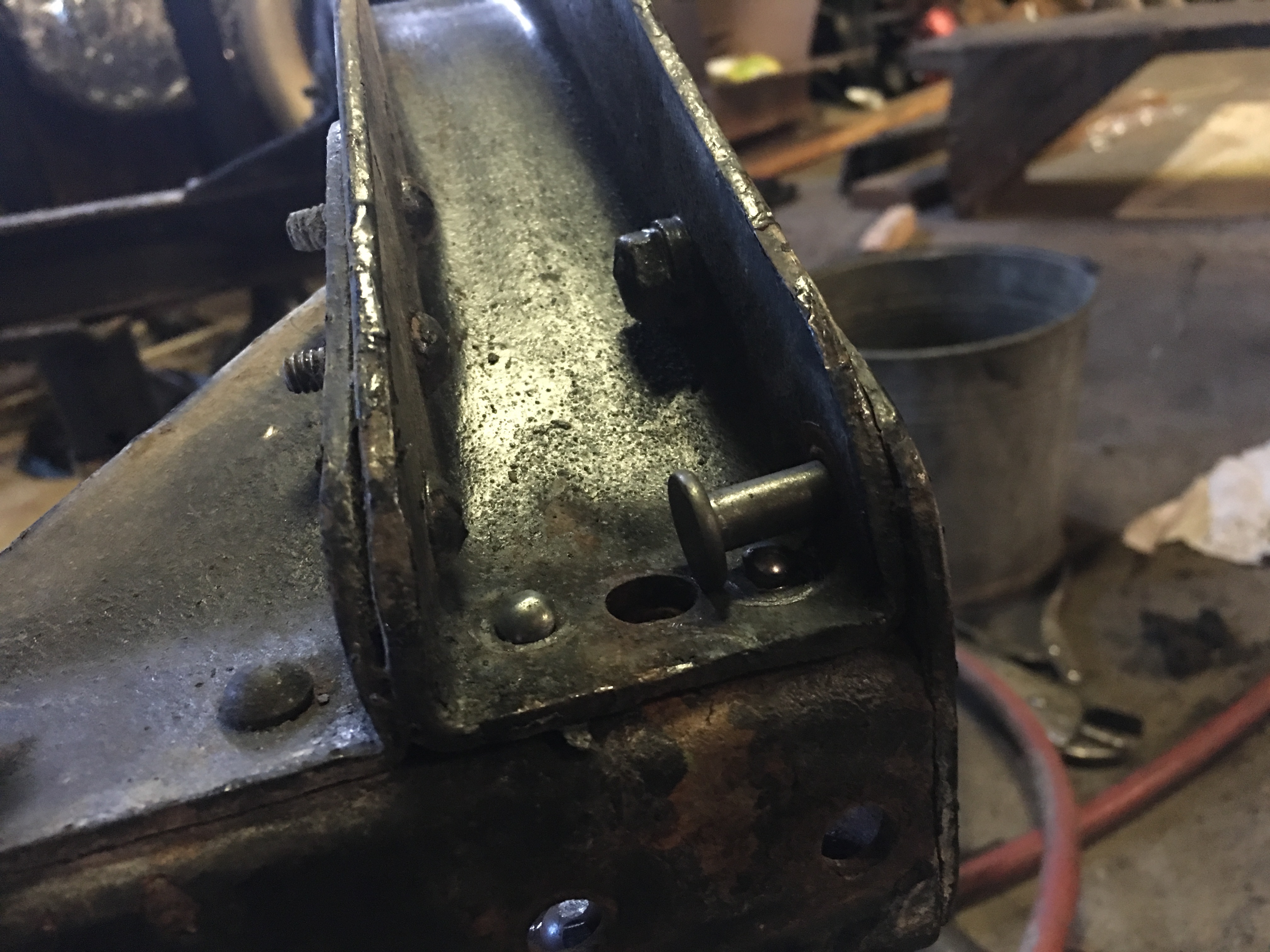

Looking at my previous post in the link above, I noticed something I didn't mention.
I attached the bracket to the cross member out of the car and installed them together. The bracket and the old cross member had been bolted in, so it was easy to unbolt them and do that part of the job on the bench.

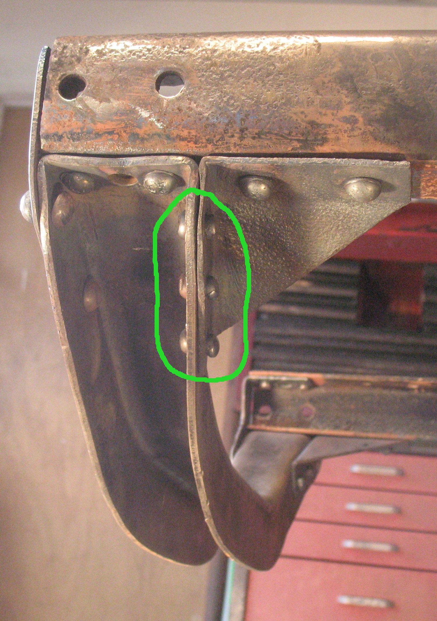

Be careful as to the order of installing the rivets on the front cross member
